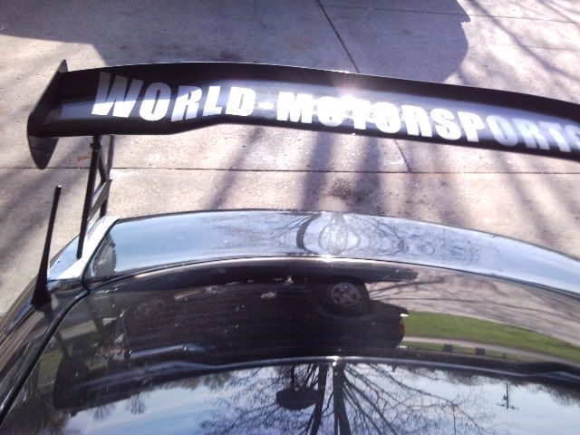

On the front straight at my local track, we use part of the Nascar oval. As you transition off the oval back into the road course, turn 1 is a long left sweeper. MANY guys break on the oval and enter the transition into turn one at a slower rate of speed. As I am coming off the oval, I am around 110-115mph on the stock hp (more power and you can see 120-160mph). I don't brake on the oval. This is only possible with Aero on the tC. My club members all have tCs and they can't brake or not brake where I can.
The other thing is Aero helps in the braking zone to slow you down as well as through the high speed sections. Where some may need to brake to setup for the turn, I can simply lift throttle and not need to brake. Carrying momentum into the chicane with stability due to the Aero. Talking with Chris Rado, I asked why he mounted the wing onto the outside edges of the trunk rather than the trunk itself. They were running a carbon hatch, and the downforce generated would break the hatch. Also, where the wing is mounted when they had it, and also where it's mounted presently on mine, it's going to send feedback more directly into the chassis rather than into the hatch. The hatch flexes and therefore does not transfer that energy immediately into the chassis. I've seen wings on track cars mounted directly to the trunk/hatch and you can see where the hatch has actually become damaged (bent) from the downforce being generated. I don't have that issue. At the same time, I can only open my hatch half-way without taking the wing off...LOL. The only other alternative to direct chassis feedback is to send the post of the wing through the body and actually attach it directly inside to the chassis. Now that's REAL direct.
I fabricated plates just like Rado had on their tC. I got slabs of aluminum from Home Depot and shaped them and Riveted them into the body.
This is what it looked like when it was on Rado's tC before they changed the body/wing setup.
"cough" "cough" those are 295 wide slicks mounted to 17x10 HRE 545's. That combination with the wide body has sustained 180+mph and 900whp.
