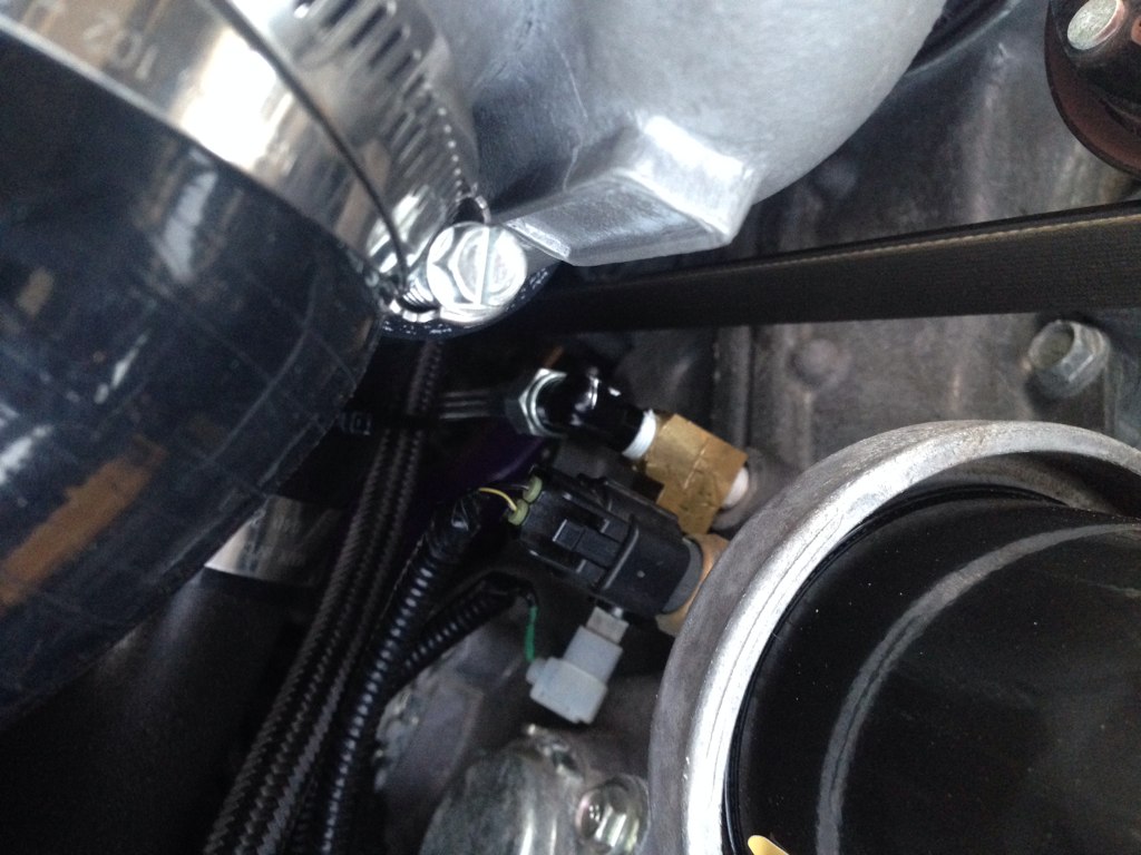

Has anyone had a leak at the oil pressure area? from the black 90 degree black piece that contacts to the stainless steel oil line?
Sent from somewhere
Is it leaking from the pipe thread side or AN? If the pipe thread side then you need to use high temp sealant. If it is from the AN (cone shape) then you need to tighten it more.
It's leaking from the black 90 degree angle/line threading.. Name:  ImageUploadedByTapatalk1406082416.209110.jpg
Size:  129.5 KB this piece

so its leaking out of the stainless end? If so, grab the 90 degree fitting with a wrench and tighten the hose end. It relies on compression to seal
Will do tomorrow morning. Thank you
