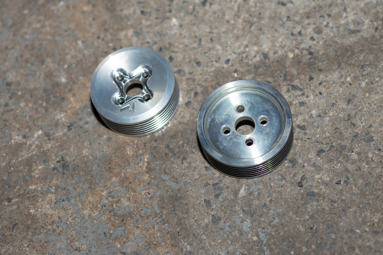

On E85? Holy hell it rips. Spent the better part of the last two days working on the pump gas tune and it looks good so far, should get it out to rest of our innovate people in the next week or so. Just waiting on confirmation from some of the folks to make sure the new tune is doing its job.
ETA on the pulleys is pending, we want to make sure these hold up good over time. 0 issues so far on the stock Innovate belt.

Let me know about the pulley's when they are available. I know Innovate is working on some but of course I have a few customers interested in getting a little more power soon from the 70mm pulley.
From what we tested the 70mm pulley should work with the belt in the 75mm kit. Just an FYI.
