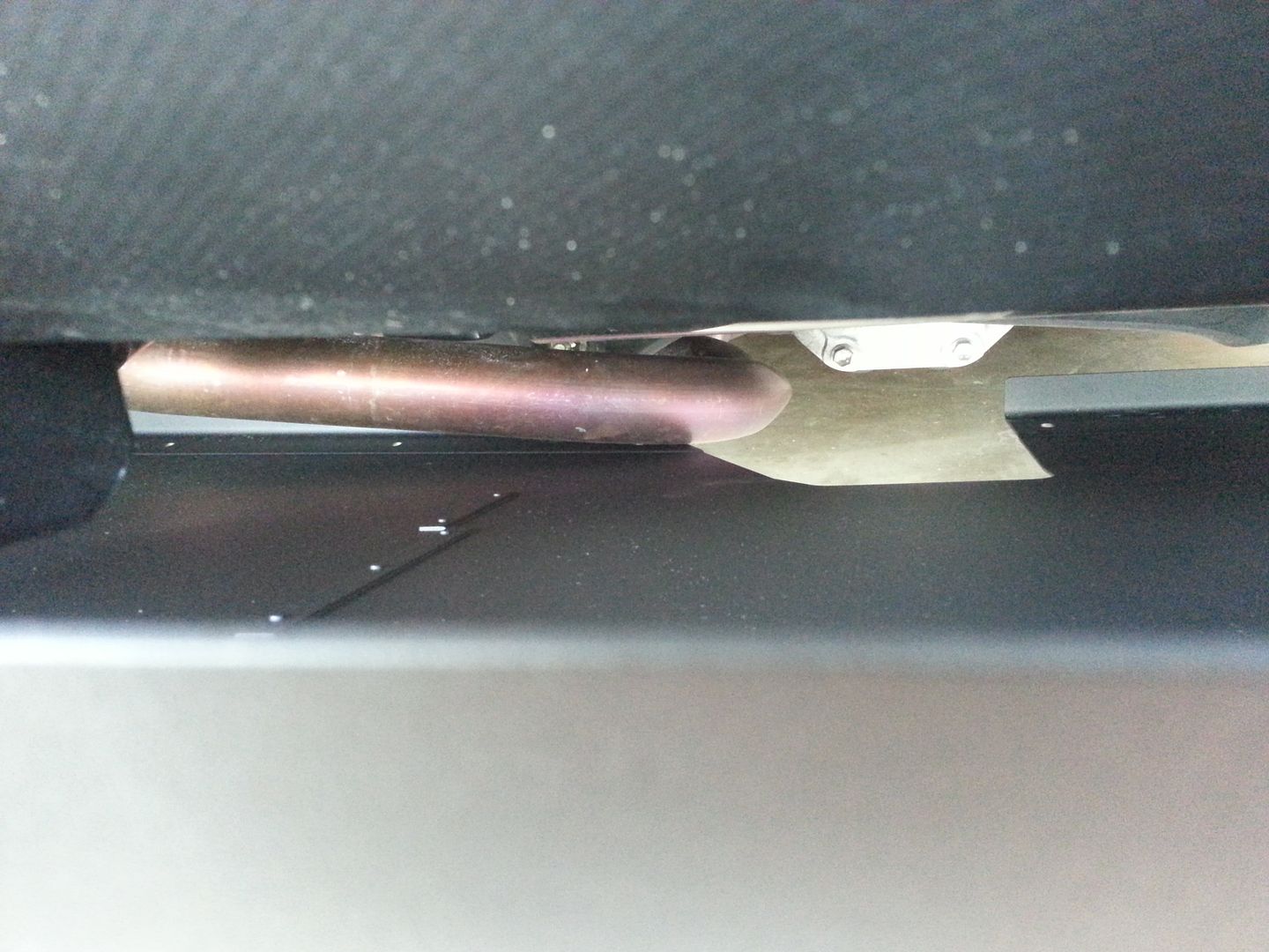

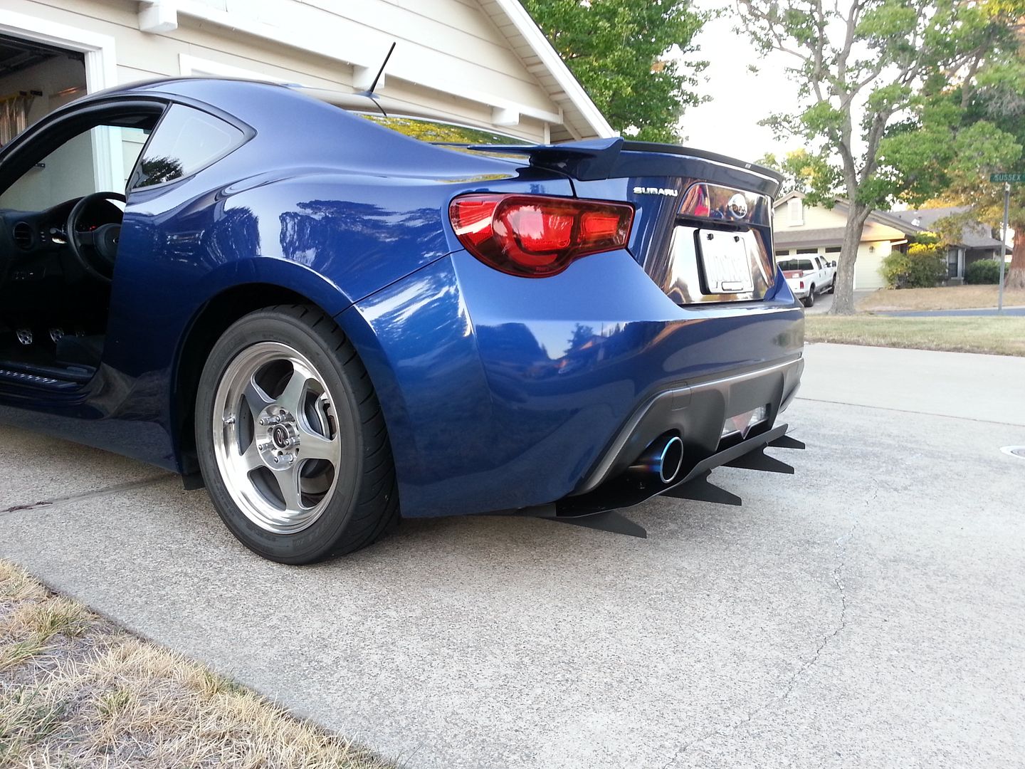

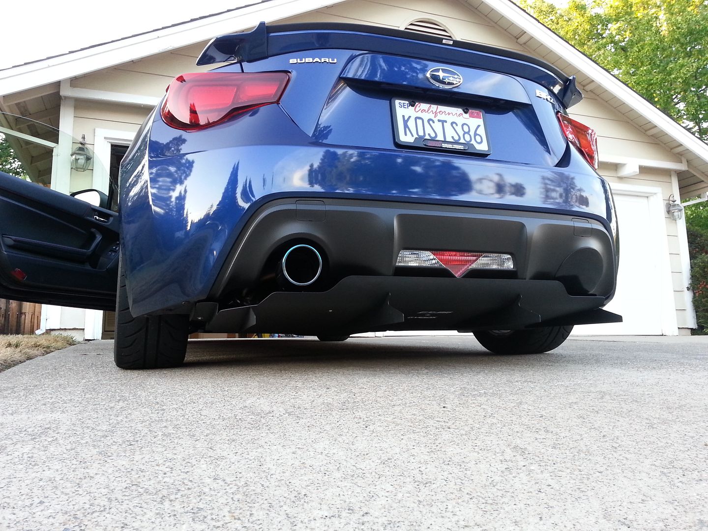

Originally Posted by NotEric6 View Post
Sorry to hear this. For those that decide they want to fix it themselves, the aluminum is very pliable. You can straighten it with wood blocks, some microfiber towels, and some pressure from your hands or a C-clamp.
My fin wasn't too bad, I was able to straighten it rather easily. I can see how it can get bent REALLY bad in shipping though with one wrong drop (Perhaps a FRAGILE sticker with an up arrow might help?)
My biggest problem however, is that this doesn't clear the stock midpipe at all... I'm more disappointed about this than anything else:
The cutout is obviously for center-pipe exhausts, I thought the stock midpipe would fit fine from looking at the list of exhausts but it just doesn't clear. I had to bend the heck out of it and I'll probably have to cut a good chunk out of it to get it to not rattle at any point
Other notes:
The plastic "bushings" should probably be replaced with something more sturdy or at least wider, giving the diffuser more support.
I'd recommend having more than just 6 mounting points, maybe 8 if you can find another two just for security.
Pics:
I like the design overall, the install was a little more difficult than expected but still not difficult. Overall I'm happy with the looks, not sure about the functionality yet (haven't driven it) and not keen on the install/fit on the car. I think it needs more work.

I have the diffuser installed on a completely stock exhausted car and it clears. It is very tight, but it clears and I have yet to get it to rub. Are you sure the front portion of the diffuser is installed as low as possible? Are the spacers installed on the rear 4 mounting points? See the photo from earlier in the thread:
Diffuser is as low as possible near the midpipe. I couldn't lower it any more where it mounts to the swaybar brackets. My muffler has plenty of clearance though, its just the midpipe thats in the way.
An alternate version with the hole setup for the stock midpipe location would work better IMO. That way I could still get better flowing air where the big gaping hole is currently.
I want to ask again, you used the spacers on all *4* rear mounting points correct? The outer two most mounting points look fairly close to the rear bumper but it could be the angle of the photo.
The photo I took of the midpipe hitting was actually when I just barely had the bolts on (with just a thread or two holding everything on the car). I tried with lots of bushings or no bushings and it didn't change the clearance at all because its so close to the mounting points with the swaybar brackets.
Maybe if I loosen the muffler to midpipe bolts and rotate it a little I might get some more room?
How many spacers are you using on each point? It's odd that mine fits and yours doesn't .
