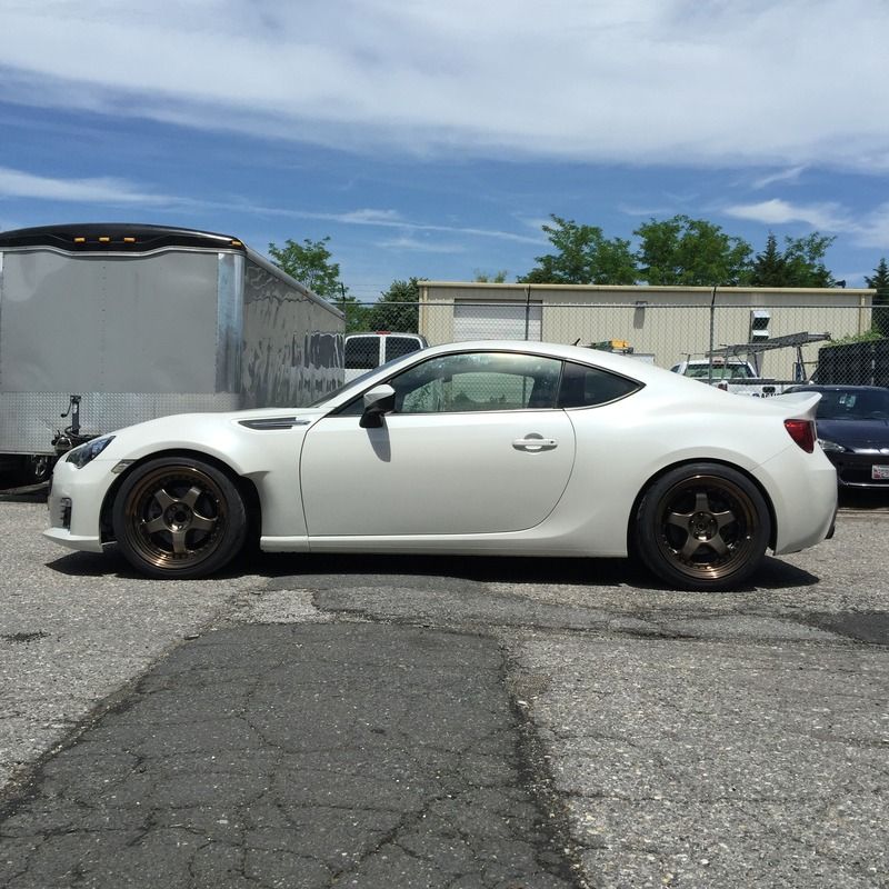

Originally Posted by TylerLieberman View Post
18x9.5 +40 Volk TE37SL
265/35R18 Dunlop DZ102 all around
-2.3 / -1.6 camber (f/r)
7,7,5,5mm Parts Shop Max Spacers (24mm total) front
3mm Part Shop Max Spacers rear
Final wheel spec: 18x9.5 +16 (front) / 18x9.5 +37 (rear)
Car rubbed a little bit all around under hard cornering. Also was damn near impossible to run the corner lights at this height with this wheel setup. If I did it again, I'd get LCAs up front to widen the track and go up to about -3 camber. More inward clearance, and I would be able to ditch the spacers.
Another pic to show how dead on the fitment was up front.

Originally Posted by Calbee View Post
Very informative post.
I am planning on getting 18x10 +38 Meisters with O disk in the front. Was wondering what spacers I would need to get similar fitment. I am planning on running a 265/35/18 tire. My other concern is that I want to be able to fit STi brembos in the future, but do not want to go with the A/R/T disks options. I figure with the amount of spacers I would have, it would be enough to clear the brakes?
18x10 +38 will be 15.7mm sunk in compared to my setup, so you would need a 15mm spacer to basically have the same thing.
Keep in mind I also rubbed a little bit under compression when going around corners at higher speeds.

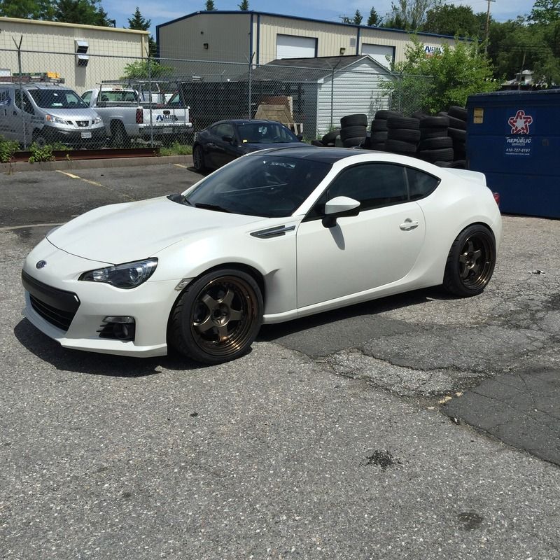

Originally Posted by nima314 View Post
Also, you said yours poke out a bit, but the front looks pretty perfect, did you mean the bottom pokes out because of the camber?
The Todoroki fenders are a bit weird. Look at the picture of my car from the front. It looks like there's a bit of clearance under the front fenders. Then look at it from the rear. The front wheels look like they're dead on flush, maybe poking a couple mm's. The Todoroki's have this curve in them, that can alter the appearance of the wheel fitment, depending on where you look at it from. It was pretty much 100% flush with the fender, MAYBE poking a mm or two, but that's it.
