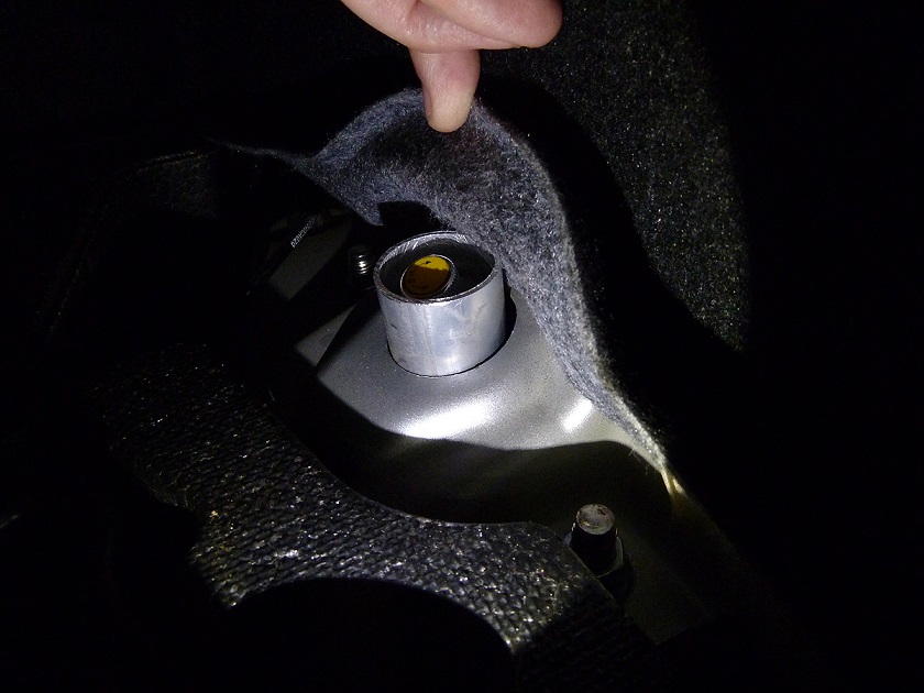

I thought I would have a play around with my dampers today. Much to my dismay I found that one of the rear adjusters had been bent off axis. No doubt it was the trolley jack on my way to the local track. Luckily for me the adjuster is still working. I purchased some 32mm diameter 1.6mm thick aluminium tubing to make a bit of protection. It is 40mm high. The tubing sits in there quite nicely.
These are not Tein Mono Sport but you get the idea.
This is not an issue for TEIN suspension.
