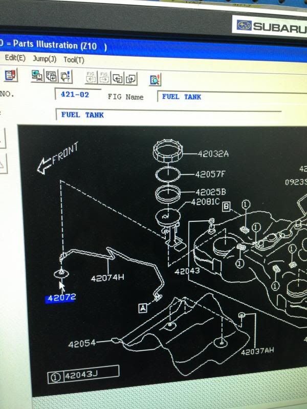

Buddy just sent this over to me of the fuel diagram.
He said the filter is part of the pump, but maybe @robispec can confirm this or not since he has already replaced this part i'm assuming.

@robispec, I see that you had to ramp up DI load to compensate for both E85 and FI. Is it safe to assume that if one was running 92 or 100 octane E0 or E10, which doesn't require as rich of an AFR, that the DI load would be less and comfortably below its limit?
