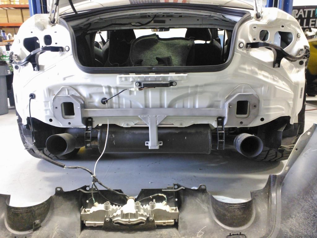

Very clever, does this space the bumper out tho or is completely transparent once everything is back together?
It's completely transparent. The crash beam actually sits a few inches inboard of the bumper and does not support the bumper at all.

Wow that came out great. No holes in the bumper at all? Very clean. I wonder if it will fit both the frs and the brz.
Very slight trimming on the inner side of the crash beam flange (not structural) and no modifications to the bumper, exhaust, etc. Completely reversible. There is no difference between the frs and brz at the rear of the car.

You know you could just sell a kit with loose parts that are not welded together. I believe that would release you of all liability and if you sold it with the statement that this is not for street use that may also release you as well. At the very least you might be willing to share the dimensions and sizes along with any cad you may have. Thanks
Not a bad idea. Would anyone be interested in something like that?
