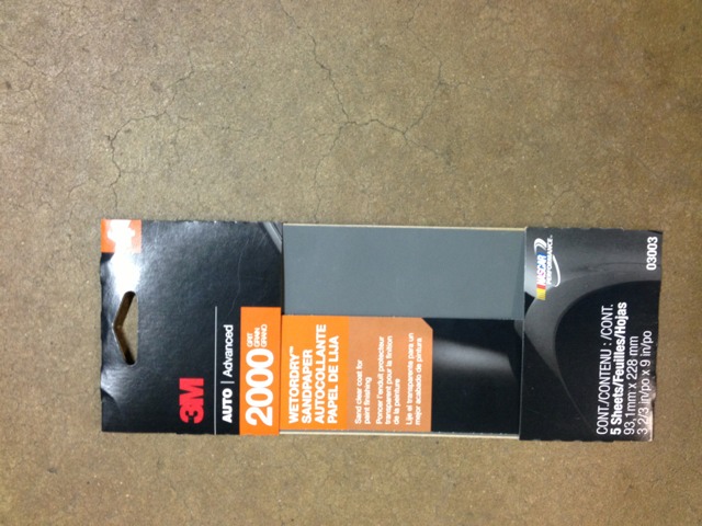

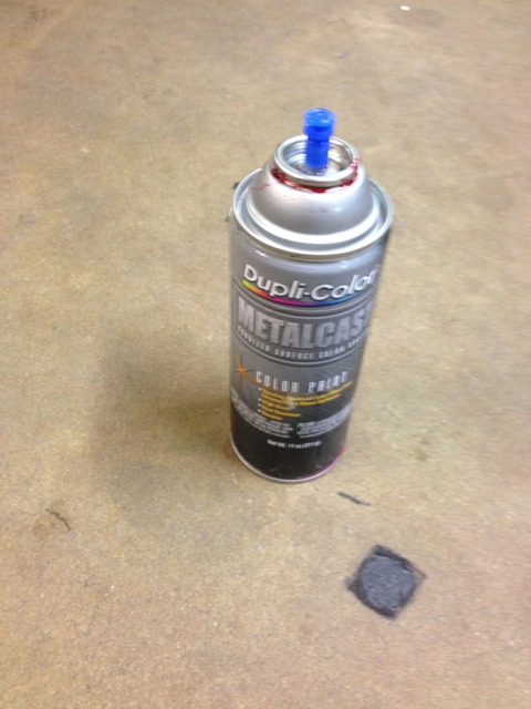

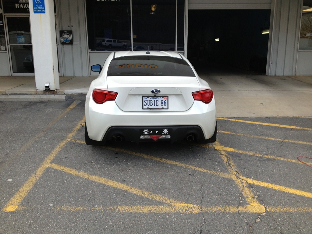

Painted mine today, used duplicolor metalcast and the clear coat from automotivetouchup.com. Did three light coats of the metalcast, followed by wet sanding with 2000 grit, then two coats of the clear. In a few days I will cut and buff it but it came out great so far. Very happy with the results.
Supplies:

Results:
