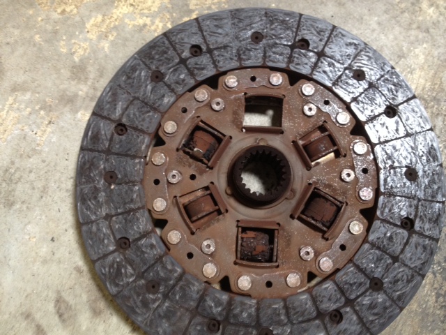

You may be over thinking your one time clutch burn accident. If you do it all the time thats bad but if it's just a few times in the lifetime of that clutch, you should be fine. Sounds broken in now.
We just did the fifth gear test recently in my husbands tc. in a safe empty lot with no one to get hurt around you, put it in gear (higest gear you have) and take off from a stop in that gear. It's supposed to stall. If it doesn't stall and you can move it's the clutch.
His car didn't stall, it acted as though we were taking off in second. We just had the clutch replaced and this is what it looked like.
this clutch had 110,000 miles on it. so even if you think you did a little something to it...it will still last a long time
Attachment 35121
This helped me a lot too, i remember a bad experience i had smelling the clutch. Feel better and understand a lot more
