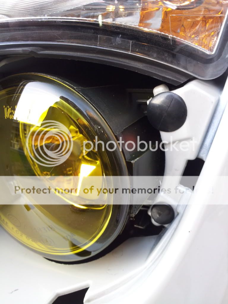

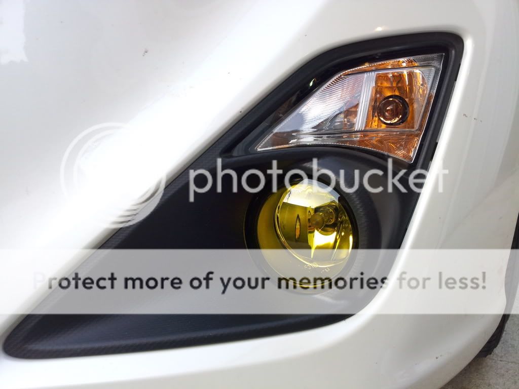

FYI: panel push plugs works well without having to use nuts and bolts. just push it in and youre done. they stay in snug and will do just fine for this modification.
so how did you get your fog lights tinted yellow?

Buy yellow tint online... It's like $8. Easy to install on small parts. Mine are tinted yellow

sorry for the late reply. theyre sprayed.
