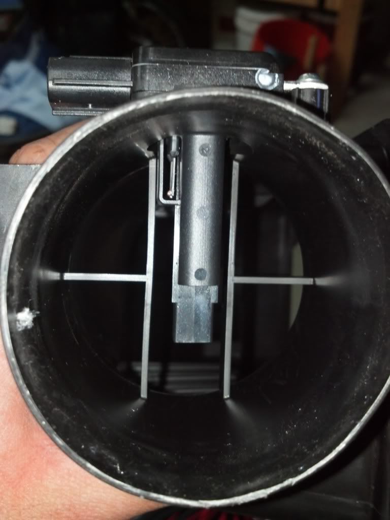

I still can't believe there are no Air Straighteners here. Especially near the MAF like the factory box. Seems like they cut some corners and rushed this box into production.
The TRD tube comes right off the CAI and has a straight path to the throttle body with no resonators creating pulses and no curved tubes.
The stock box has no curves before the MAF either. The straighteners were used to help the MAF reading. Anything after the MAF is irrelevant unless its super restrictive.
