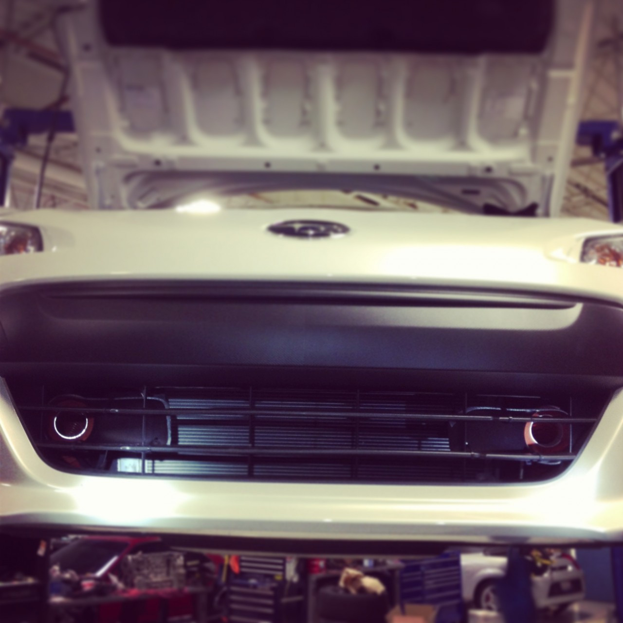

We prepped a local customer's BRZ with our kit prior to him going out to Carolina Motosports Park last weekend.
Here is how it looks. The angle of the duct was slightly different, other then that everything else was same as the FRS.
We'll get those out to you this week.

The reason why we're not offering a kit that would utilize the fog light location is because there is no way you can route a hose from that location to the brakes without removing the windshield washer tank completely.
Even you if you did relocate it, the hose would be have to be routed right back up toward the front of the bumper then back again toward the brakes.
The ducts are well hidden. I bet once these are on "Melanie" most people would walk right past the car and not even notice the ducts.
Another reason we would rather not use the fog light location is so that we are not creating unnecessary aerodynamic drag by creating more opening on the front of the bumper.
