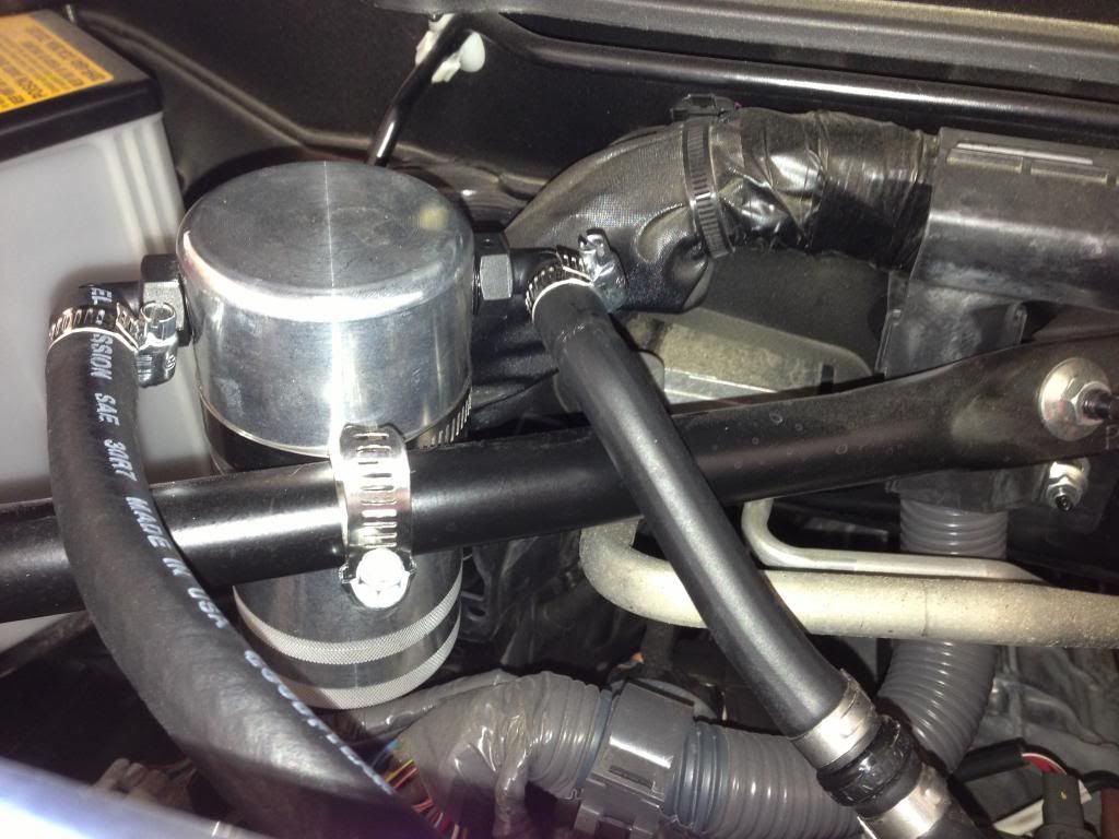

So, I just got the catch can installed. I did mount it to the bracket where there used to be some kind of wire clip for the sound tube. The supplied hoses are good length, but too small to fit over the factory intake manifold connection. So what I had to do was cut the factory hose and use and adapter to connect the factory hose and the kit supplied hose. It looks good. No CELs. Car started right up.

Sorry for the big pictures.

They are big! Glad you got it installed. If you ever need help on an order you know how to reach me.
