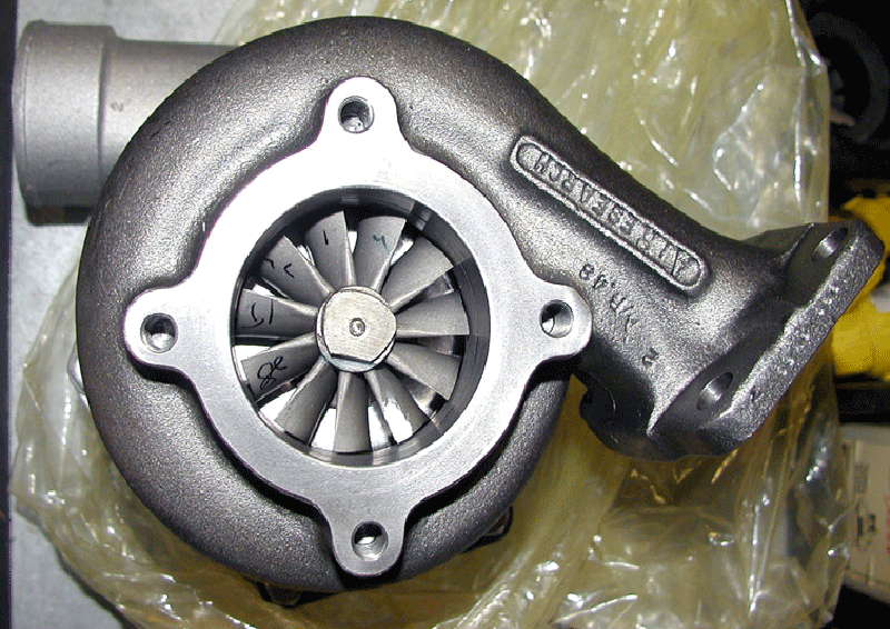

Turbo doesn't act like a resonator.
It quiets an exhaust down the same way this does:
see the similarity?
The principles are the same. Sound waves cannot just exit out freely from the exhaust ports. They hit something in the exhaust path. Whether it be a butterfly valve or a turbo turbine blade wheel.. same principle. The material absorbs the some of the sound energy and bounces it back even.
