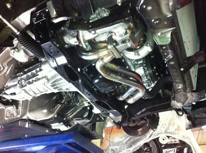

Turbocharger placement
Attachment 11801

The turbo sits about 2 inches above the undertray/skidplate. It reinstalls in the car. The turbo does not get in the way.
