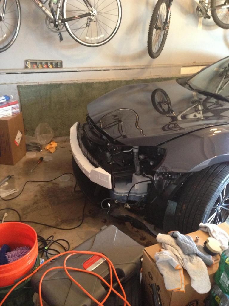

cars apart.

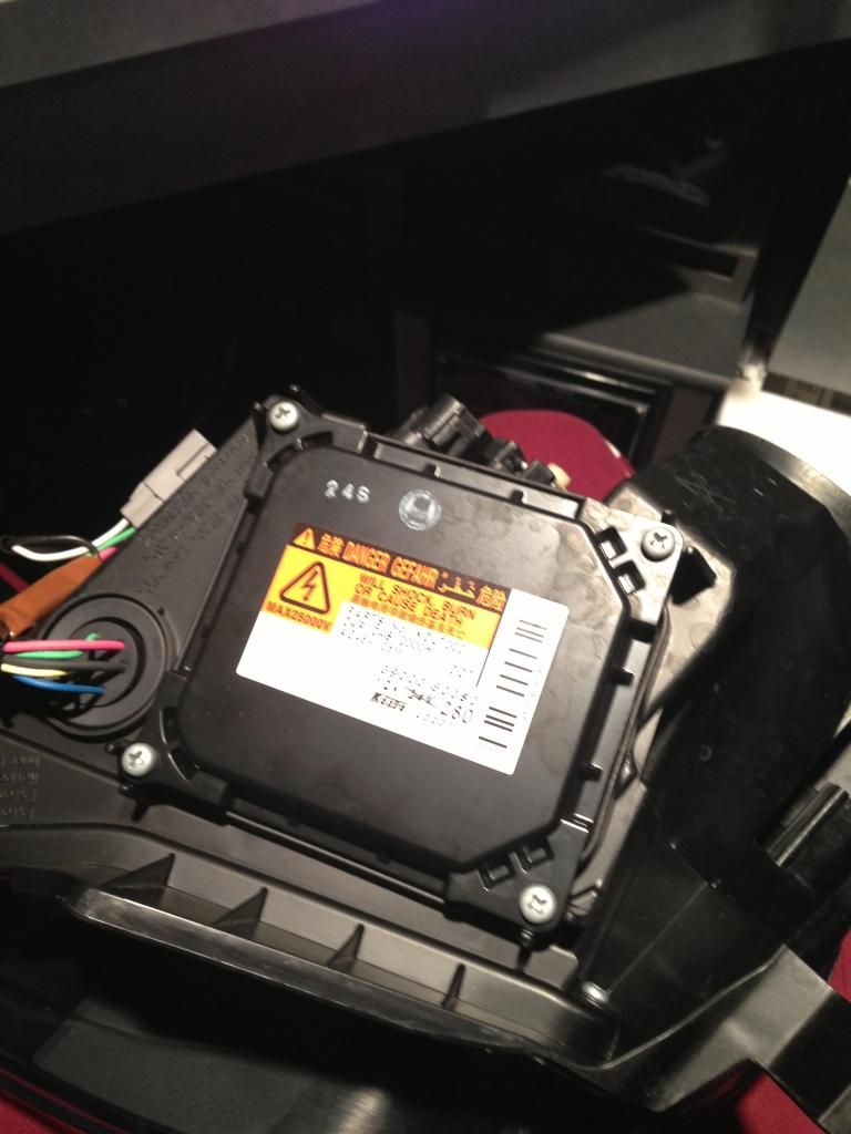

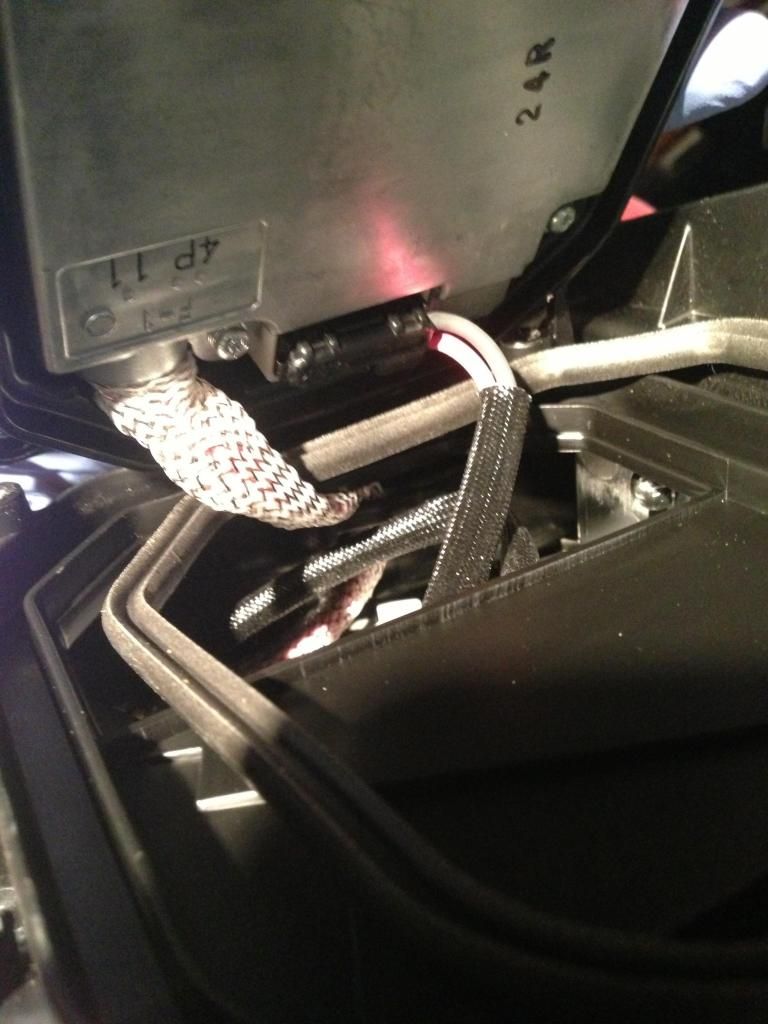

first pull out your HID bulbs

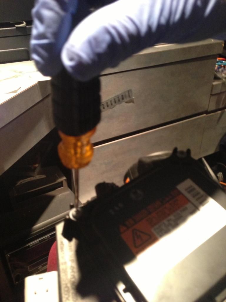

then you can take out all your wiring and your ballast some people say this has to be done some say it does not before putting your headlights in the oven.

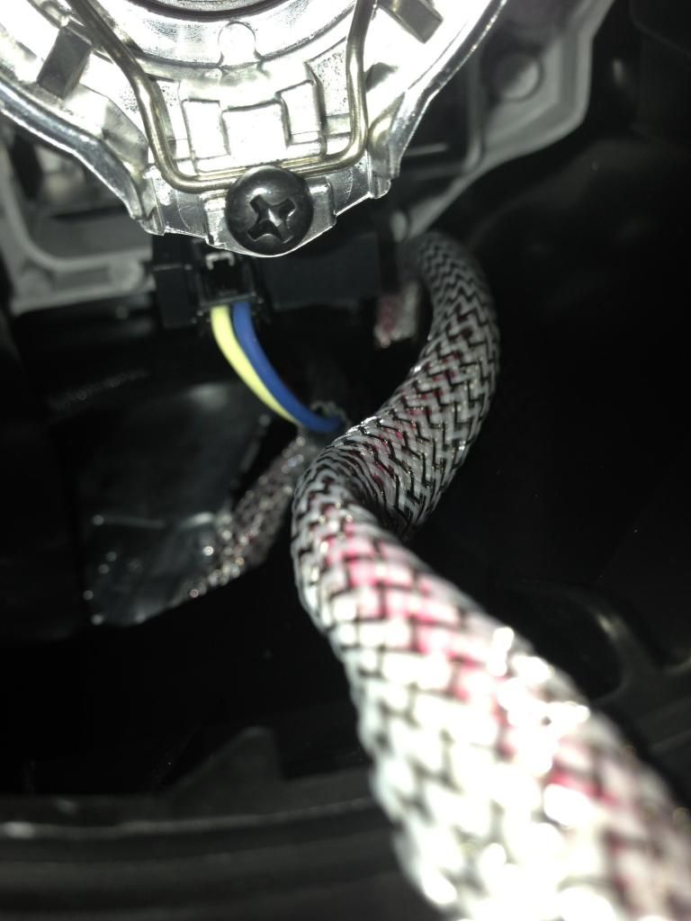

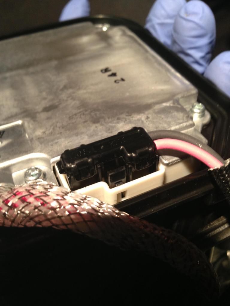

you see there is a rubber gasket there to keep moisture out and there is a hook inside the actual light holding the wires in place.
unplug your ballast and your good to put them in the oven

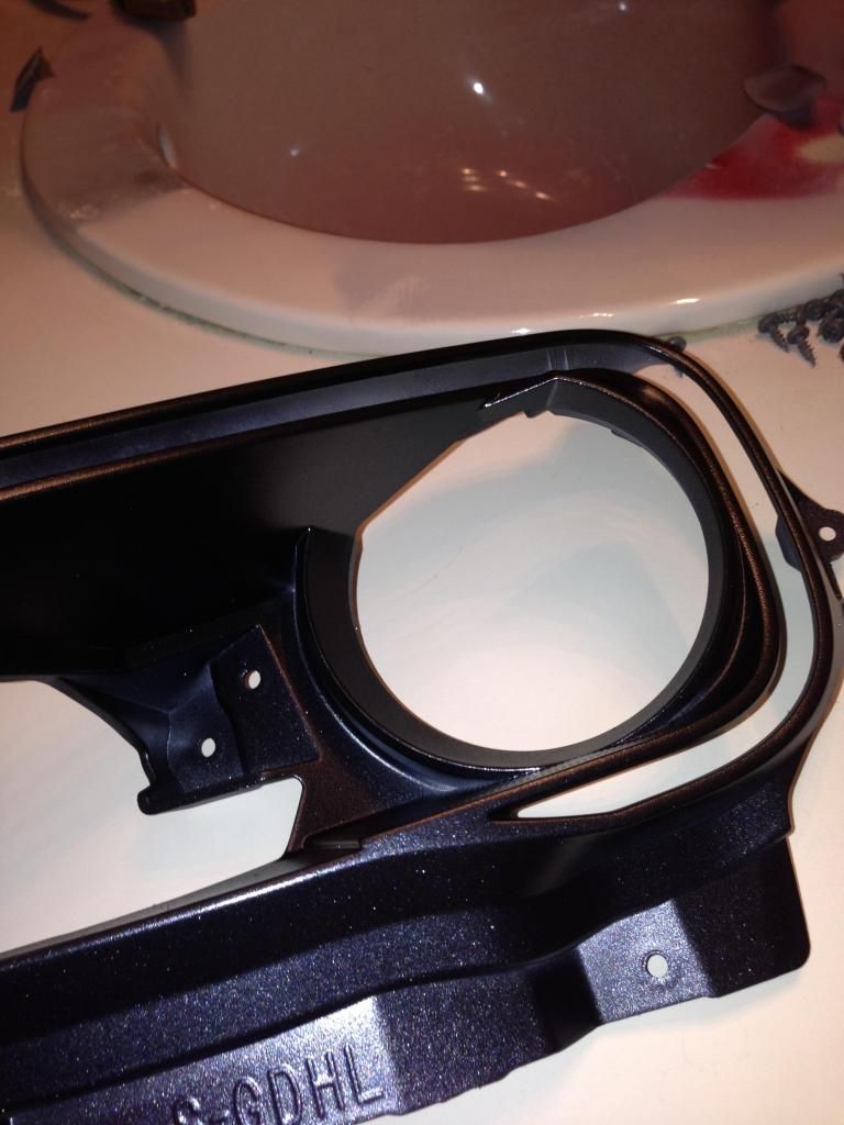

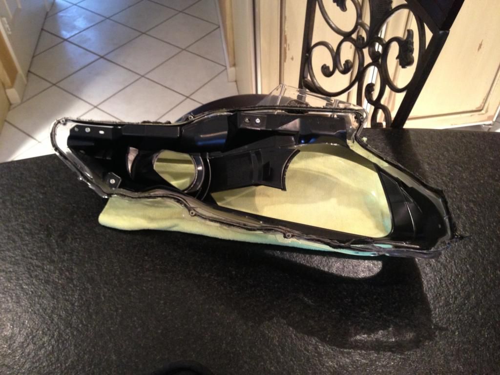

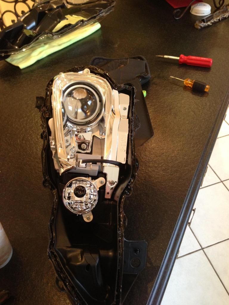

everything pulled apart

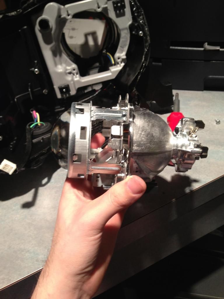

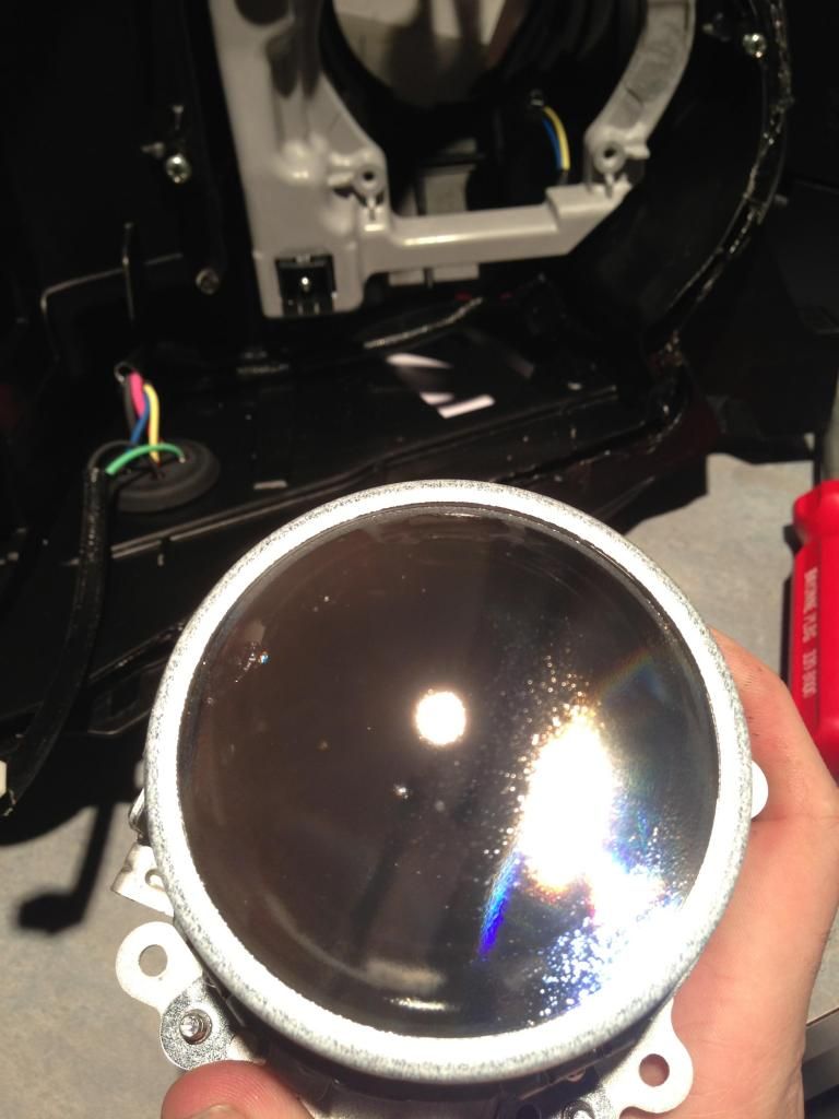

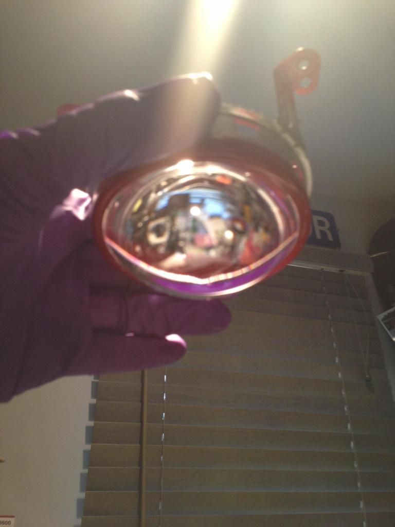

The BRZ comes stock with the Lexus RX350-Bx projector after some research i have found out that the projector is one of the best on the market. BUT it comes with a "fresnel" lens which looks like this
and a clear lens looks like this
you can do a lot of reading on clear lenses at the retrofit source. When swaping your lens out you can either have your oem ones polished or use a STI-R lens with slight modification. i chose to send mine out to have them polished.

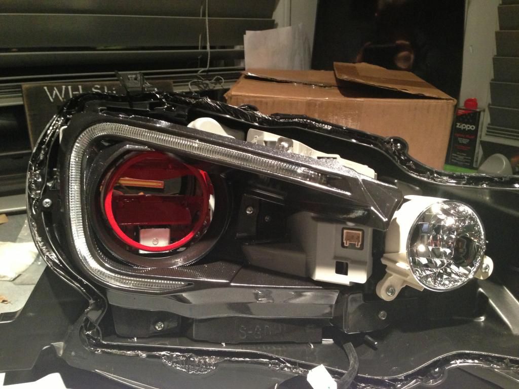

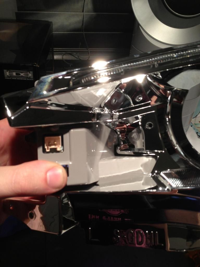

For those wondering which wires control the LED "boomerange"its the green/black coming out of the back of the headlights.

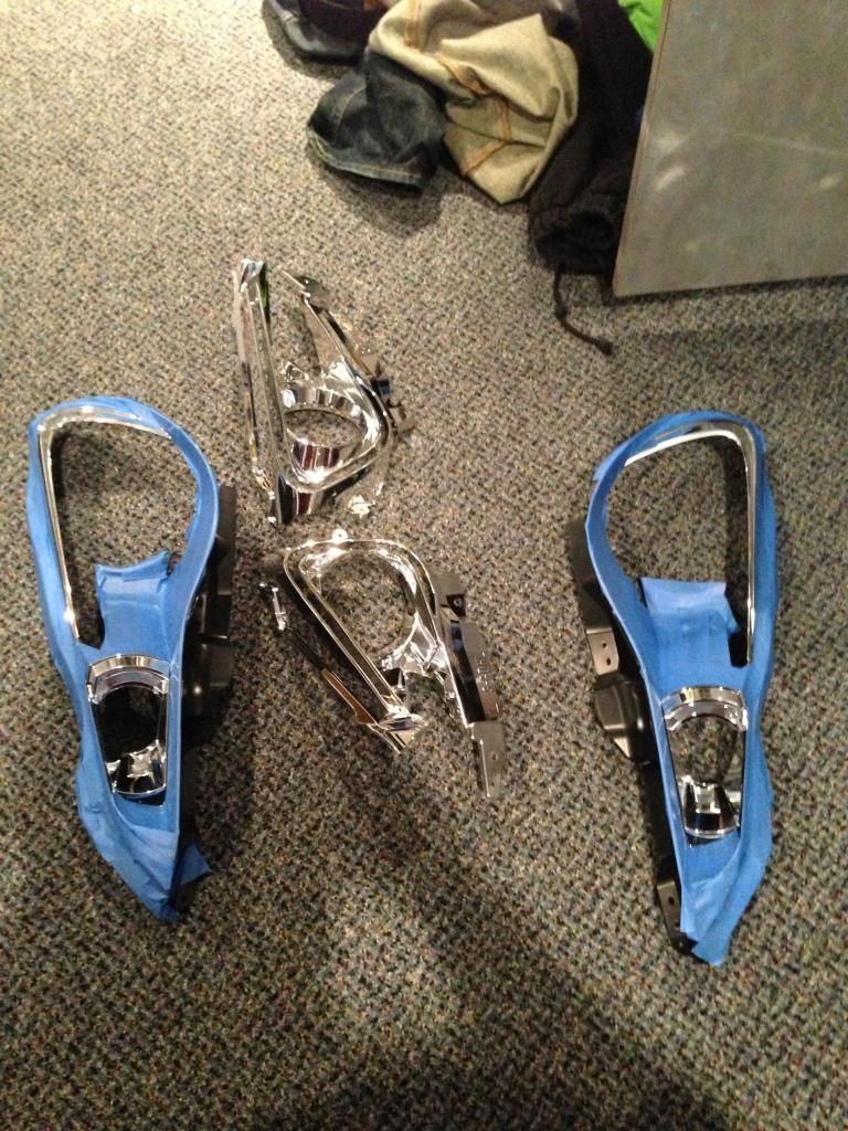

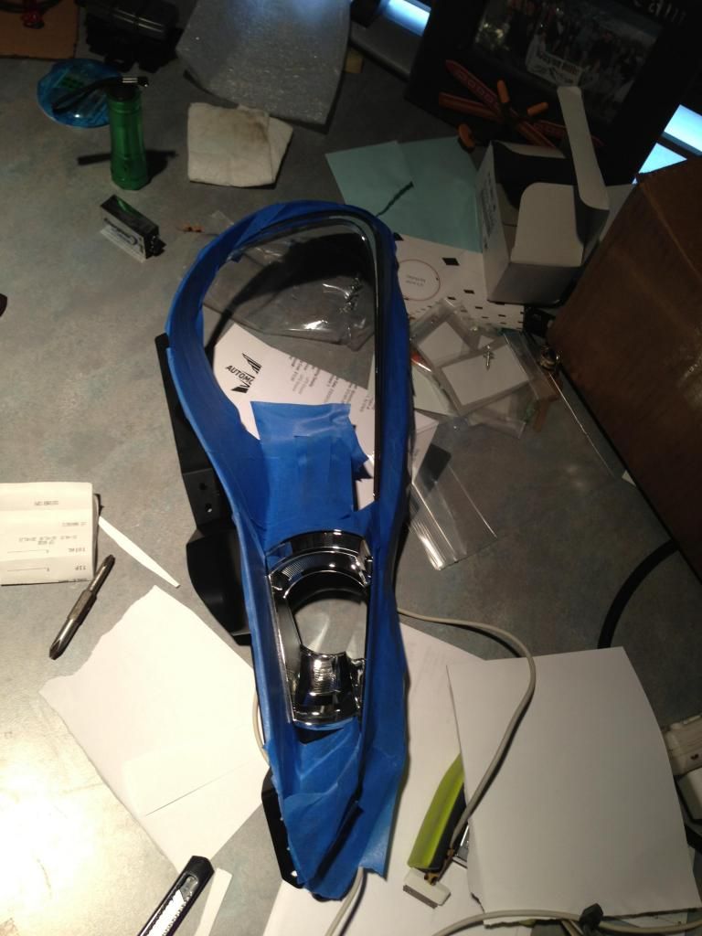

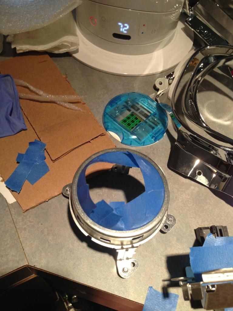

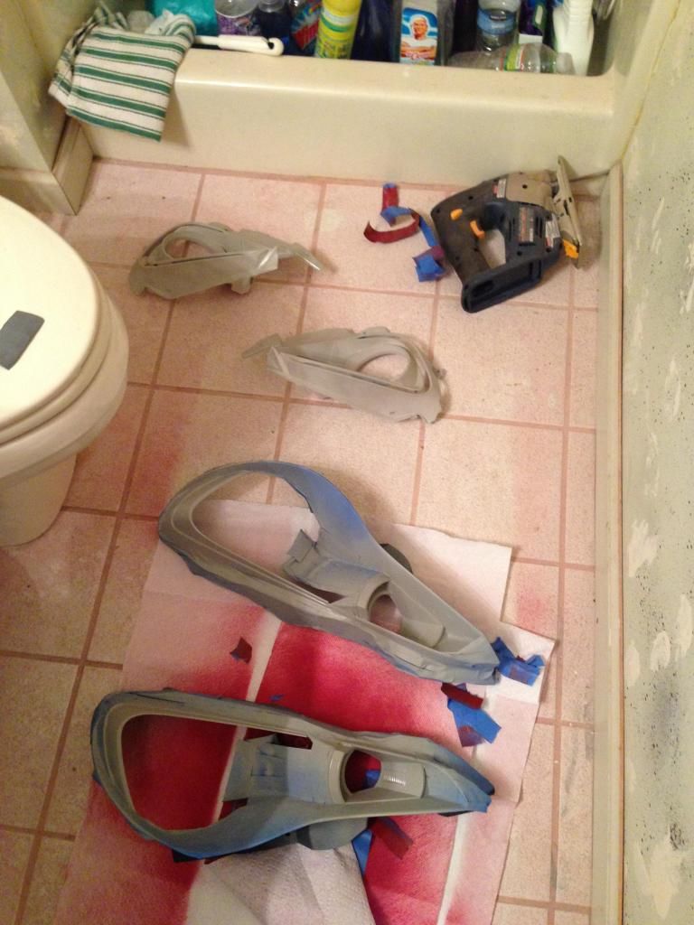

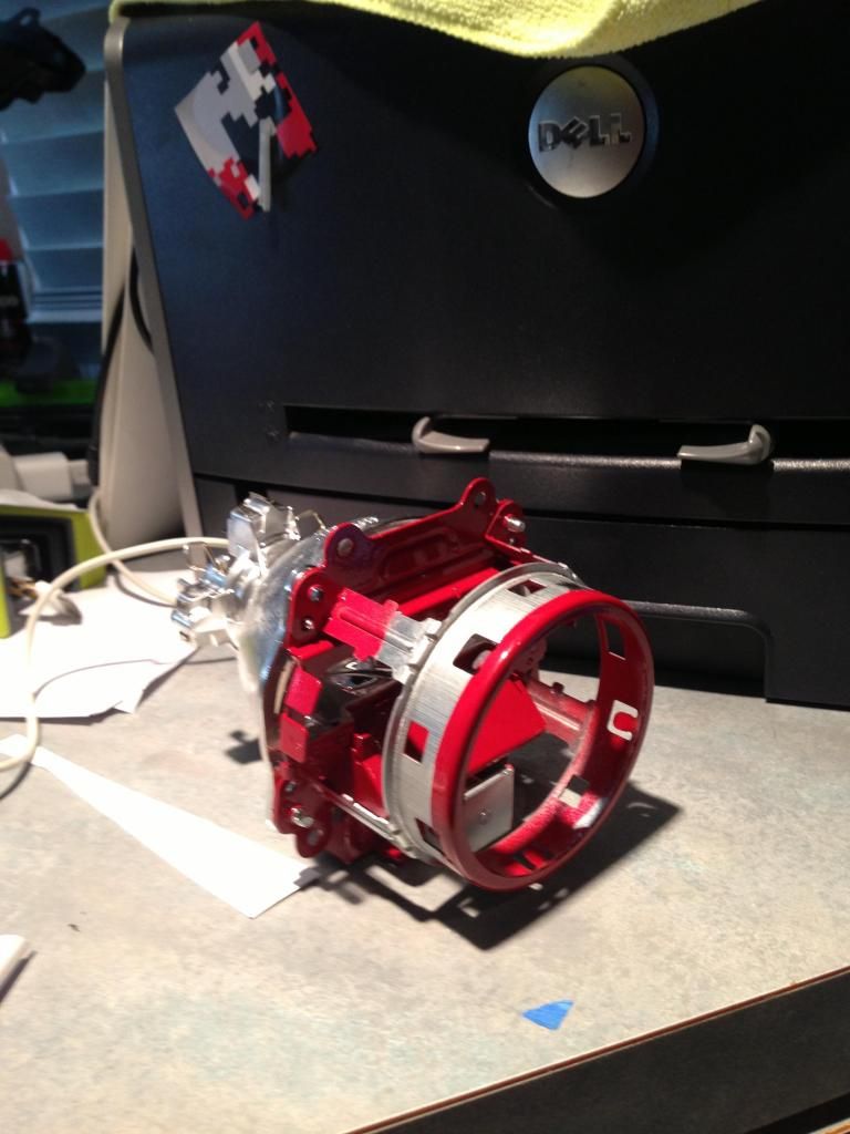

Get everything ready for paint

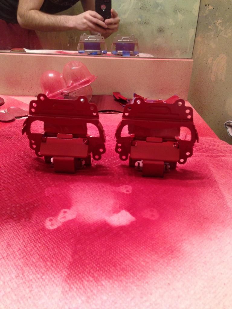

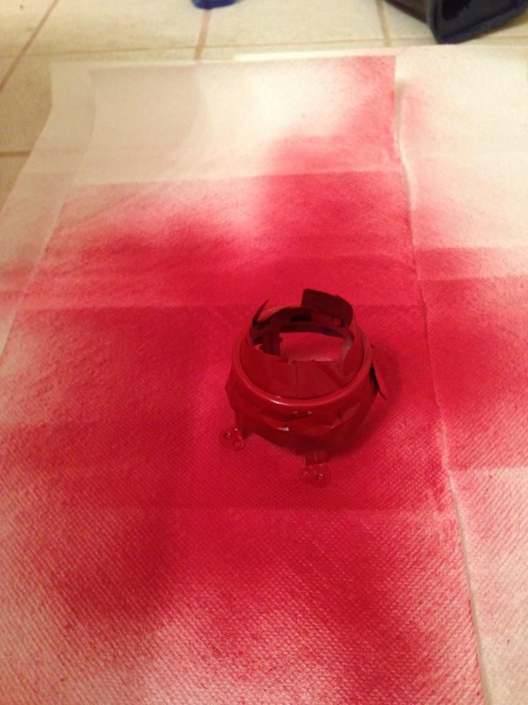

and then paint

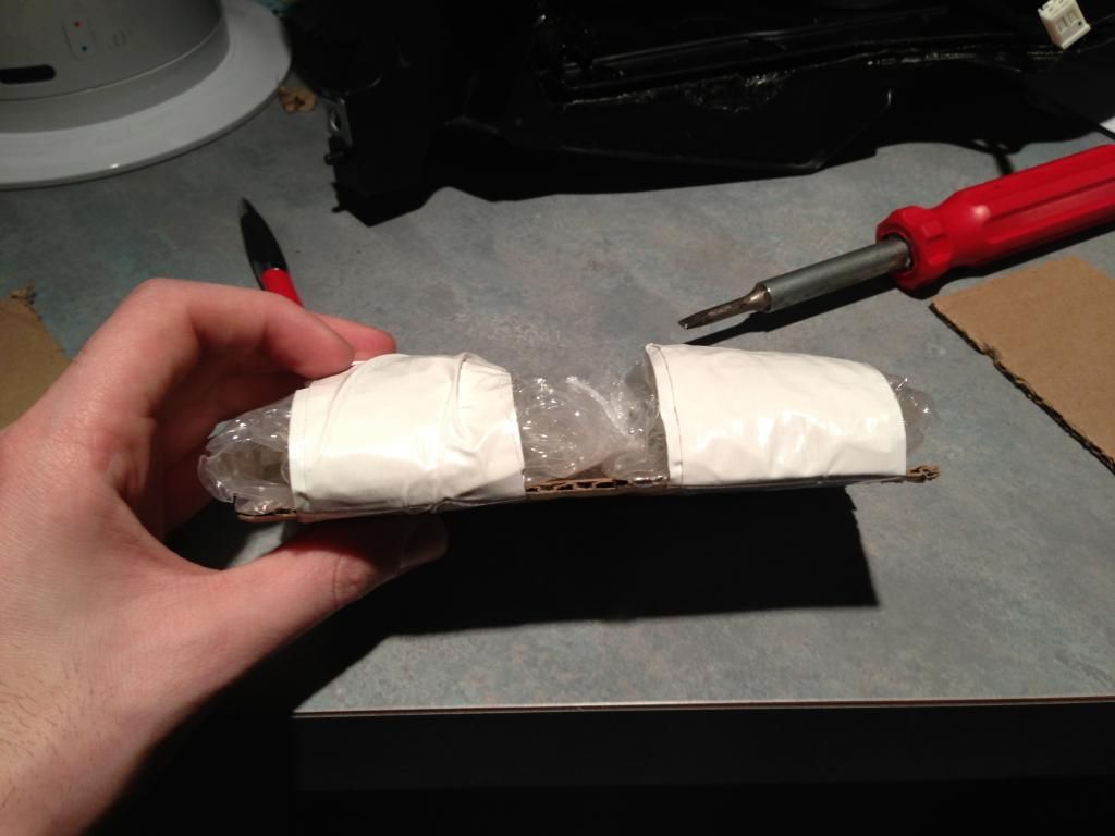

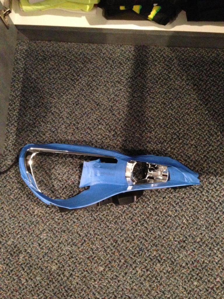

make sure everything important is taped off (cutoff shield solenoids)

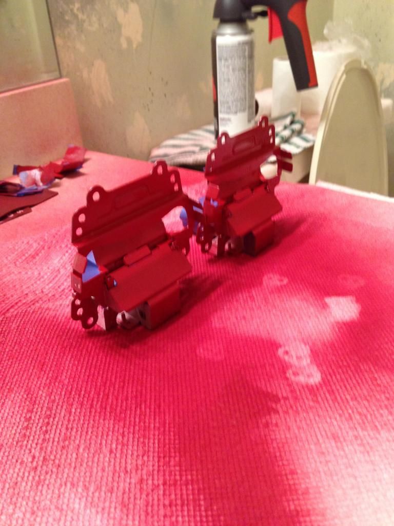

Primer
Base coat
Clear
put everything back together to admire your work
put everything back together bulbs and all but obviously dont bake anything you dont have lenses! The reason for this is to get your projectors hot make sure everything still works after it has been painted and also you are some what baking the paint on to your cutoff shield.

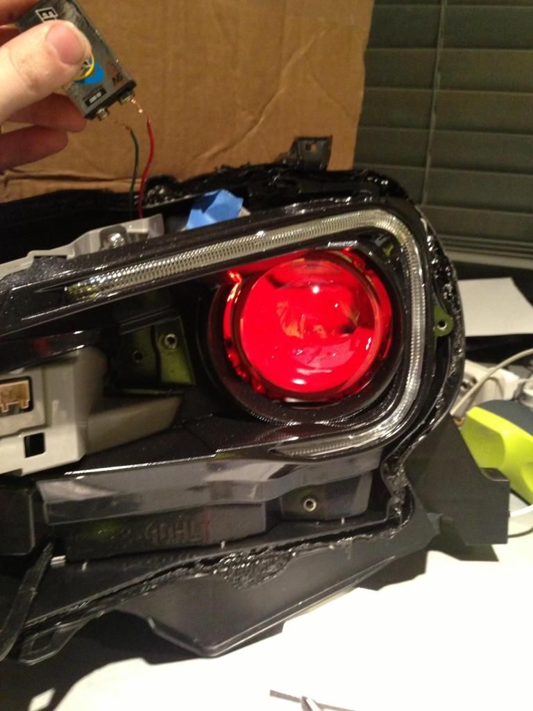

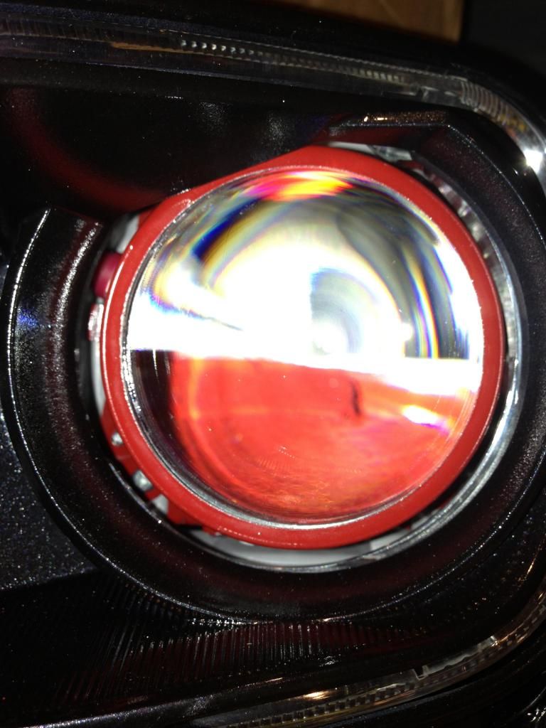

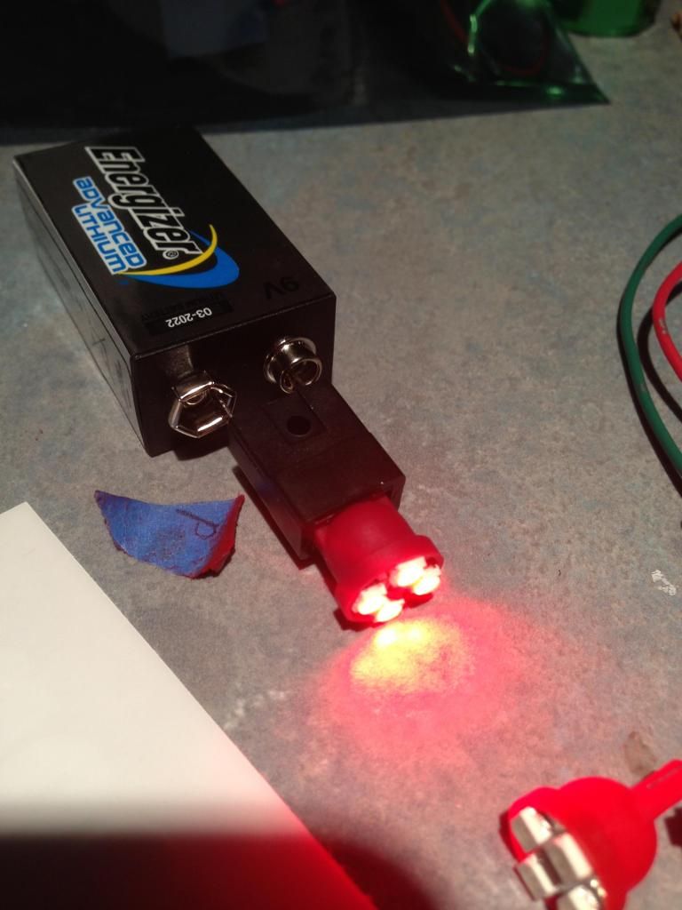

once this is done and everything works you can move onto your led's i order wedge led's off ebay in color red and the bases are from superbright led.com
With lenses i found it was best to shine the led from the side

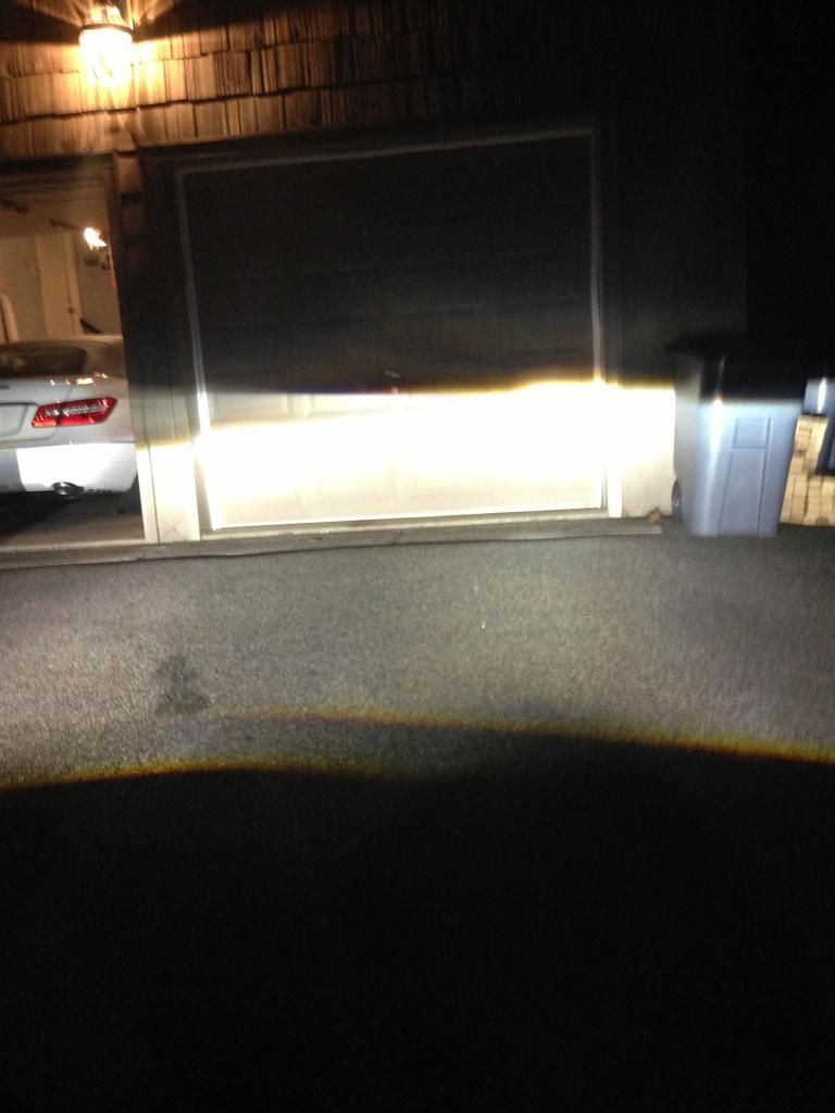

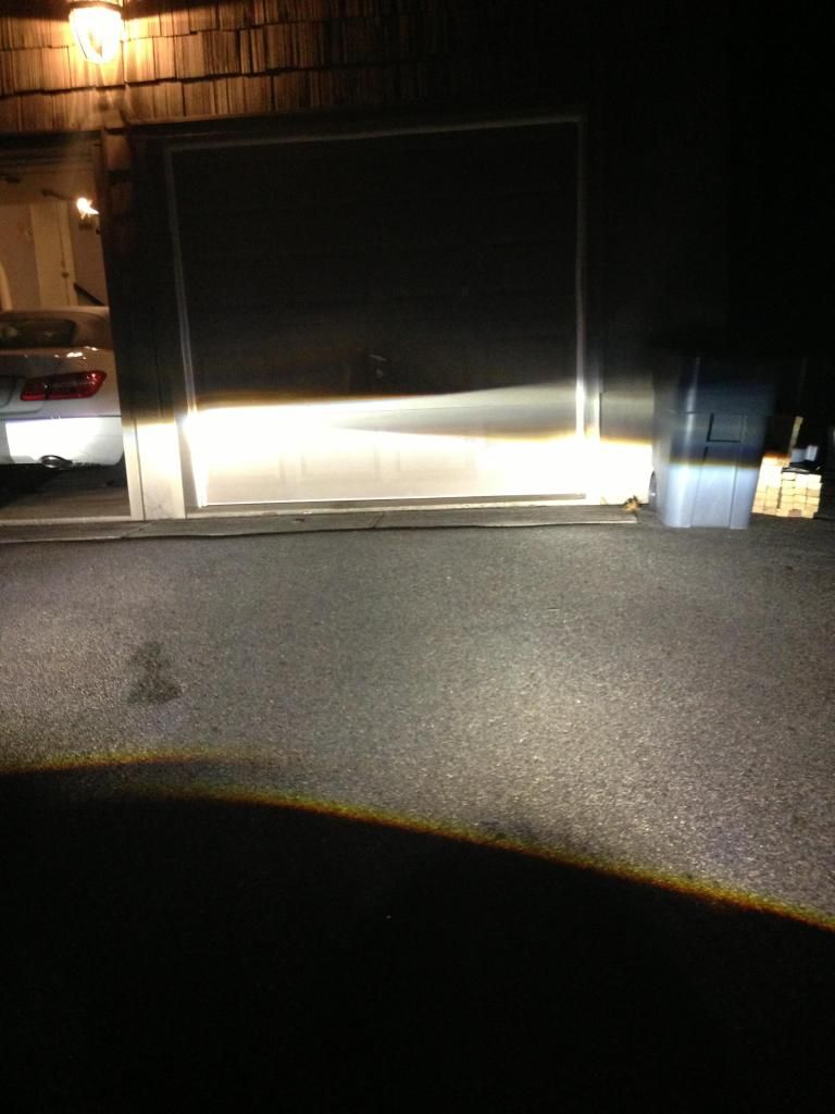

testing my output

Did you really just paint in your bathroom...getting overspray everywhere...lmao
Its an old bathroom in the basement i put a space heater down there to control the temp and painted away.. Its never used and going to be ripped out anyways!

Nice, I thought that you were like f--- this bathroom, the car is more important!

Well i mean the car is more important... House smelled like paint for days!

Why did you choose to have the stock lenses polished over getting the STI-R lenses? Only reason I ask is your cutoff (assuming the pictures of it are with the polished lenses) doesn't look nearly as sharp as it should be. How far away from the wall were you?

Those are un tuned from about 10 feet i chose this route because in order to fit the sti-r you must use a sanding wheel to widen the lens holder the oem fits right back in... When i get home from colorado on tuesday im going to add washers to tune the cutoff. Should only take one #6 washer on all sides and some playing around. Either way with the sti-r or oem polished the projector must be tuned.
