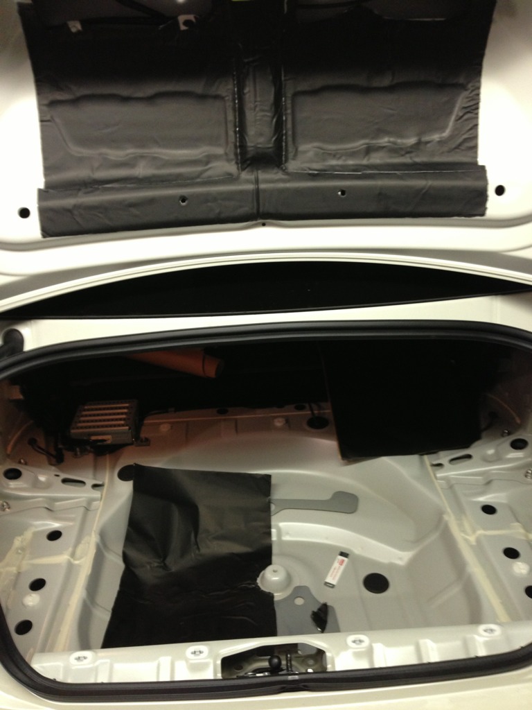

I kept focusing on work and kept forgetting to take pics. Till i was done, every inch of white in the second pic has been covered. I also did the majority of the beam under the rear deck/ 3rd brake light and into the wheel wells. Im not done w the trunk lid but had to call it a night, and i can get to that with out taking anything apart so itll be an easy fix.
As for the effect, i have not driven it far since, so i may come back and add comments, but the cruising drone has minimized a fair amount, however WOT seems to be the same. It has "cleaned" up the noise coming in through the trunk, so it is less harsh to the ears, and has minimized the couple rattles i had when letting off the gas from 5k down to 2k, i now have 1 rattle somewhere left to find...
My 16sq ft i ordered weighed 14lbs, and i used a little over half. If anyone is curious as to sq ft or weight. I would suggest 10+ sq ft to be safe (just the deck lid, rear deck underside, entire spare tire floor area, and wheel wells. Basically everything behind the rear seats) for doors, under seats, roof, obviously you would need alot more.
For the amount of sound reduced, would you go through it again?

Yes. Basically 50$ and 2 hours of time (my first time ever taking anything out of the frs interior and first time ever doing sound matting)

Originally Posted by jshadeck View Post
Attachment 25006
Attachment 25007
Attachment 25008
I am considering doing sound deadening on my trunk too. Can you kindly give everyone an update? Does it improve much on the noise? Do you do it on the door too? Many thanks,
