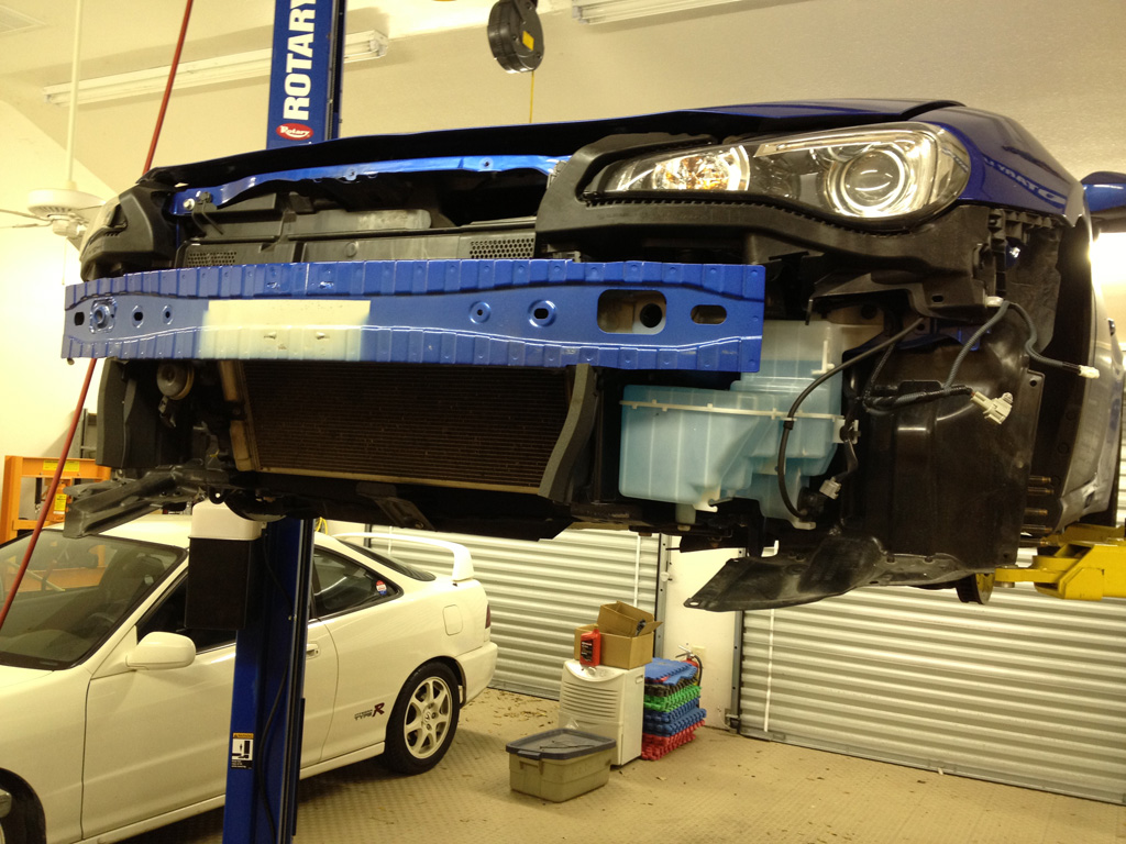

So while I was waiting for my FA20Club intake (should be here today!!) I figured I'd mount the cooler itself.. can't run the lines until the intake is in so I can route/cut/etc accurately. I made the brackets/braces out of 2"x1/8" aluminum from Home Depot. SS hardware with locktite on the nuts. 1/4"-20 1" long bolts, flat washers on both sides, locking washer on the nut side. 3/4" long bolts would have worked honestly. Made the brackets my measuring once, cutting, use that as a base pattern (angles are to fit on the bottom which has a curved "opening" area). Once the basic shapes were done, marked the spot where the cooler would side (marked that on the car with tape, so then transfered that to the brackets), put two brackets together, clamped, center punched, drilled. Then split those two, ground the burrs off, clamped each one to another undrilled bracket to use as a template. Ended up with everything lining up perfectly (I was shocked). Drilled holes to match template's cooler holes in the plastic panel, then mounted cooler with brackets to start the other 8 holes for the bracket, removed everything, drilled and finished the plastic panel, then installed everything.
I will be added a strap to the top of the cooler going to an existed welded on nut in the bumper support later.
Naked front end

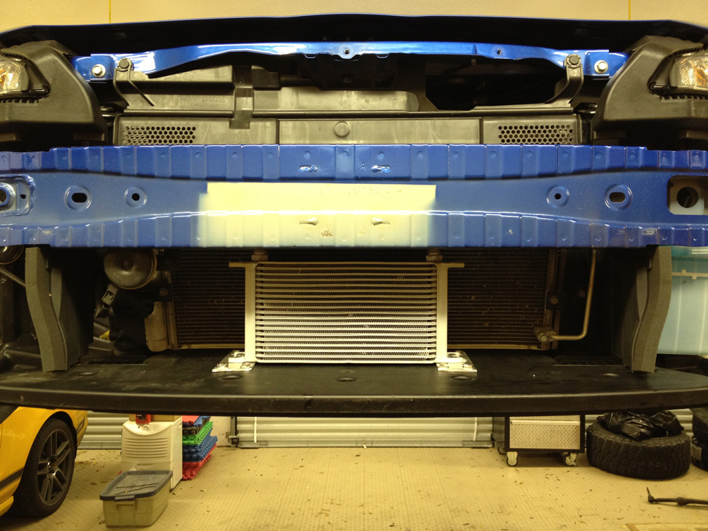

Cooler mounted, panel sitting outside the car still:

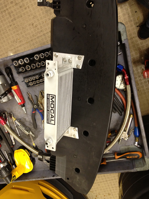

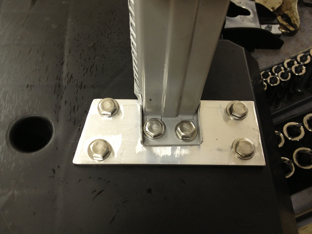

Up close of the mounting bracket I made:
On the car:

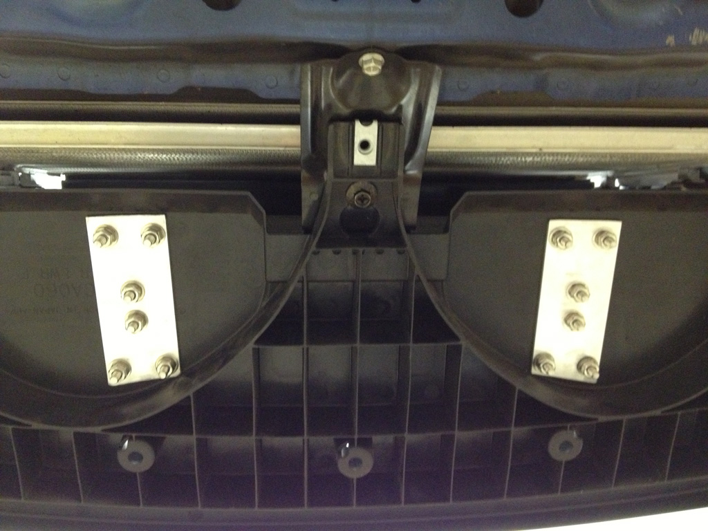

Bottom brackets:

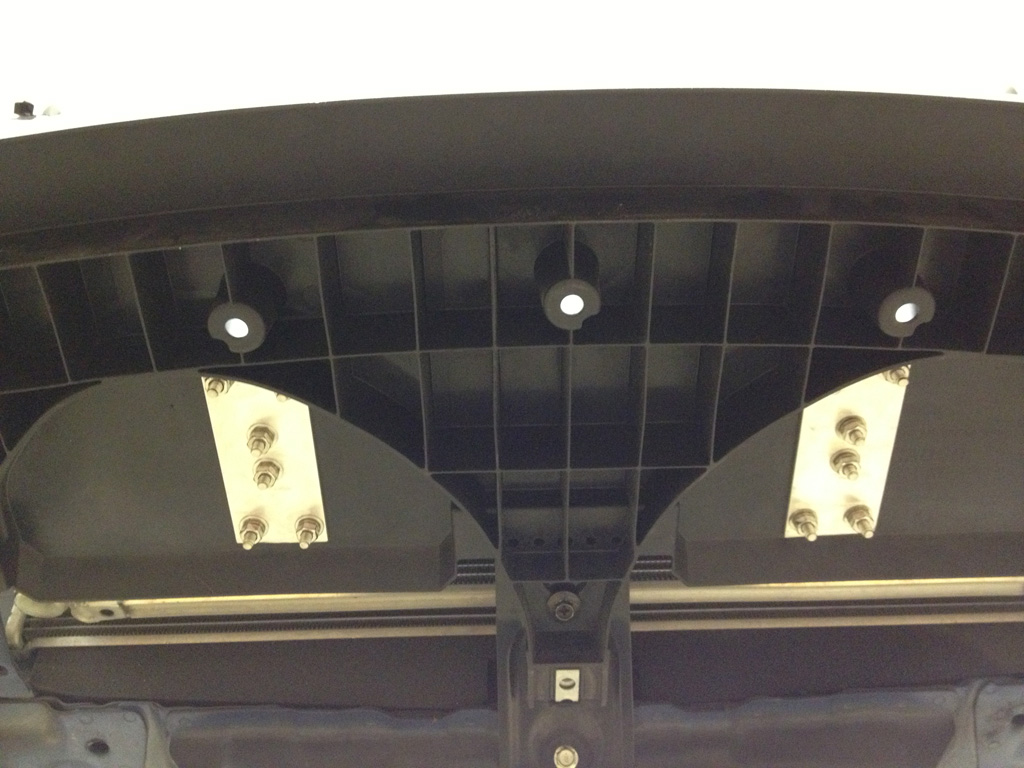

Another pic of the bottom brackets:
