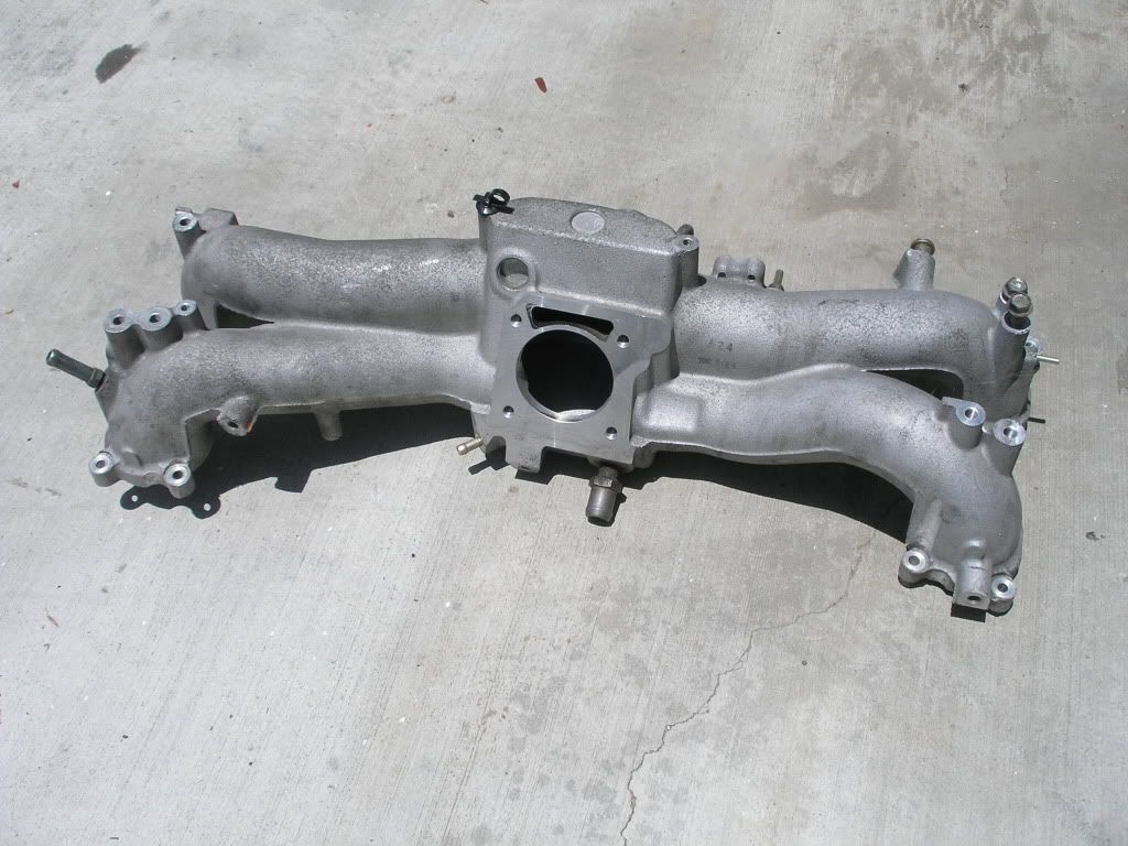

ask yourselves if you have ever seen an UEL intake manifold...
yes, and they suck.
4AGZE intake manifold

We can start with what the engine ECU needs to get information about fuel requirements. It needs an airflow reference (the MAF) and a combustion efficiency reference (the O2 sensor). Both of which are reading averages. But on an UEL header it is not scavenging equally on both banks. So if you need 12.5:1 AFR for best power on a UEL one bank may be at 12:1 and the other at 13:1.
To the UEL fans, ask yourselves if you have ever seen an UEL intake manifold...
Stock Subaru intake manifolds have unequal length runners...or at least the older cast aluminum manifolds did.
How unequal?
Most I've seen look pretty equal. Any runner length variability probably has to do with port length.
I can't imagine any intake being as asymmetric as the exhaust manifolds.

No, it's not nearly that bad. Just being a smartass.
