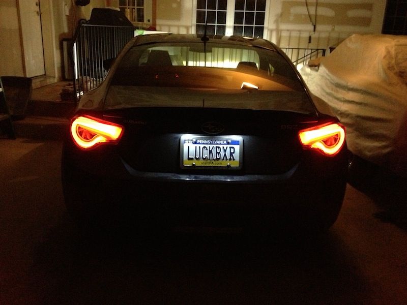

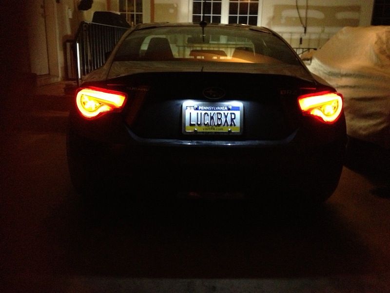

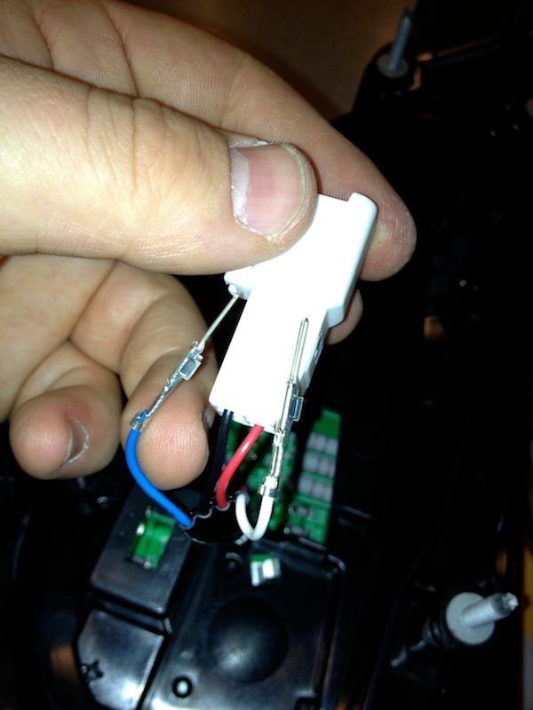

OK, success! Rewiring isn't difficult at all and doesn't involve any wire cutting/soldering/etc. Here are some pics and info:
My lights shipped 1/25, with an amazingly fast ETA of 1/30. Somehow, they actually arrived a day early on the 29th. Nice looking box:
And inside:
I excitedly hooked up the first light and was pretty pissed when it was clearly wired incorrectly (at least for our US cars). The yellow center light stayed solid and the red outer bar would hyperblink as a turn signal. Many many thanks to BuBlake for doing the experimenting and discovering that we need to swap the blue and white wires to achieve proper functionality. And thanks to Gixxer for explaining that you can actually just slide the wires out. I used a very small screwdriver and it was pretty easy once I figured it out. You stick the screwdriver in the side of the harness opposite the wires, and decompress the tiny white tab, by pushing it in the direction AWAY from the wire you are trying to remove...while pulling the wire. Here's what the wires look like once released:
You just swap them and slide them back in and they click into place. No big deal!
One light installed, big improvement IMO:
Both in:
Hazards:
Overall, I think the lights look great. They look very bright in general, although the turn signals may be quite a bit dimmer than stock. I'll take some daylight pics soon so you can see how the red housings look.
I just reused the stock gaskets...I suppose it would be nice to install fresh gaskets along with the new lights. We'll have to see how these hold up, but of course I'm a bit worried about condensation issues. I did use a torque wrench and torqued the nuts down to 39 in. lb., and in the proper order, as noted in the service bulletin.
