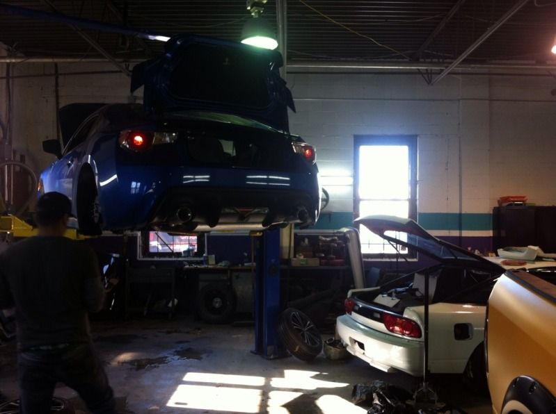

dont mean to thread jack but ill share some low quality cellphone pics..
coils being put on. BC BR Extreme Lows 10k all around, took me and my buddy about 30 mins lol
car on the floor, fresh coils on. maxed out front and rear, removed a ring from the fronts- springs havent settled yet
test fitted wheels today , stock fenders
