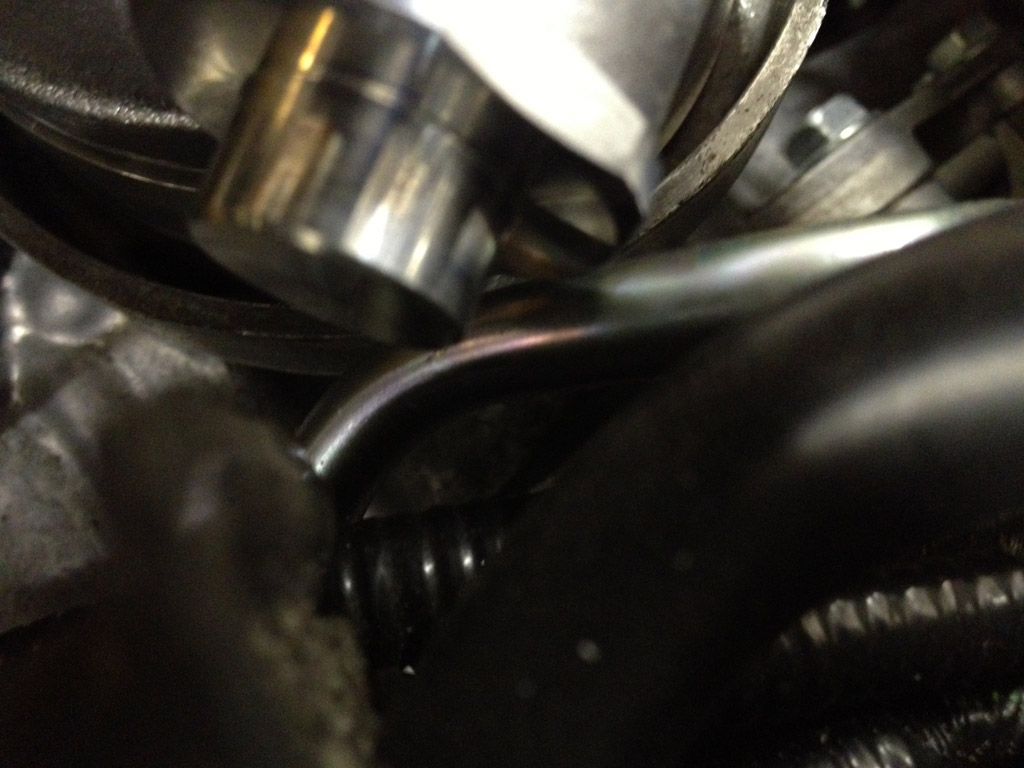

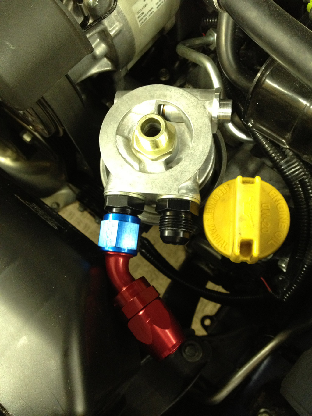

Cooler sandwich plate clearance.. I have a 45 on there as an attempt.. a 90 would work probably but create a less than ideal hose routing and additional hose length.
Clearance to the metal "fuel line" (in quotes because I think that's what it is) when the sandwich plate is positioned to clear both the oil fill and stock airbox.

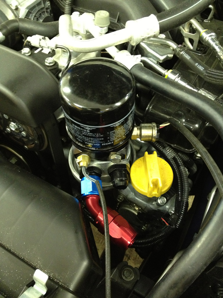

And the stack of sandwich plates. 1" Mocal spacer, 1" Mocal oil cooler sandwich plate and 1" glowshift sandwich plate with defi oil temp and oil pressure sensors.
