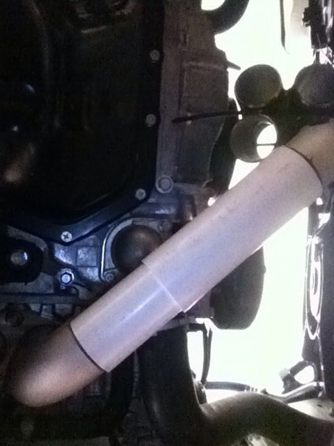

Want to know a tip of fabricating turbo manifolds that I found after building more than I can count...
Telescopic PVC straight sections to get your lengths perfect

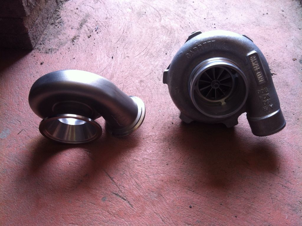

Thanked 240 Times in 116 Posts
Arrival of the gtx2867r and .64 tial housing.

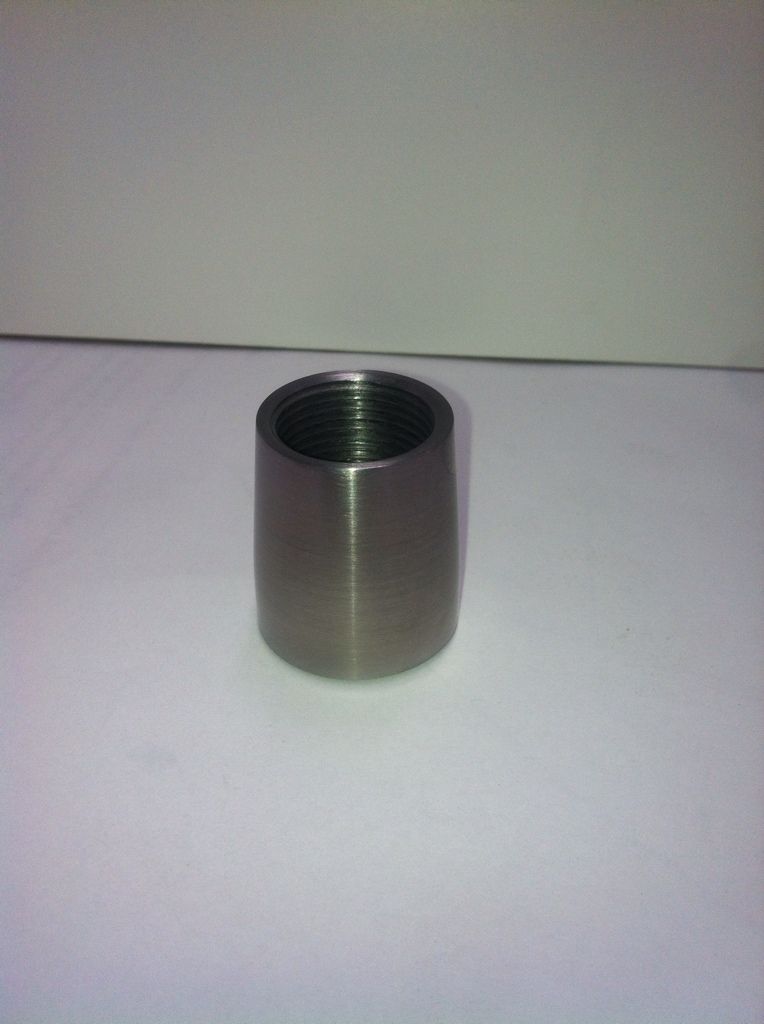

Made up the sump weld on bung for the oil drain.
