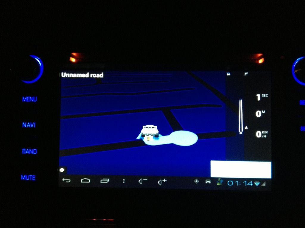

Right, the radio is rooted and after a MASSIVE amount of fiddling I've managed to sort the memory problem out which prevented some apps from installing. The mount points were a bit wonky so now both internal SD and external SD are both pointing to the microsd card.
Managed to install Tomtom and it's working great, even with my HD Live traffic subscription! Lots of happiness there.
Next step is to make it report itself as a Nexus tablet which would remove most of the Play Store restrictions. Some apps are showing up as "not compatible" because the device is not recognized.
Then I need to find a compatible USB BT dongle, or at least one which has got drivers for Android I could install.
Now that it's rooted there is pretty much nothing you can't do. I'll eventually start looking into reducing the boot time as well...
It was a bit of a disappointing start but I'm VERY happy with this radio now.

Some more pics:

Not the best pic, sorry I had to take it an angle because of glare:
