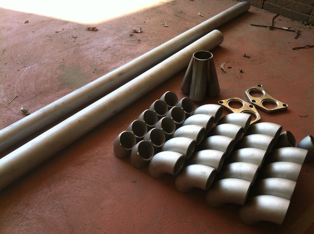

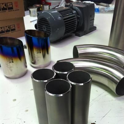

time for the fabrication to begin.
the turbo manifold is 1.5" 305 stainless steel sch10 steam pipe for durability and it will never rust, it also uses stainless cnc cut flanges and will feed a tial stainless exhaust housing

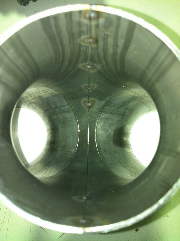

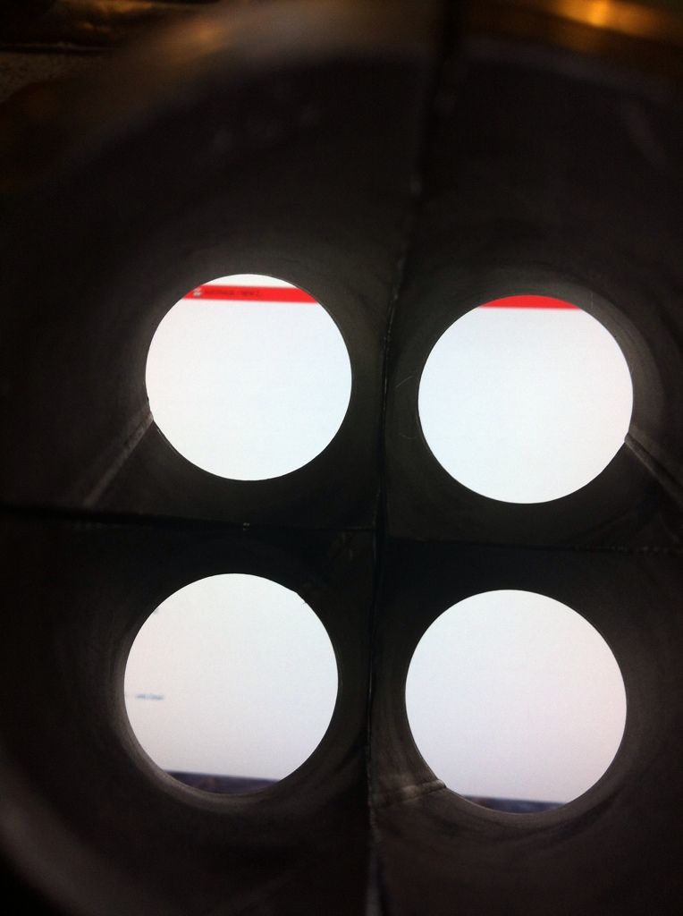

making the collector

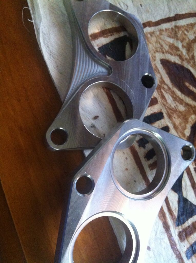

cnc cut

tacked

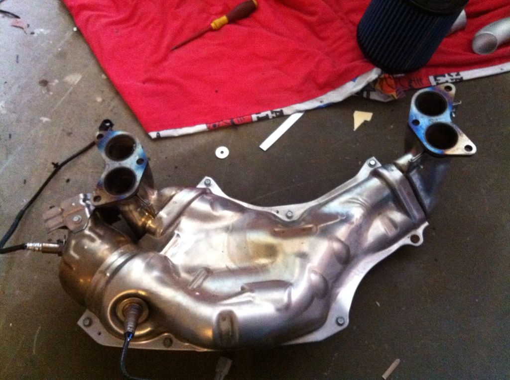

this has to come out for measurements

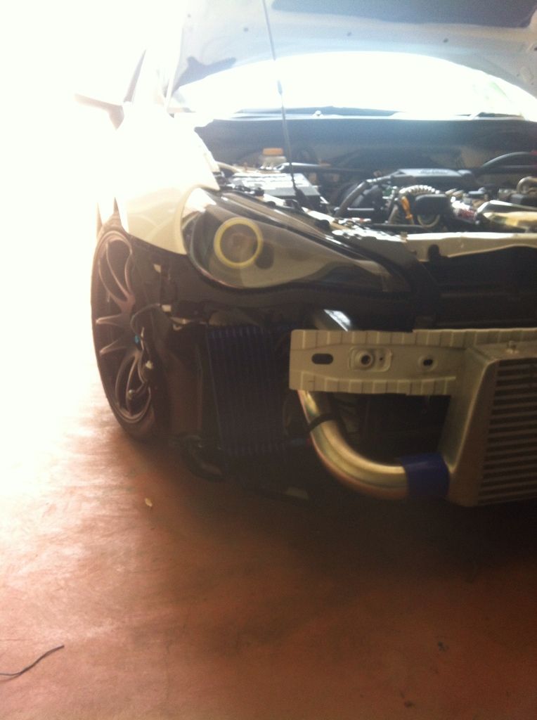

was fitting up oil cooler

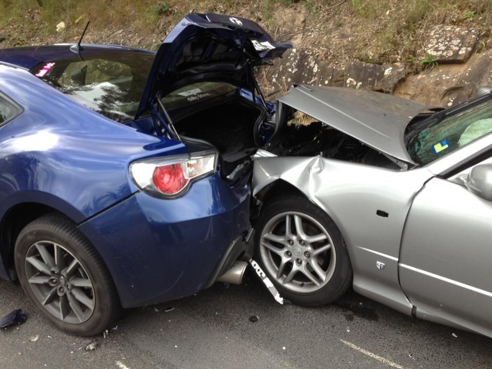

oh btw most of you already seen what happened to the car i was using for my measurements before the white 86 came :/
