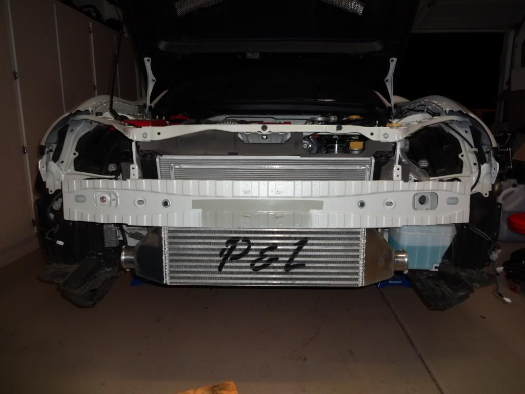

Started pulling stuff apart and decided to mount the intercooler...should be receiving the rest of my kit tomorrow!!!
Is is required to take that much off?
could you have left some stuff on like the lights and what not?
I'm sure you could leave the right side light on, but the left one no way. Besides once you take the bumper off the lights are super easy to remove, maybe 5 minutes total per side.
