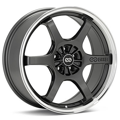

I'm really liking the looks of the EV5 and SR6 Enkei's on TireRack.
Sadly, I'm not too good with wheels, so I'm fairly lost here.
