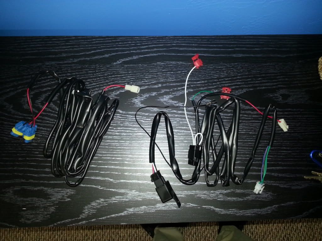

If the legacy fog light housing are using H11 bulbs. (Read from above comment)
The wiring kit that I provided will fit H11 bulbs and wiring kit also has an aftermarket button.
Photo of the harness and aftermarket on/off button.
Fog light button connected with the wiring
If you want to go with the full OEM look using the stalk, you will have to modify the wiring a little bit to hook up with the stalk. Then you are all set and good to go.

that way actually looks easier (and makes more sense since no auto lights), but where wud i add the button? does it fight right where the BRZ leveling switch goes?

will you sell the harness separately?

how much for this wiring kit?
