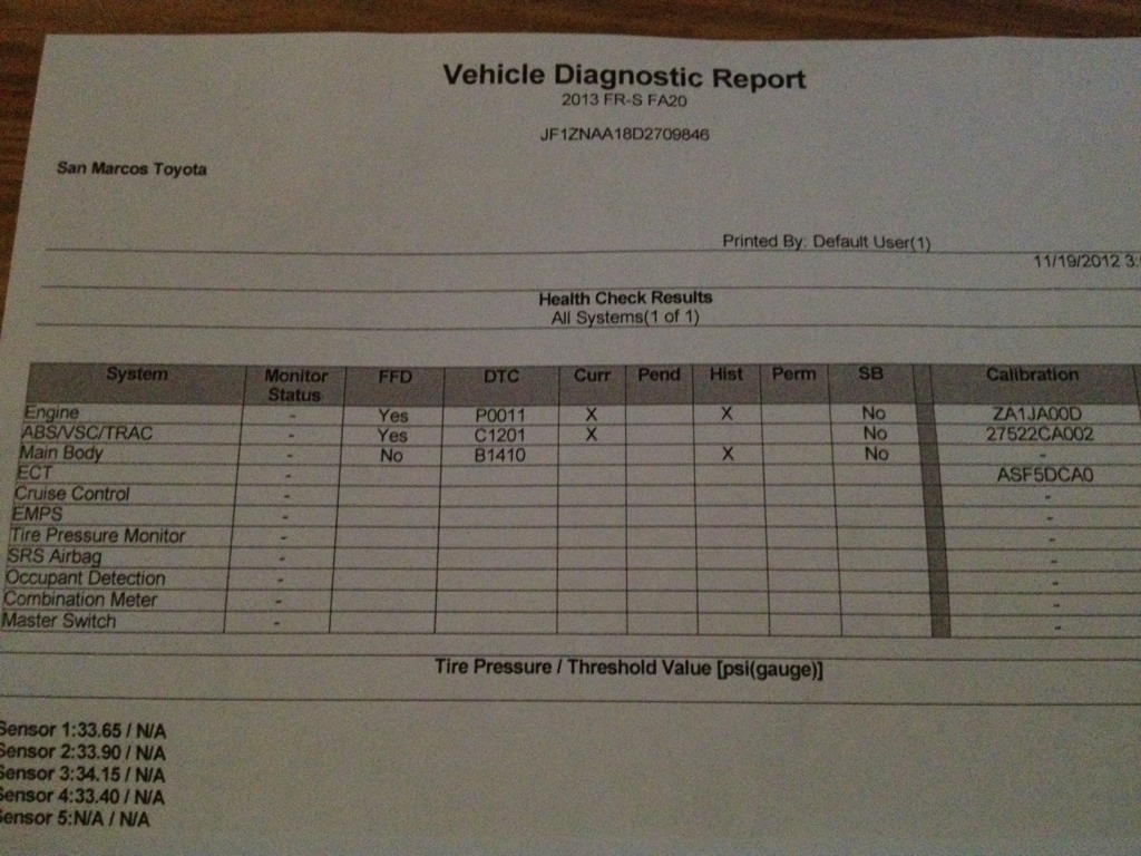

I got an update on my CEL issue and more tests are apparently needed bfore toyota is willing to ship parts to fix the issue and was told by my service advisor that it was actually recomended by toyota technical that the car be given back to me to just see if i would have another code CEL code thrown. hoping this get fixed soon as i miss this car! just fustrated with toyota that all though there is an obvious issue coperate insists on performing the same test yet again to come to the same conclusion.

Originally Posted by tuckdaddy View Post
Attachment 20816
Threw three codes today after filling up
P0011
C1201
B1410
I had the camshaft get out of sync/position
Had all the traction and abs systems fail
And the transponder in the key go haywire
When I had the codes pulled I was told the car is good to drive after the CEL went away and everything reset itself before heading to the dealer after letting it sit. Hoping it really isn't something major... Been running smoothly for the past hour
I had the dealer pull the codes on tech stream and wipe them to see if I threw them again before i could get back to Boerne since I know the guys who work on my car and am nothing but pleased with them. But the codes above are what I pulled both times in both Boerne and San Marcos's dealers
Have they updated the latest ecu calibration?
I was told I have it and we even thought hell maybe I just needed a reflash. But it looks like a new ECU and the cam assembly
