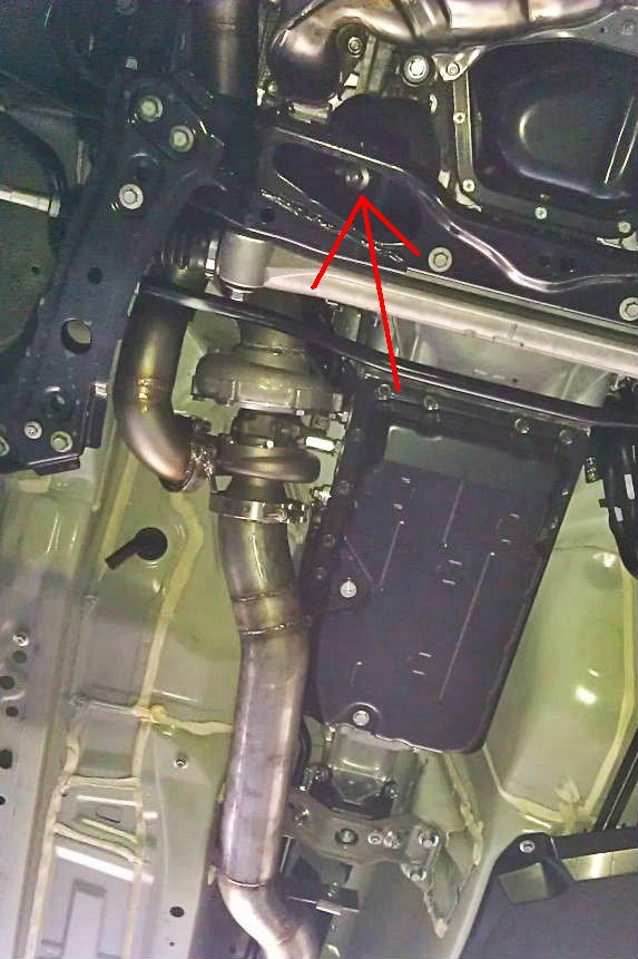

Originally Posted by youcantseeme24 View Post
does that come with instructions?
No instructions. Not really needed, it is super simple really. I can get pics of the support the needs to be loosened when I change the oil.
EDIT: Look at this pic
Loosen that nut, lift the engine 2-3 inches, and good to go. Very simple.
Attachment 21161
thanks for that!.....that turbo sure looks nice. Hows you liking that?
