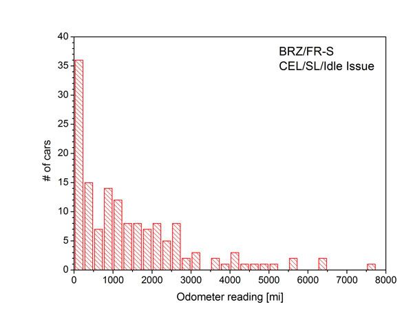

What is standard deviation on it. Because I am outside of it.
Mean 1440mi
STD 1500mi
So as 86BRZ mentioned you need to pass ~3000mi before you can start to think that your engine is safe.
Note however that 24% of the reported CEL issues occurred within the first 250 miles.

Originally Posted by so26 View Post
Mean 1440mi
STD 1500mi
I think this further illustrates this is not a software but a hardware problem. Software issues dont vary, its on or off.
Not sure if someone has done this before but here is a histogram of the CEL/SL/Idle issue created using eurospeed's list
Well, now you're going to have to add a bar in the 3750-4000 range... ME!
