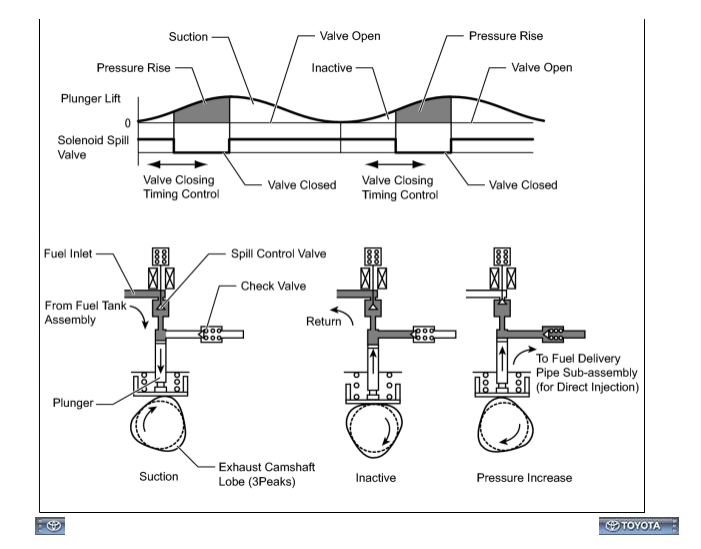

The one main difference with this engine, the cam manufacturers must account for the high pressure fuel pump that is driven off the cam lobe.
Off of a LOBE? or driven by the cam end (like a CAS or mechanical fuel pump) I don't see how its even possible to use a cam lobe to operate anything other than the rocker it sits on?
assuming its driven off the end of the cam, then it should be a big deal to drill/tap the camshaft to accept it.

From the sounds of it, a set of 264/256 cams will need nothing but just the cams... The valvetrain is set for a great deal of stress and shouldn't be needed to have great reliability... From what ive heard and seen.

^ thanks for the file, I have now decided that is retarded. why on earth would they engineer something like that.
