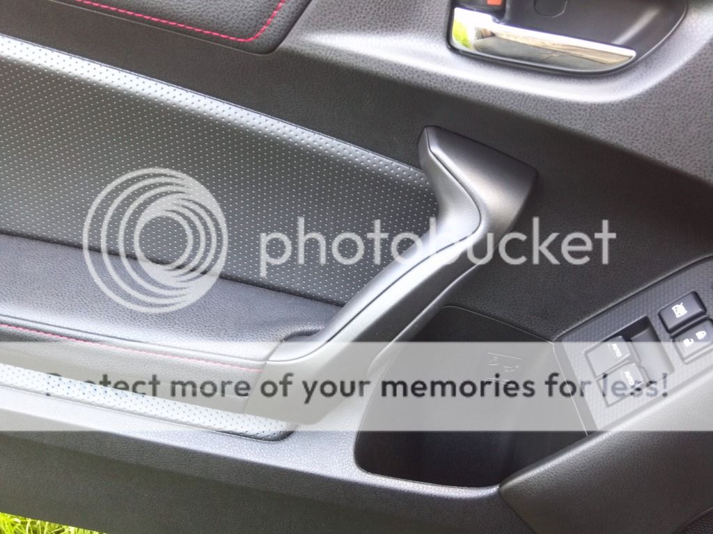

Location: Syracuse

How do gou take those off?

Clean
for the door handles. look at the bottom with a flash light. there is a cut-out/slot. pry with a screwdriver and it will pop out. these come out very hard but they do just pop out. (((( DO NOT START FROM THE TOP)))) there is a tab at the top that tucks in. once the bottom pops just work your way up and keep the bottom pulled out.
