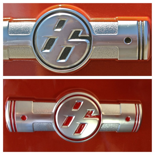

Did mine today

Here's mine:

Originally Posted by ZeN6 View Post
Here's mine:
Wow, that badge looks amazing. Mind I ask how you did it?
2013 Whiteout 6MT
ipothas is offline   Reply With Quote
The Following User Says Thank You to ipothas For This Useful Post:
ZeN6 (10-11-2012)
Old 10-11-2012, 05:59 PM   #37
ZeN6
ZeN6's Avatar
Drives: Firestorm M/T FRS
Location: 209
Posts: 41
Thanks: 12
Thanked 27 Times in 15 Posts
Originally Posted by Khalis View Post
This DIY is to turn your boring old USDM Piston Badge into a ghetto "JDM" Piston Badge.
@Khalis: I don't mean to Tread Jack. If you want to remove this I can.
This is how I did it:
I basically did the same thing as your DIY on painting your Scion Emblems.
I sprayed 2 coats of White DupliColor primer.
I then followed that up with 2-3 coats of Gloss Black DupliColor.
I left it to dry over night just in case.
Then I went ahead and did the red, which I used Simply Acrylic Scarlet Paint.
At first I tried doing as Jeffsides did and painted with a small paint brush but my hands are not that steady and I keep messing up.
So what I did instead was put down a blob of the paint in the areas that was to be red and then used a Q-Tip Cotton Swab and wiped the excess off leaving the red in the indents. I did a section at a time (inside the 86, then the circle outside, then the two lines on the pistons).
After I wiped off the red there was smears on the black portions. To clean that I dipped the Q-tips in water and carefully wiped away the red that I don’t want. (Wasted a lot of Q-Tips, I used both sides once and tossed them. Did not want to drag any red)
For the first piston it took me awhile (2-3hrs) because I use rolled up paper towels. I then switched to Q-tips and it worked great. The second one took me an hour but I was watching TV as well.
I let it dry over night just to be sure. The next day there was still some red hazing on the black portions and water wouldn’t take it off so I used Lysol Disinfecting Cleaning Wipes, and CAREFULLY wiped the haze away.
Then I put 2 coats of DupliColor Clear Coat.
Done
I got all the material from Wal-Mart.
I don’t have any pictures of the process but here is a couple where the pistons are on my car.

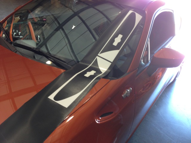

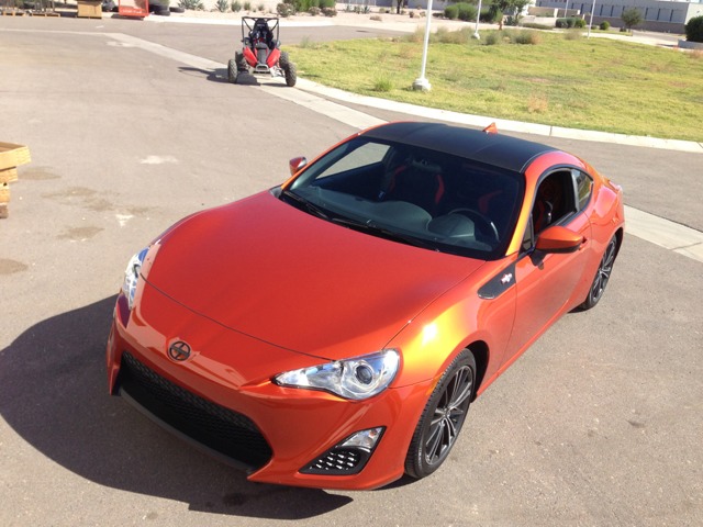

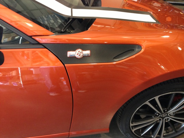

Size:  61.9 KBName:  ImageUploadedByTapatalk1354466488.674201.jpg
Size:  74.2 KBName:  ImageUploadedByTapatalk1354466510.941439.jpg
Carbon vinyl

Where DI'd you get the carbon cut outs
