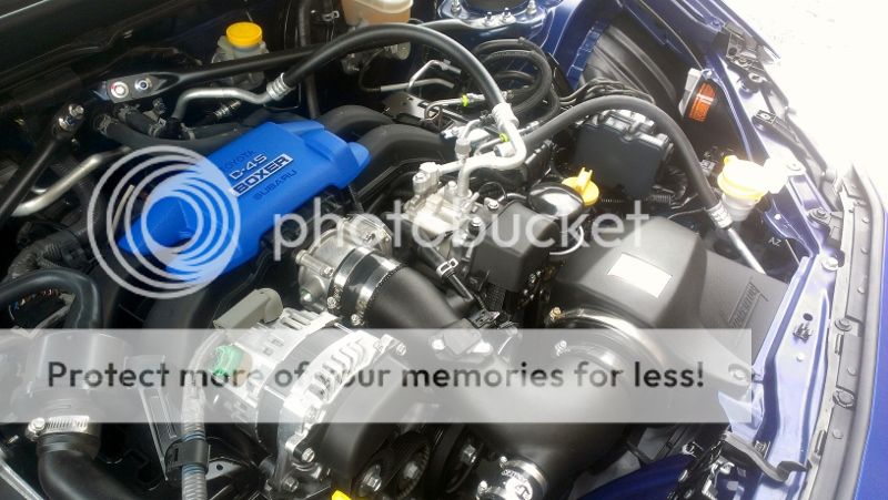

Here's mine. After I installed it I started dressing up my engine.
I heard some people got this decal with their intake. Anyone here want to part with theirs for $5? aFe said they ran out.
Lame for u not gettin the little man, my girl loves the guy and already put hers on.
My front bolt/washer likes to not grab on to the intake, i think i need a bigger washer or something. and I love that blue on the intake manifold cover.
Did you reuse the stock rubber grommets with metal inserts on the two mounting points of the intake?
dident know i could,, ill try it in the morning
