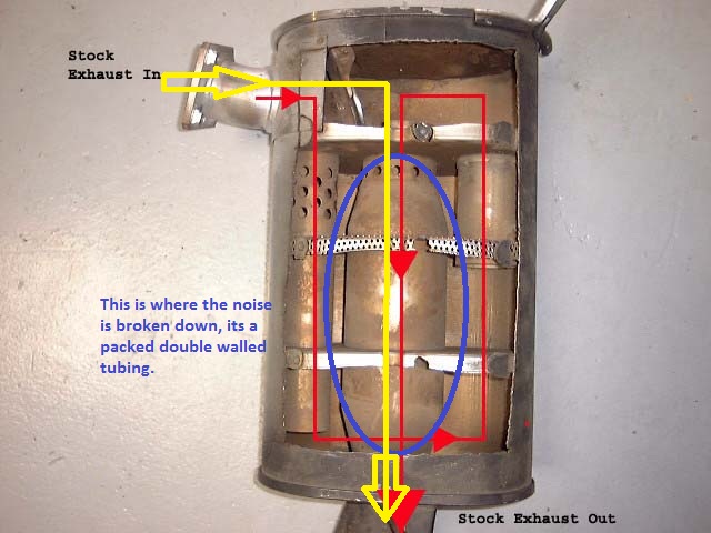

Ill get the picture that Pete took of the internal but we would reroute the pipes inside.. ive attached a picture of an Evo exhaust looks like ours from the inside meaning it doesnt have any packing just chambers to keep noise down but ours is so choked down.. so we are rerouting the exhaust flow so that i doesnt have to go through all the chambers before exiting
Red is stock flow and Yellow is what was done and it gave the car HP and growl.. but retaining the stock "sleeper" look
Attachment 16668
So do you think I could just get a big-ass drill bit and bore right through the center?
Attachment 16668
Thanks! each stock exhaust is different so eager to see the pics of ours.
