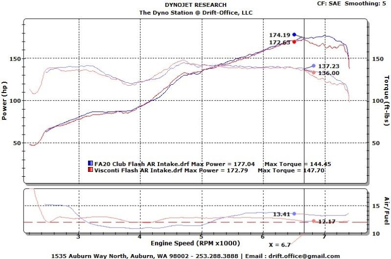

The scaling issue is just something within the Dynojet software, but here it is rescaled in the interest of* transparency and with an easier to read AFR graph (10 - 18) with cursors for reference...
I'm sure most of you don't know me but most that do know I'm really straight on this, a little bit of a nerd even. So there's no hidden agenda here.
Cheers,

Oh, I wasn't being aggressive, just a little bit of a smart ass. I am curious as to why other posts still had AFR's all over the place...

No no, you're fine. Good catch. I just have to remember to keep everything in check and consistent for reasons like this.

So the leaning effect at 6600 rpm + is the cause for the hp & torques increase between the 2 tunes?

Drop in HP like that is caused from knock.
Knock Control is turned always turn on with my calibrations

cant you tune that out with higher octane? would love to see a medley of maps
