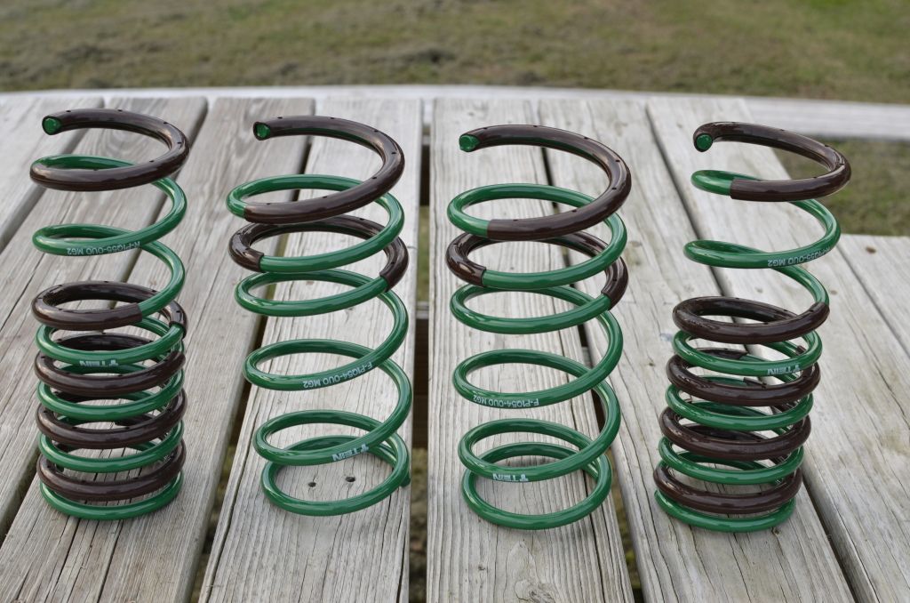

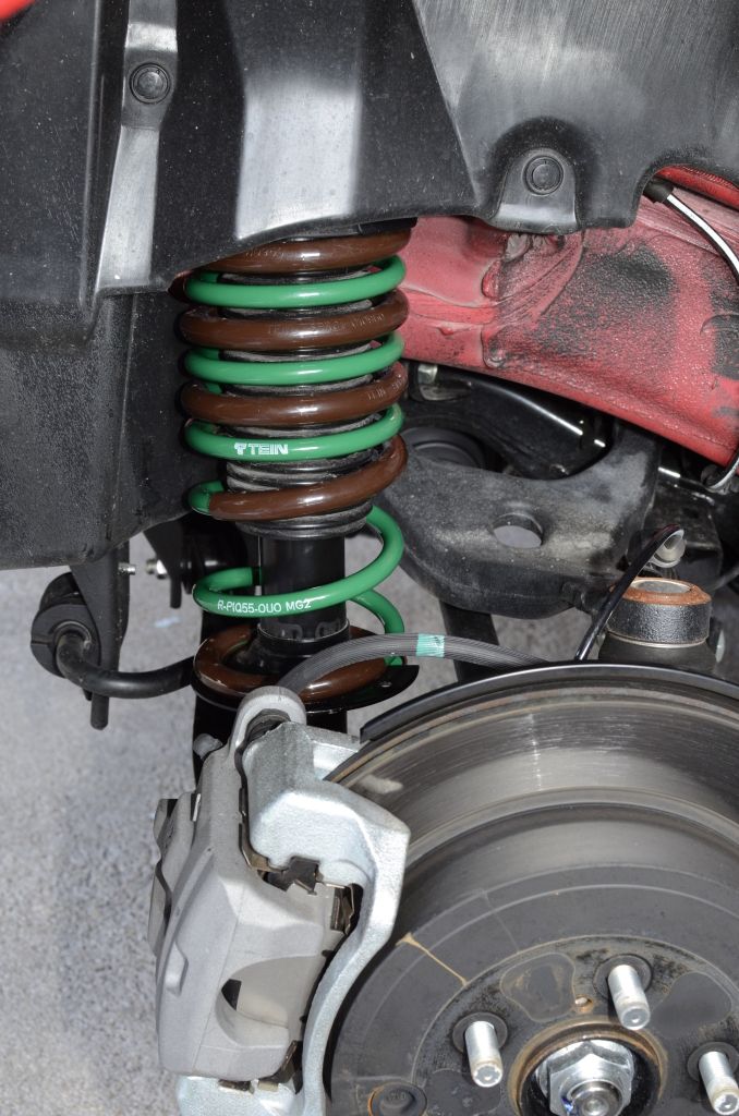

Someone asked me what springs I installed, do instead of going off topic in that thread, I decided to post it up on here...
I just installed Tein S-Tech springs over the weekend. I think it adds a nice slight drop. It feels normal/stock with everyday driving, but you can feel the firmness in the turns and bumps. On the way to work, I go over a set of rail road tracks. This is kind of a gauge for me. In my Miata with stock springs, it was smooth sailing. With Eibach Pro kit springs, I could feel the rails on the rail road, but still a fair/smooth ride over them. With the FR-S, it was just a tad firmer than the Miata with Eibach springs. With the Tein S-Tech, the car felt firmer over the rail road, but it launched me off my seat by like 3 inches. It was funny. The car stayed planted, but I didn't. hehe I guess you could say the springs feel or are progressive. On the highway, the car felt awesome. And it felt even better zipping through the slow 25mph on/off ramps. If I had to do it again, I probably would... or try the Eibach Sportline kit. The Tein's can be had for under $190. So it's a great deal.
For the install, you need to cut about .6 inch off the front bump stop. For the rears you leave the full bump stop. Also, when installing the rears, you do not need a spring compressor to mount the top hat with the Tein rear spring. Just push down on the spring and slip on the nut. Easy peezy. I'll post pictures of the car dropped, but here are some spring pics...
Tein S-Tech Spring set...
Fronts installed...
Rears installed...
