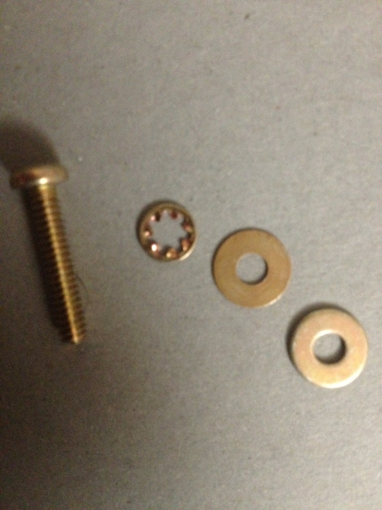

I conquer. For an960-6 you can substitute with nas1149fn632p and an960-l with 616p , I'm not a big fan of the lock washer instead I used ms35333-37 star washer Name:  ImageUploadedByTapatalk1347060919.446429.jpg

The lock washer should be optional.
I don't like any of them because they all generate metal shavings everytime you do a test fit.
Have you considered/found a suitable Belleville washer?

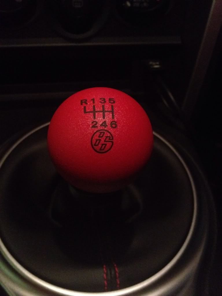

Got mine! Used the jam nut to align it perfectly, didnt need anything special. I was impressed to see how heavy the stock one was, but this is a great improvement!
I am really thinking about the euro red e-brake handle and stitched boot to bring it all together....any input on that?
