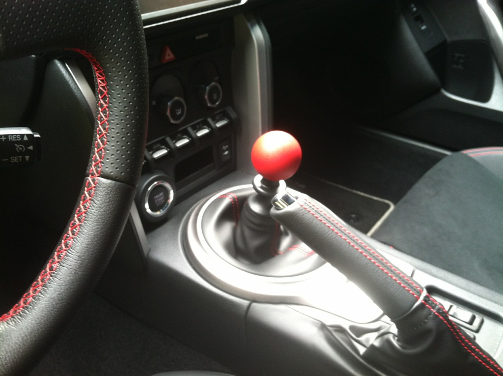

Originally Posted by Lee358 View Post
Attachment 11602
Here are two pics from the drivers door one showing the stitching in the steering wheel
I can't help but think about a clown nose...
