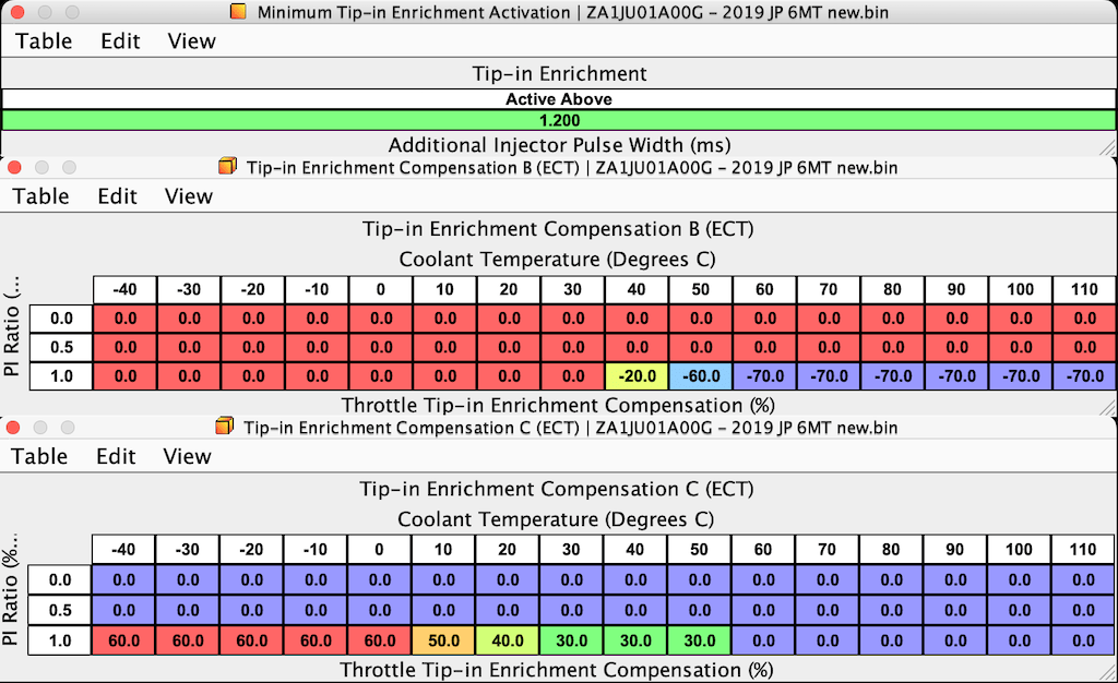

U01A (20JP) tweaks to tip-in enrichment tables
Originally Posted by steve99 View Post
OFT Tune Tweeks and Information
Tweak to smooth low down Throttle response - alter the tip-in enrichment tables
The standard tip-in does not activate till 1.5% throttle delta AND the minium tip-in pulse width of 2.4ms is exceeded this means no tip-in till aprox 8% throttle delta. Changing the minimum pulse width activation to 1.5ms and a tweak to the enrichment tables will get the tip-in started at about 4% throttle delta. Smooths out low end throttle response and takeoff.
U01A (MY 20JP) uniquely among every version I've decoded reduces Minimum Tip-in Enrichment Activation to 1.2ms, beyond the 1.5ms recommended generally; so it seems that Subaru agrees with that change and takes it a step further. While they don't alter the enrichment tables as above, U01A does also add a unique alteration to Tip-in Enrichment Compensation B/C (ECT) that increases cold and decreases hot enrichment above 50% port injection, which seemed worth noting:
Tip-In Enrichment Compensation B, row 1.0 (100%): 40°C = -20%; 50° = -60; 60°–110° = -70.
Tip-In Enrichment Compensation C, row 1.0 (100%): -40°–0°C = 60%; 10° = 50; 20° = 40; 30-50° = 30.
callisto is offline   Reply With Quote
The A01G definition has no Port Injection Ratio index in those tables, then those Tip-in Enrichment Compensation B/C (ECT) can't be ported, or can we?
Not without modifying the underlying code, no. That change was post-K00G (MY17-20) and isn't as simple as table hacking.
If you have the tools to unbrick your ECU — it involves both soldering and having an image of the first 8kb for pre-facelift, which I do supposedly have — or don't mind a 10-20%, in my personal experience to date, chance of your ECU being bricked because of an oversight or error on my part, then it's actually pretty easy to customize into an ECU. But it's only simple in theory, as in practice it costs 0-2 ECUs to get right, and while I'm pretty great at getting these right the first time, I'm not perfect at doing so.

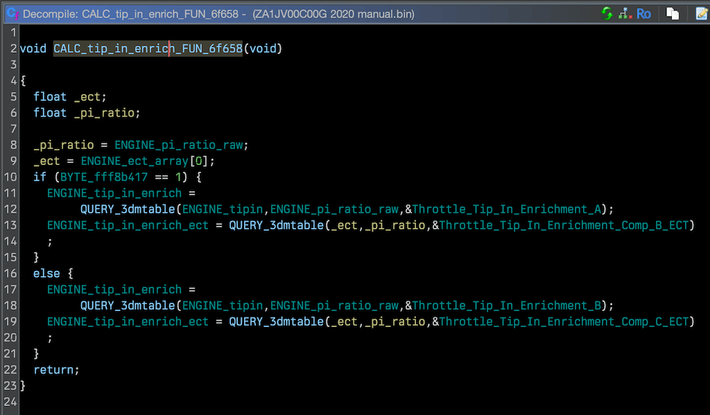

In what circumstances that tables B and C are referenced?
