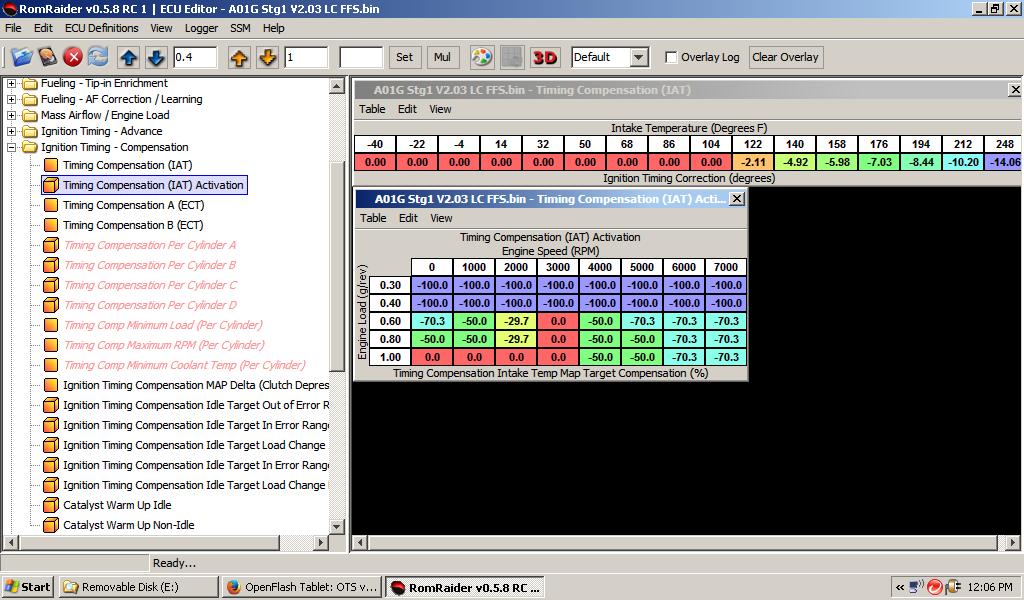

High Ambient temperature Related Knock
Adjust IAT (intake air temp) ignition timing retard table to cut in a bit earlier and make activation table more aggressive.
Note -100% in the activation table means no retard applied and 0% means full retard applied as per the IAT vs Ignition timing table.
http://www.ft86club.com/forums/image.../wol_error.gifThis image has been resized. Click this bar to view the full image. The original image is sized 1024x600.This image has been resized. Click this bar to view the full image. The original image is sized 1024x600.http://www.ft86club.com/forums/image.../wol_error.gifThis image has been resized. Click this bar to view the full image. The original image is sized 1024x600.http://www.ft86club.com/forums/attac...1&d=1408588907

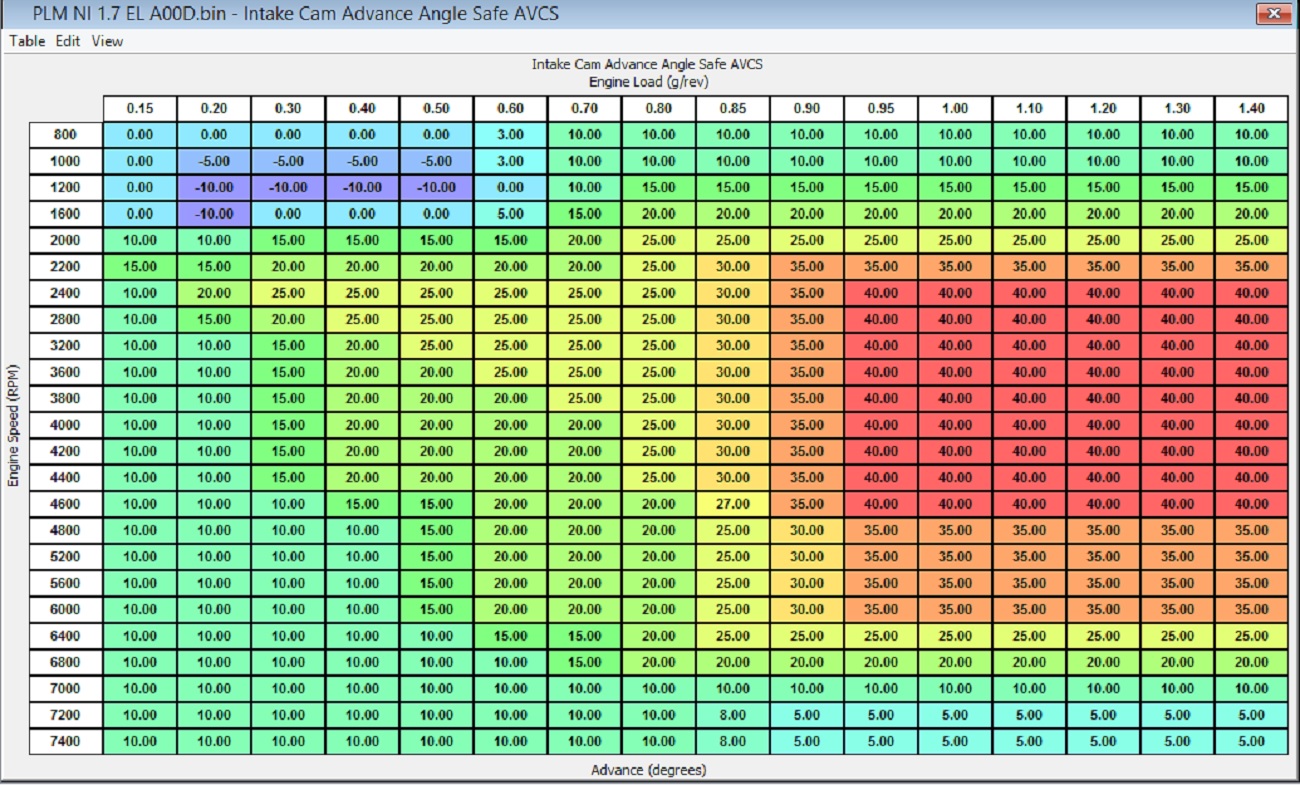

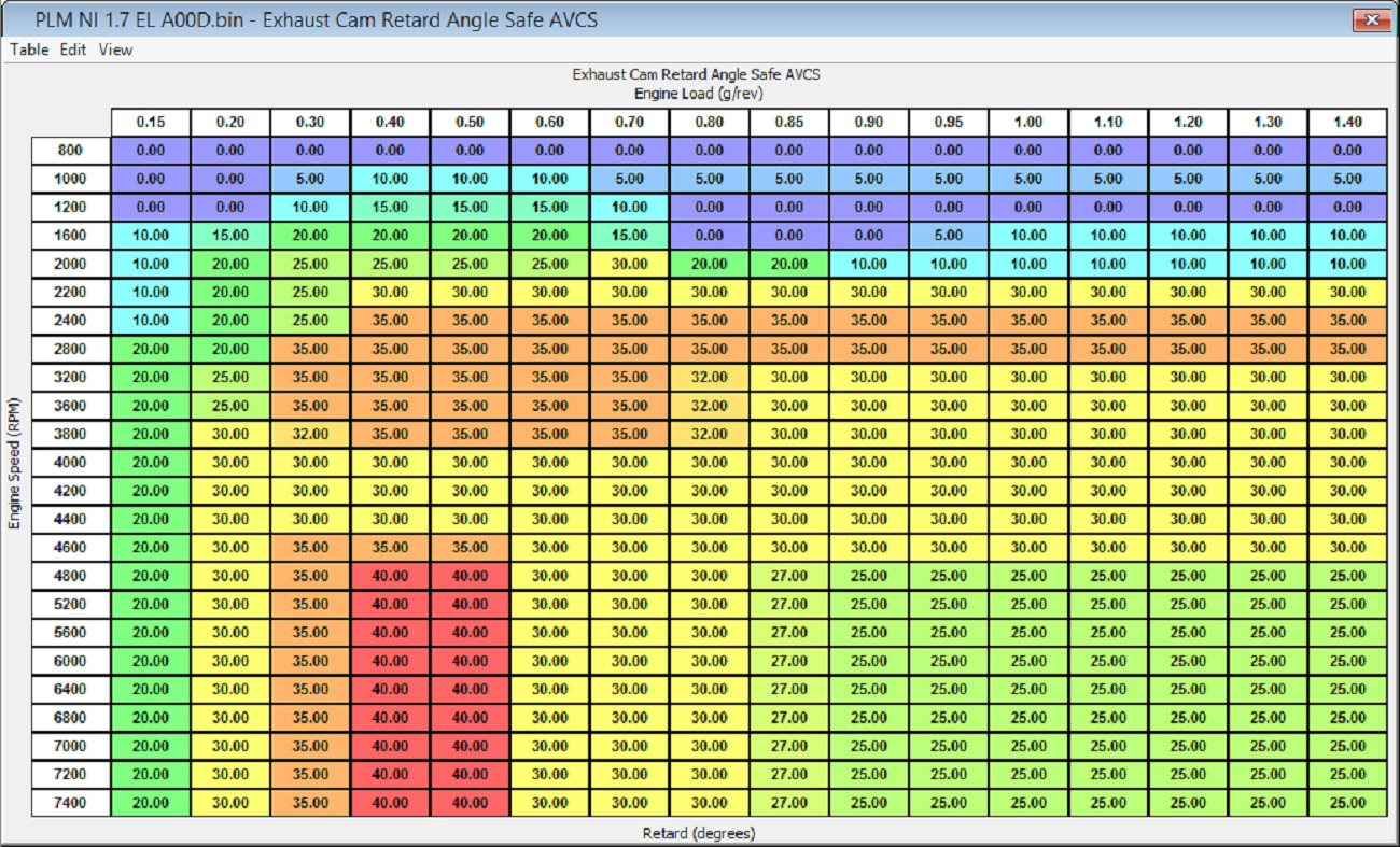

Intake and Exhaust VVT CAM tables for NAMELESS or PLM long tube catless headers.
Safe and Normal Tables are same , These will get you in the ballpark but other adjustments may be required to extract max benefit like fueling and ignition timinghttp://www.ft86club.com/forums/attac...1&d=1435215072

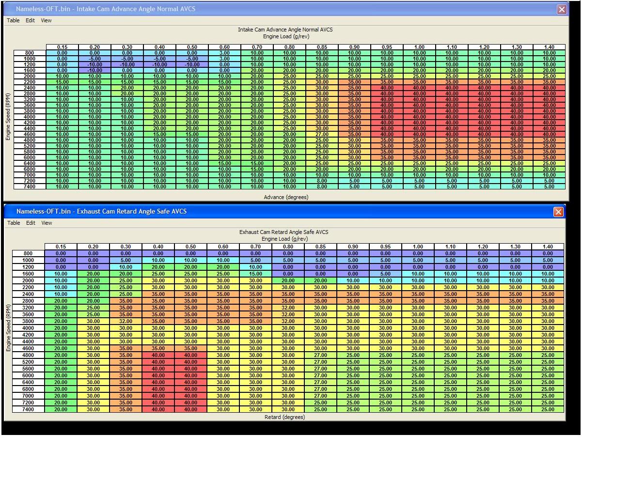

Intake and Exhaust VVT CAM tables for NAMELESS or PLM long tube catless headers (Version 2)
Here is modified cam table set for Nameless/PLM headers if you notice a hesitation in the 3000-4000 rpm area modified by @KoolBRZ
http://www.ft86club.com/forums/attac...1&d=1435555073

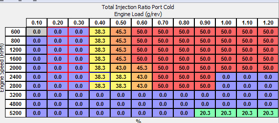

Possible Idle dip and hesitation fix (note try scaling maf first)
@ztan came up with possible fix to idle dips and hesitation off idle
http://www.ft86club.com/forums/showp...6&postcount=21
set all 3 PI/DI ratio tables to have full DI up to 0.3 g/rev load (see figure)
If you have stock injectors probably just up to 0.2g/rev will do.
http://www.ft86club.com/forums/attac...1&d=1422886610

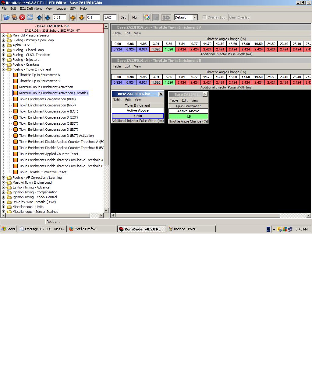

Tweak to smooth low down Throttle response - alter the tip-in enrichment tables
The standard tip-in doe not activate till 1.5% throttle delta AND the minium tip-in pulse width of 2.4ms is exceeded this means no tip-in till aprox 8% throttle delta. Changing the minium pulse width activation to 1.5ms and a tweak to the enrichment tables will get the tip-in started at about 4% throttle delta. Smooths out low end throttle response and takeoff.
http://www.ft86club.com/forums/attac...1&d=1446162185

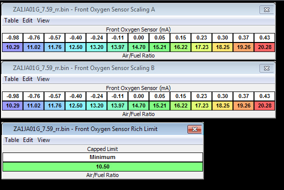

Rescaling the Stock Front 02 (oxygen) sensor to read richer for boosted cars
@ztan has used an aftermarket wideband sensor to recalibrate the stock (standard) front 02 sensor readings
see full post here http://www.ft86club.com/forums/showthread.php?t=82875
http://www.ft86club.com/forums/attac...1&d=1424688932

Added JDL UEL catless header VVT intake/exhaust cam timing to first post
