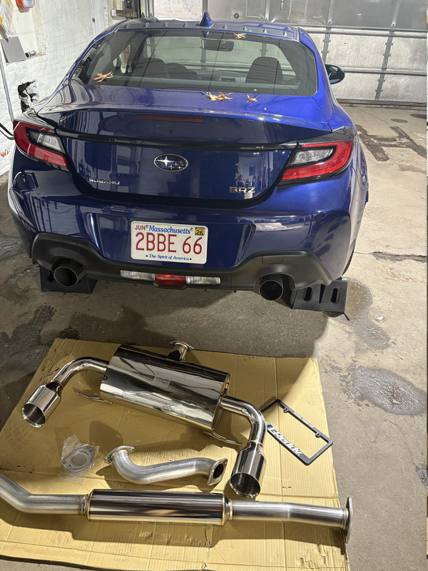

This weekend exhaust
I might aim for a quick dyno before if I have time with holidays and all.

7=Exhaust came in legal max was just a tiny bit to tame. Going to try this greddy. Sleeper goals!! I am waiting for an open lift. I couldn't squeeze under it. I assumed the ramps were enough. She LOW!! Stopping by a marine hardware store for stainless bolts (New England Rust). Gaskets were undersized for the pipe diameter. I will stop by the speed shop or open them up a little. I wonder if they have a remflex. These look cheapo.

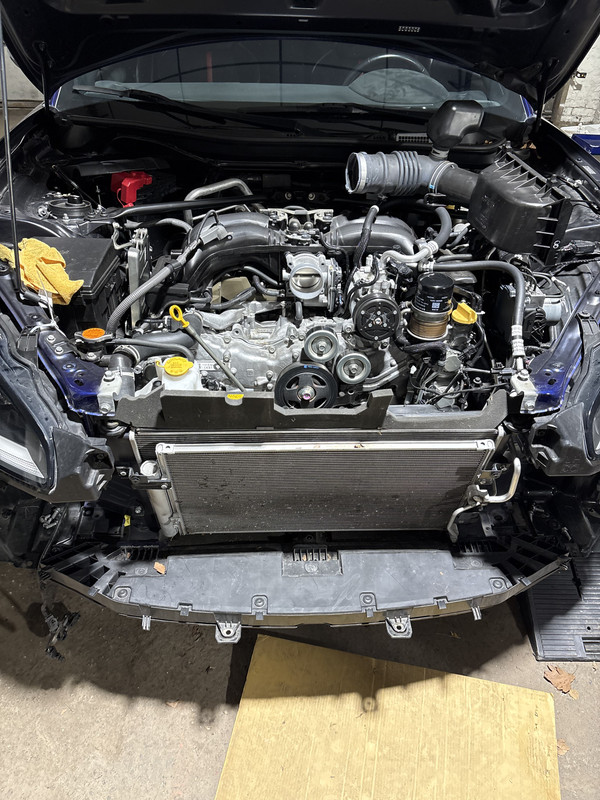

Build day one Tear down
No wonder why these cars have online install guides. A lot of the descriptions need translation. I can't stand watching you tube and everything is a electronic ratchet. This car was a breeze to work on.
Greddy pulley set on order. This kit has zero bling to it. Need something to add to it.
