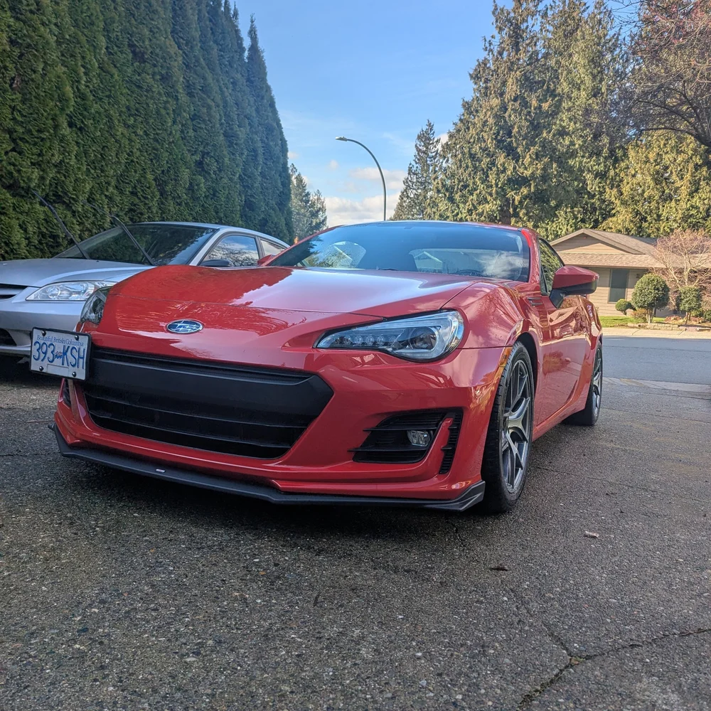

My next project today was to try the MAC Lifter Kit for fixing the bumper sag / gap / alignment issues. For context, I broke one of the loops (the one nearest the headlight) on the bumper side of the driver's side after hitting a driveway ramp a little too quick and smacking the bottom of the bumper on it.
Replacing the clips didn't help, and the regular metal repair plates from Etsy improved things a bit, but it still didn't fit quite right. Then I stumbled upon the MAC Lifter Kit.
The parts arrived from Australia just in time for this weekend, so I thought I'd give them a go. Since I already had the other repair plate installed on the bumper, I decided to just stick with that and only use the body side bracket from the MAC Lifter Kit.
While looking up the instructions for installing the kit, I came across this video, where the guy pretty much fixed the bumper gap by using a bolt and nut in place of the push pin at the top of the side marker bracket. I wish I'd seen this video before spending hundreds of dollars having two different repair kits shipped from Australia! Anyway - here's a link to the video:
So before installing the MAC Lifter Kit, I decided to just give this a try to see how it did. I removed the stock bumper bracket before doing this, and with just the bolt holding things in place, it actually looked OK:
That said, while the vertical gap was nice and tight, the bumper cover still didn't quite align flush with the fender. So, on to the MAC Lifter Kit!
The product page said that trimming of the headlight bracket would be needed for install, which I wasn't really keen on doing. Besides which, with the repair plate in place, that front loop was seating properly below the headlight / above the headlight bracket. Instead, I decided to cut the MAC Lifter Kit bracket short so that it would fit without cutting the headlight bracket:
That allowed it to fit just behind the headlight bracket when installed. I lined it up so that the smooth top edge of the lifter bracket was in line with the top of the headlight bracket, and maintained a consistent gap along the length of the bracket:
That got the bumper cover nice and flush with the fender line. I then installed the serrated flange bolt and nut (one of the stainless-steel M6x1.0 x 16mm sets that came with the MAC Lifter Kit - since I'm only installing the driver's side right now, I used one of the leftover sets) in place of the push pin at the top of the marker light bracket to secure things even more for a little extra insurance, and the fitment is PERFECT!!!
Since I had the side marker light out, I decided to finally get around to upgrading the side marker bulbs to LED's as well (they were the only bulbs not already switched over).
I'm going to keep the other MAC Lifter Kit pieces and previous repair plate for the passenger side for when I eventually need to fix that as well (right now it looks fine).
While my install wasn't typical / as recommended by the instructions, I'm happy to not have had to cut the headlight bracket for fitment. If you're looking to fix your bumper sag, gap or misalignment, I'd highly recommend the MAC Lifter Kit AND the trick of replacing the push pin at the top of the side marker light bracket with a bolt and nut.
Overall, I'd say this was a big win!

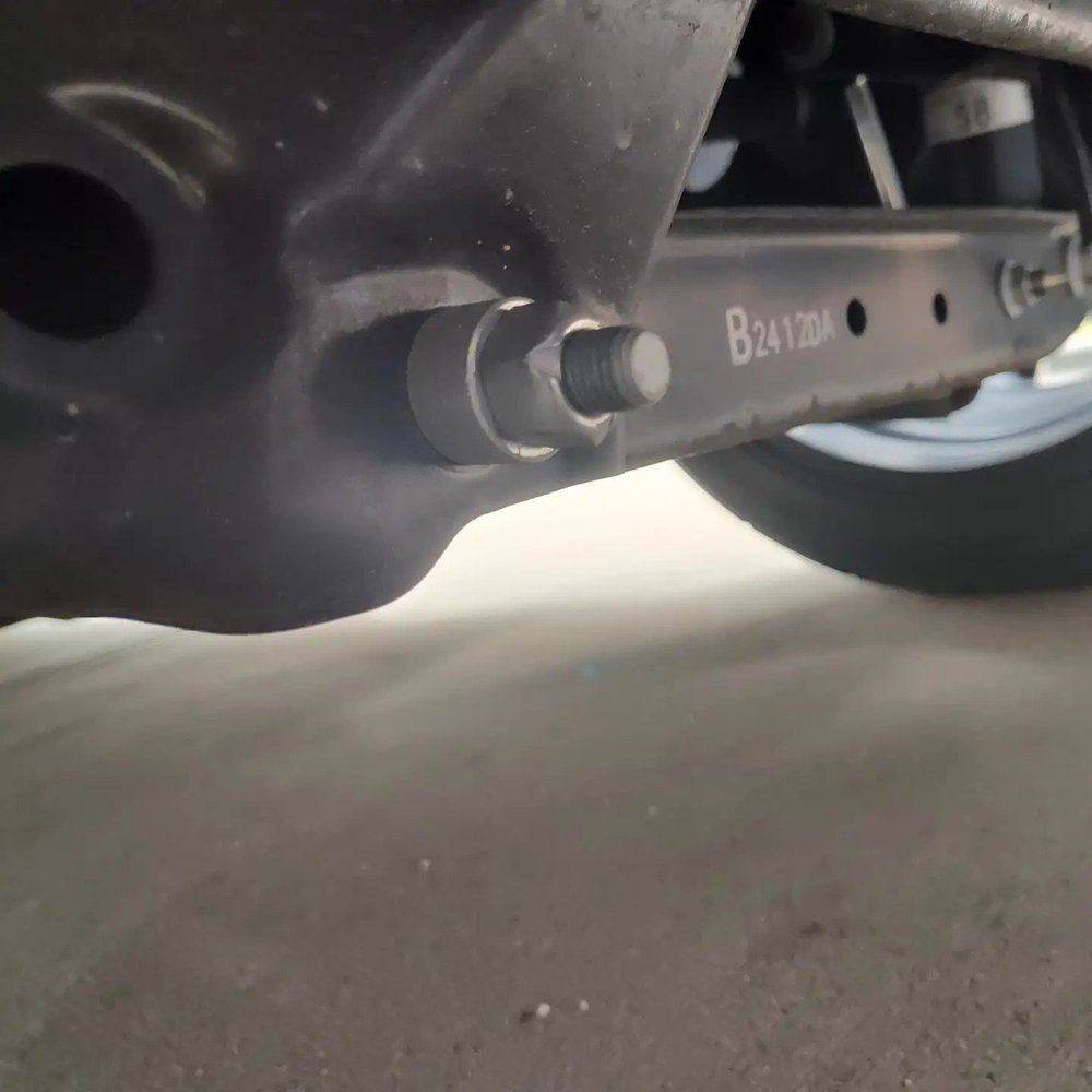

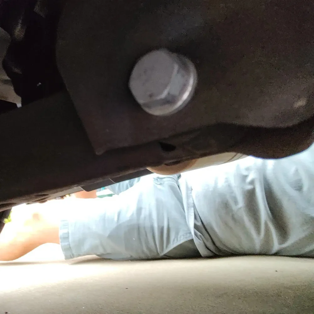

OK - got these installed this morning, because I wasn't willing to wait until late January (which would have been my next opportunity)...LOL.
Install was very easy.
  1. I landmarked the distance between the stock trailing arm pickup point and the connection to the knuckle so I had a point of reference for setting the length of the adjustable trailing arms once installed. Measurement in my case was just shy of 30 cm.
  2. Undid the 10mm rear bolt and two outside clips holding the underbody panel in place so the panel could drop down for access
  3. Unbolted the stock trailing arm from the MCA Traction Mod bracket and from the knuckle. These were 17 mm bolts / nuts both ends.
  4. Removed the MCA Traction Mod bracket by unbolting the 19 mm subframe bolt and the 19 mm nut and bolt holding the bracket to the original pickup point
  5. Removed the stock subframe to chassis bracket / brace - there was a 12 mm bolt holding the brake line bracket to the brace and two 14 mm bolts at the front edge bolting the bracket to the chassis
  6. Installed the Just Engineering bracket, making sure the brake line bracket was aligned above it. Hand-threaded the 19 mm subframe bolt first to make sure it was not cross-threaded, then tightened it up about halfway. Did the same with the 12 mm brake line bracket bolt and two 14 mm bolts at the front edge, then secured the upper mounting point of the bracket to the stock trailing arm pickup point using the stock 17 mm nut and bolt.
  7. Snugged things down by hand, then torqued the 19 mm subframe bolt to 107 ft-lb, the two 14 mm bolts at the front edge to 52 ft-lb, and the 17 mm upper mounting bolt and nut to 81 ft-lbs. (as per stock torque specs I could find). The brake line bracket bolt, I just left snugged up by hand.
  8. Took me a while playing around with the adjustment on the new trailing arm to get the overall length correct to match up to the original measurement from the stock pickup point to the knuckle. Weirdly (or maybe not?) the correct length centre to centre on the new trailing arm ended up being right around 30 cm too. That was pretty near as long as I was comfortable setting the adjustment, because that left only about 15 mm threaded in at either end (of 50 mm total length into the arm and 40 mm total length at the rod end into the adjuster body). The adjuster body required a 7/8" wrench and the locknuts were 15/16". Once I figured out the length, I set the other trailing arm exactly the same in preparation for doing the other side, and set it aside.
  9. After much back and forth with adjustments, connected the rod end to the new forward pickup point using the supplied hardware (bolt and nut were 19 mm), and the end of the trailing arm to the knuckle using the stock 17 mm nut and bolt. Snugged everything up hand tight.
  10. Loaded the suspension to about normal ride height by raising the trailing arm with a jack, then torqued the 19 mm forward bolt and nut and 17 mm bolt and nut at the knuckle to 81 ft-lb. Then I tightened the locknuts on the trailing arm adjuster as tight as I could, making sure that the rod end was properly aligned vertically in the bracket.
  11. Reinstalled the underbody panel with the rear nut and the forward clip. The new bracket doesn't have a hole for the more rearward clip to attach, but the panel sits OK without it, so I didn't bother doing anything about it.
  12. Gave the adjuster mechanism, the rod end and the fasteners either end of the trailing arm a light coat of Honey Goo for some weather protection.
  13. With all the measuring, adjusting, re-adjusting, etc., being very careful and deliberate about things, looking up torque specs and taking pictures, the first (passenger) side took just under 2 hours.
  14. Repeated the whole procedure on the second (driver) side in about 25 minutes...LOL.

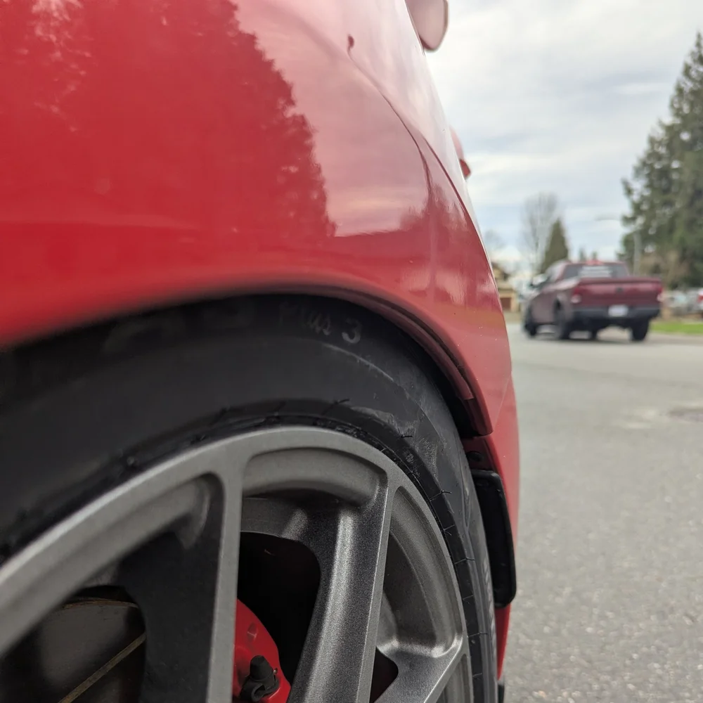

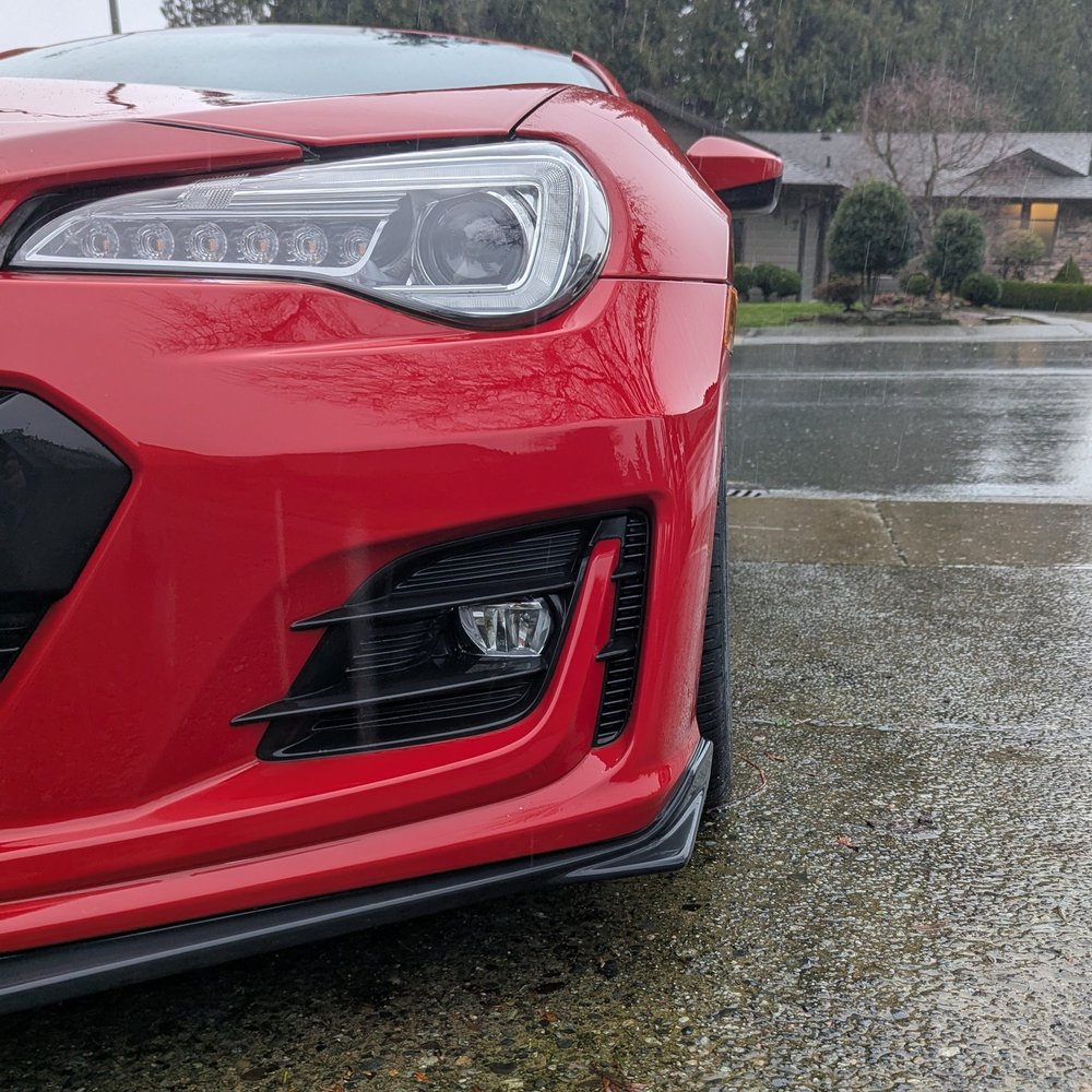

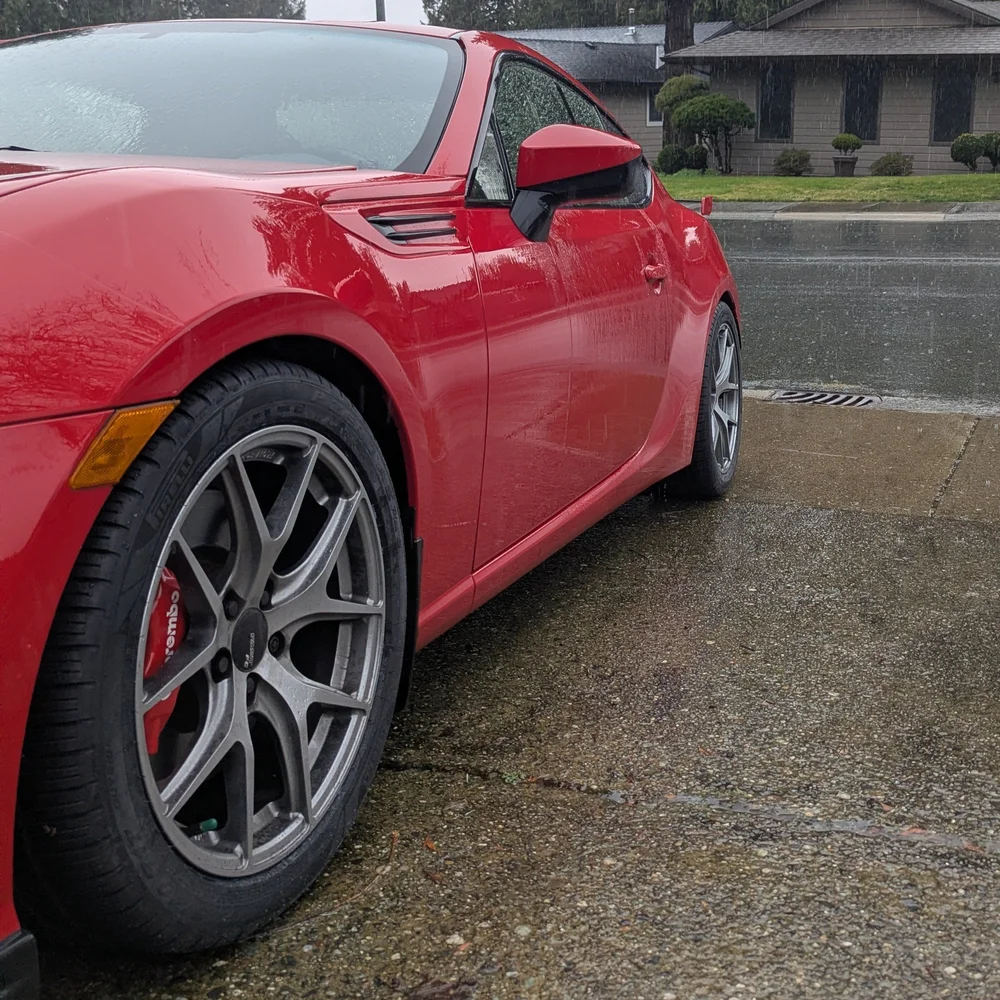

Despite my best intentions, I couldn't wait to put the new Pirelli P-Zero AS Plus 3 245/40R17 rubber (mounted on my 17x8" ET35 Fast Wheels FC04's) onto the car.
Of course, now that I've taken my snows off, we will inevitably have a freak snowstorm in the next couple of months...LOL. In the meantime, here are some pics:
So CHUNKY
VERY flush at the rear fender. I haven't pushed it hard yet, but I'm hoping with the rear suspension's camber gain under compression, it shouldn't rub:
Definitely protrudes beyond the lower bumper line, both front and rear, but no visible poke from above:
Not 100% sure yet (because I've only gotten out and driven it three times since putting them on), but the only time I think I have rubbed at all is when pulling into my driveway at an angle. I'll need to investigate this further...
With the monsoon rains we've had around here the past couple of days, all I can say about the new tires is the wet traction off the line is very good, and the hydroplaning resistance is great! LOL

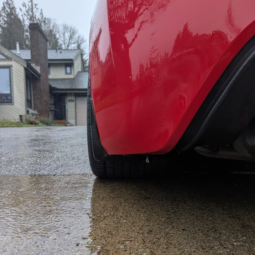

Dang...rear is rubbing...
OK - well, I've figured out where the rub is happening when I'm entering the driveway, and it's at the rear outer shoulder on the (heavily loaded) outside rear wheel ...
Not sure what to do here, because the camber gain under compression isn't enough (clearly). I guess adjustable rear lower control arms are the only real option here that isn't crazy expensive...?
EDIT #1: I guess another rear camber option (according to some posts I've found) is either the H&R TC112 'Triple C' Camber Adjustment Bolt or MOOG K90473 Alignment Camber Kit at the inner control arm pickup point.
There are some pics from a post on another forum (albeit on a 2nd gen, but I'm hoping they're the same fitment) that show them installed (I downloaded the pics and re-shared them so I could link them here):
It's an "off-label" use for the Moog bolts (they're front camber bolts for a Chevy Equinox; the H&R's are listed as a universal application - I mean...they're just 12mm camber bolts...) and you don't gain a whole lot of negative camber with the bolts, but it *might* be just enough to gain the few mm of clearance I need at the top.
The Moog bolts are about $35 USD for a pair, the H&R bolts are about $80 USD for a pair but look just a *bit* more substantial, and I can get Dorman adjustable RLCA's from Rock Auto for about $103 USD (or Moog for $192 USD)...
I guess I could also try some adjustment to the static rear ride height to see if that changes the camber enough to make a difference. Lower = more negative camber, but I don't really want to go a whole lot lower, and I don't think it will track any differently than simply compressing the suspension (at least with how I'm visualizing it)...
EDIT #2: OK - it only happens at the extreme angle I have to use when approaching my driveway from the one side (the right of my driveway). From the other side (the left of my driveway), it's OK. It's a bit of a pain coming in from that side, because I then have to jockey my car back and forth to line it up along the right side where I need to park my car, but it's a temporary, no cost solution anyway.
EDIT #3: After seeing DocWalt's endorsement of using the Moog camber bolts in the rear with his hard usage, I'm going to go that way first and see if that does the trick. I've ordered them from RockAuto for $50 CAD / $37 USD shipped.

I did experience a rub a couple of times on some harder compressions on the road, so this is not just a driveway issue. The rub is VERY slight, but that's kinda like being almost pregnant...LOL. A rub is a rub, and I want ZERO rubbing if I'm going to be taking my car back to the track someday.
The camber bolts arrived yesterday, so I put them in today. They made a VERY small difference, but not enough to resolve the issue. By my before and after measurements, I was able to move the upper shoulder of the tire in by about 1 mm with the bolts maxed out, so virtually no difference (though it was a consistent difference on both sides, so I'm confident it wasn't just a measurement error).
I also raised the rear ride height on my RCE SS1's to the maximum spec (I was only 5 mm away from that already), and that improved my driveway approach issue *slightly* but it still rubs. Hopefully that will be enough to prevent any on-the-road compressions from rubbing, but we'll see.
EDIT: I don't think I want to use adjustable lower control arms to kick the bottom out even more for pretty minimal clearance gains up top, so I guess the options I have left are a) adjustable upper control arms, or b) higher offset wheels. Neither are inexpensive options, though.
For wheels, I'm looking at around $1,800 CAD minimum for the options I'd consider, up to nearly $4,000 CAD.
For rear upper control arms, my top pick would be the GK Tech arms, which are $829 USD (around $1,150 CAD). They just look the most solid, and I like their adjustment mechanism best.
So...I just have to live with things for now, and save up some money before making a decision.

GREAT wet traction and grip from Pirelli P Zero AS Plus 3!
After pushing the car a little harder on the cold, wet roads around here the last couple of days, I have to say the wet traction and grip of my new Pirelli P Zero AS Plus 3 245/40R17 rubber is really, REALLY good!
Very confidence-inspiring compared to my previous (admittedly aged out at 6 years since production) 225/45R17 P Zero All Season Plus tires. A bit surprising, actually, because I never found the previous tire particularly great on traction even when it was nearly brand new. Part of that could have been me getting used to driving a RWD car after years of driving only FWD or AWD, but still - what an improvement!
