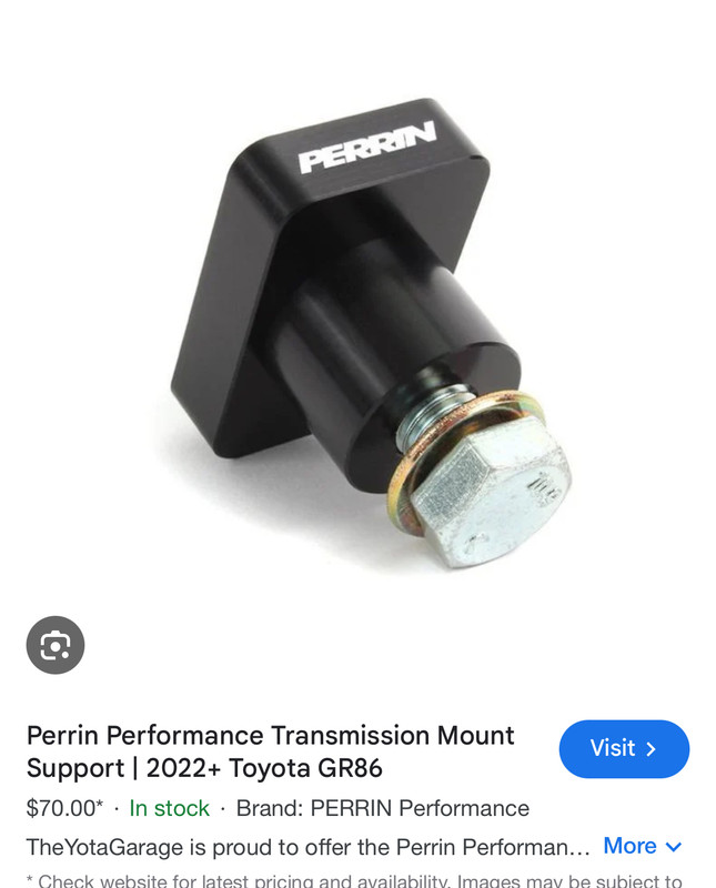

Perrin engine mounts coupled with their trans support mount. I had to take the trans mount off eventually as it was too loud for daily use, but the on-ramps were hilariously fun, it sounded like the car had ITBs. Just a very loud, serrated-edge KEERRRRRRRR that builds all the way to the redline, very intoxicating.

Originally Posted by ruturaj001 View Post
I have bought Whiteline Positive Shift Kit Bushing, I wonder if it will be enough after a change.
It won't increase sound but improve shifting feel. This is what you need if you want more sound:
