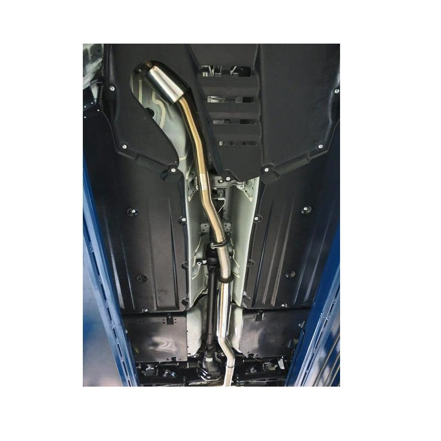

Subaru part numbers for the underbody panels are listed below.
Under Cover Center Right: 56411CA001
Under Cover Center Left: 56411CA011
Under Fuel Tank Protector Right: 42045CA030
Under Fuel Tank Protector Left: 42045CA020
Bolts Require for Installation:
Bolt: 901000344 x 5
M8 Nut: 902170046 x 5
Fender Liner Clips: 909140007 x 5
Cargo Liner Clips: 909140065 x 20
Not sure if you need the very front panel towards the front pipe which is the,
Under Cover COM FTM:56410CA001
ZC6_STi is offline   Reply With Quote

I've been looking at this myself lately, and noticed something with this list. There are new revisions of all four panels, which are 2nd gen parts, but have superceded the original parts listed above and are listed for 1st gen too. The newer tank panels are CA021/031 instead of 020/030, and as far as I can tell are a direct substitute (don't know what changed) so it's not a big deal.
The front panels on the other hand have changed in design. There's now an additional part that clips on at the very front (norcalpb called it a 'puck').
from https://www.ft86club.com/forums/show...41&postcount=1
Both pieces are listed as superceding the original panel, but if you just look for the old part number, you get only the panel (as given in the above list) and not the puck. There were Interchangeability & Substitution Bulletins covering this.
Under Cover Center Front Left: 56411CA040
Under Cover Center Front Left: 56411CA050
Fender Liner Clips: 909140007 x 4 (the same part number is also used for the tank covers)
The other thing I notice in the above list is the counts for fasteners seem to be more than what seems necessary. I don't know whether they deliberately include extras, or if I'm miscounting, but as best as I can tell, the counts should be:
Bolt: 901000344 x (6 -3)
M8 Nut: 902170046 x (4 -1)
Fender Liner Clips: 909140007 x (4+4 -2)
Cargo Liner Clips: 909140065 x (16 - 3)
The -x at the ends are counts of what is already present on cars without these panels and you may be able to re-use. This is also omitting the bolts that also hold the front panel in place.
Anybody wanting to browse the parts catalogs themselves, the front panels are under the Body section and are easily found. The rear panels are listed under Engine and Cooling, in the Fuel Tank, Band and Cover section.
Almost looks like it's supposed to be a jacking point. I don't suppose you know if it's solid or hollow?
CrowsFeast is offline   Reply With Quote
Old 12-21-2024, 01:47 PM   #24
ZC6_STi
ZC6_STi's Avatar
Join Date: Oct 2014
Drives: 2015 Subaru BRZ Series.Blue #709
Location: Los Angeles, CA
Posts: 84
Thanks: 45
Thanked 59 Times in 34 Posts
It's hollow. It can't be a jacking point due to the curve design to help aeroflow for the underbody panels
