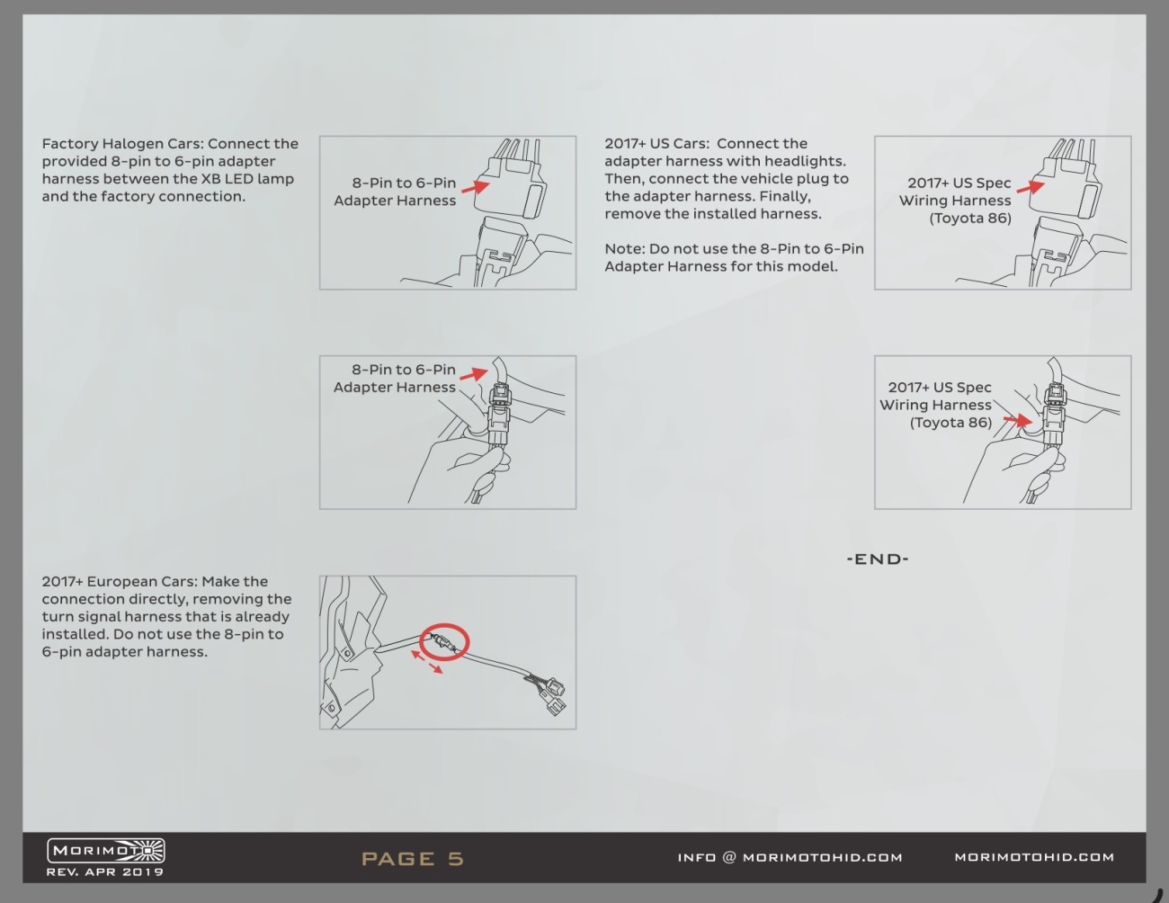

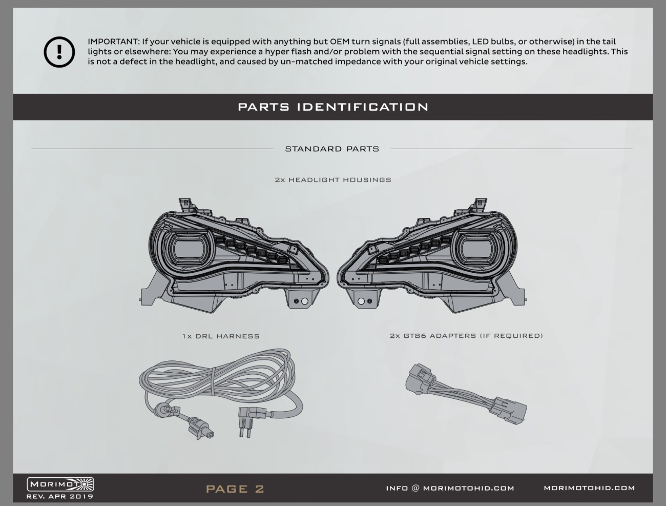

Can anyone tell if Morimoto 1st Gen (LF470) comes with the 8pin to 6pin adapter so I can use it for my 2013 FR-S? I bought a set from a private sale and do not see the adapter in the box.
Update: I called Morimoto and the harness does not come with the box. So not so plug and play.
Then the other issue is they don't have the harnesses in stock anymore to support the headlamps and turn signal, and they do not plan on getting anymore.
So I'm SOL with them.
FYI for others trying to buy these 1st Gen lamps for their 12-16 year car
That's interesting. My Morimotos came with the 6-8 pin adapters. If I can find them, I'll give them to you for the cost of shipping.
Yeah that is interesting what they told me doesn't alight with you.
I wonder if things changed down the road and they didn't ship the adapter anymore, but that doesn't really make sense.
Do you remember if the adapter came in each of the boxes that contained the headlamp? In my package I have one large box with two smaller boxes inside.
The two relatively smaller boxes each contained the headlamp. When the two smaller boxes are in the larger box there is no extra room to fit anything such as adapters.
Well before reading you kind reply and offer, I did purchase these and they have shipped:
https://modssociety.co/collections/t...z-frs-gt86-frs
If they don't work, maybe I'll check in with you. Either way I'll provide an update here for everyone incase it helps.
Thanks @pope!
frs23 is offline   Reply With Quote
Thanks @pope!
It's probably a good thing you ordered adapters rather than waiting on me. I stumble upon the 6-8 pin adapters every few months, but now that I wanted to find them, fuck if I can figure out where I put them.
All I remember about the way the lights shipped was a giant box containing smaller boxes for each light and extensive expanding foam packaging. I think the adapters were in a bag with instructions tucked somewhere in the giant box, but it's been some years, so that's more of a guess.
I also bought my lights from The Retrofit Source, but I'm rather sure they and Morimito are the same company (website designs are essentially identical). Not that it makes much of a difference, both Morimoto and The Retrofit Source both say on their websites the adapters are included with the lights. The installation instructions at both sites say the adapters are included too.
I realize you bought your lights private sale, so maybe the original purchaser lost them, but, if they're telling you the lights don't come with the adapters anymore, they need to update their websites and instructions.

Maybe it is too early for me, but I am not getting the instructions on the 2017+ cars.
"Connect the adapter harness with the headlights, then connect the vehicle plug to the adapter harness. Finally remove the installed harness. Note: Do not use the 8-6 adapter harness"
Install the harness, remove the harness, and do not use the harness.
Am I reading that correct?

I never stopped to actually read the 17+ instructions, but you do seem to be reading it correctly. Maybe they were drunk when they wrote it.
