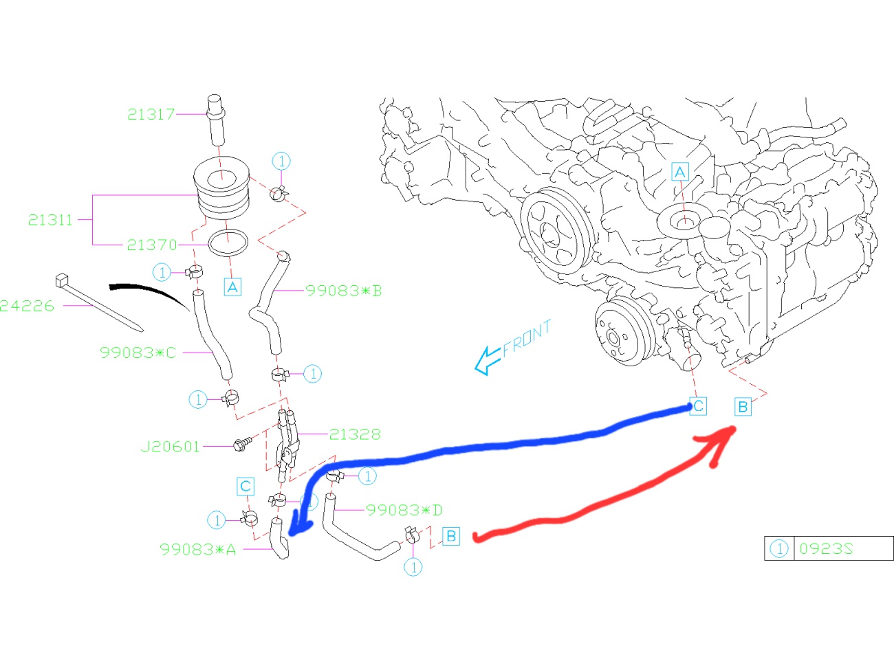

Please refer my post at https://www.ft86club.com/forums/show...4&postcount=11.
And 2nd gen. has dedicated inlet and outlet for its oil cooler.
The outlet of the oil cooler could be Tee'd to the water pump inlet hose. But the inlet of the oil cooler should be routed somewhere. In my installation I routed from the electric water pump outlet.

2nd gen has two ports that aren't present on 1st gen. One is easy to adapt; the coolant bypass pipe for second gen has an additional branch at the bottom for the oil cooler to feed coolant back in. (14050 in the figure; port B in makinen's figure)
I expect this pipe to fit perfectly on a 1st gen, either with the associated short rubber hose (616021) connecting it to the upper oil pan, or by trimming the 1st gen hose appropriately.
The other port (C on makinen's figure) is a little bit trickier. The 2nd gen upper oil pan has a pipe that exits the bottom face of the pan, then wanders around the base of the water neck. The 1st gen oil pan is completely blank where this pipe is attached. A short rubber elbow connects this pipe to the vertical pipe feeding the oil cooler.
Where this supply pipe comes out of the upper oil pan is very close to where coolant outlet is for the ATF cooler on AT cars. If you have an MT car, there's a plug (11021AA190) that could be replaced with the hose bung used on AT cars, which can be used to supply coolant for the oil cooler. The catch is that this bung is 11mm, which conveniently matches the Forester's oil cooler's coolant inlet side, but is doesn't match the 2nd gen BRZ's inlet.

OK - so looking up the exact part numbers for the "Engine Coolant Bypass Hose. Engine Coolant Flange. Engine Coolant Pipe (Inlet)" (14050 on the diagram), it looks like the current 1st gen part number is 14050AA871 (manual) or 14050AA881 (automatic), while the corresponding 2nd gen part number (with the extra fitting for the oil cooler hose) is 14050AB511 (manual) or 14050AB531 (automatic).
The drawings don't really help, since the close-up drawings only seem to show the automatic variants (with their extra pipes for the AT cooler), but it looks like the main pipe that is common to both variants is quite different on the 2nd gen, longer overall and having an elbow turning towards the vehicle centerline after where the port is for the oil cooler.
That appears to be accounted for with a difference in piping beyond that - the 1st gen has a long elbow (99078*A) where the 2nd gen has a straight section (H616021). Not sure whether the total length ends up the same or not.
Presuming it is, you'd need to swap in the following from 2nd gen to replace the 1st gen parts 14050AA871 or 881 and 99078*A:
  • 14050AB511 (manual) or 14050AB531 (automatic)
  • H616021 (either)
You can re-use the two hose clamps (F92209) from the original pipe.
Are we sure that the flow direction for the connection for the AT cooler would be correct (I.E. it wouldn't oppose the flow of the inlet pipe)? If so, then yes, that would be a perfect place to connect the other end of the oil cooler circuit. I'll dig into it some more when I have more time to research if nobody knows the answer off the top of their head.
EDIT: I suppose another answer might be to return the other end of the oil cooler circuit to a T mounted in the H616021 hose...? Or is there something I'm forgetting to consider here?

Yep, that mostly sums up that side of things. I would think you could just cut the 1st gen elbow to the appropriate length instead of getting the 2nd gen hose section. But I imagine the 2nd gen hose is cheap enough I would just get the new part.
Oh, also for the AT cars, the ATF cooler hose connection changed the other way - being straight on 1st gen, and now an elbow for 2nd gen. I'm thinking of getting that elbow for my MT car to supply the coolant; for an AT car this would be where you'd put in a tee to get your supply.

I'm certain it's the right direction. There's a figure in the 2022 New car information document that shows the coolant coming out of the pump going straight to the oil cooler and straight to the ATF warmer side-by-side on the schematic. My Acrobat reader is broken at the moment, otherwise I'd screenshot the figure. Coolant leaving the ATF warmer goes to a thermostat on the upper coolant pipe (the manifold on top of the block that sends coolant to the radiator and the cabin heater core).
Yes, that would be an appropriate alternative, the trick being in getting an appropriate tee as the H616021 hose is a larger diameter than the 9mm return hose from the oil cooler.
My Acrobat reader decided to wake up, and I found a more apropos figure.

OK - not sure if I'm misunderstanding that image or not, but it appears to indicate that the flow goes IN to the port (g) on the upper oil pan FROM the oil cooler, and coming OUT from the upper oil pan port (h) TO the ATF warmer.
So, that suggests logically that the flow from the port on the "Engine Coolant Bypass Hose" we had previously been discussing to the oil cooler is flowing TO the oil cooler. I think this is backed up by (f) being coolant coming "from bottom by-pass" (which I'm guessing is the port the bypass hose connects to) flowing IN to the upper oil pan.
Based on this, if I hooked up the other side of the oil cooler to the ATF warmer port, I think the two flows would be counteracting each other...?
Think of the water pump as sucking fluid in from g, and pumping it out port h.
Subaru's naming for things can be confusing, but I think anything other than the radiator (thermostat) that feeds coolant in to the water pump is referred to as a bypass. What I was referring to as the bypass line (14050) is the return line from the heater core; the parts catalog calls it a engine coolant bypass hose. It connects via the H616021 hose to port g, and it also accepts coolant from the oil cooler, to feed back into the water pump. Port f isn't relevant to us; it's internal and comes from the short block.
Coolant TO the oil cooler is by a different path not shown in the figure, but is equivalent to port h.
There's no counteracting; coolant from the water pump outlet goes out the ATF warmer port, through the oil cooler, and then back into the coolant bypass pipe back to the water pump inlet.

OK - so the additional port on the 14050 bypass hose (which connects to port (g)) is where the outlet from the oil cooler should be fed from, and then use port (h) as the inlet feed for the oil cooler (using the fitting for the ATF warmer).
Do we know if there is somewhere on the FA20 block to mount part #21328AA300 (which is two hoses / pipes on a metal bracket feeding up to / down from the oil cooler), or does that mounting point not exist? Here's the image of the oil cooler parts for reference:
Yep!
The FA20 timing cover already has the bosses to bolt on a coolant pipe (as used on the Forester XT) and I believe the bosses used for the FA24's coolant pipe are identical. While I didn't actually test putting a bolt into the bosses on my timing cover, I'm pretty sure they're already threaded. Worst case would be that you'd have to tap threads into them yourself, but I don't believe this to be the case.
The only detail I haven't yet nailed down is how to address the ATF port. That port is threaded on the FA24 upper oil pan, and is either plugged off with a blank for MT, or a pipe nipple is screwed in for AT cars. The FA20 MT upper oil pan has threads in that hole and a plug but I believe the threads for the MT plug to be smaller than the FA24 threads (the part numbers for the plug are different), so I don't think the FA24 pipe nipple fits an FA20 pan. The FA20 upper oil pan has the pipe nipple pressed in for AT cars and is considered to be a part of the oil pan rather than a separate part like it is for FA24.
I plan to order the FA20 plug ( 11021AA190 ) to identify what thread it is. I have a hunch it might be 1/4" BSP. Whatever it is, I'm crossing my fingers it's something we can find a 9mm hose barb for. If it is 1/4" BSP, this seems like the perfect part:

For the coolant flow direction, refer this.

Thanks! Yeah - I had looked at that, but it didn't show the port for the ATF warmer and its direction of flow.
