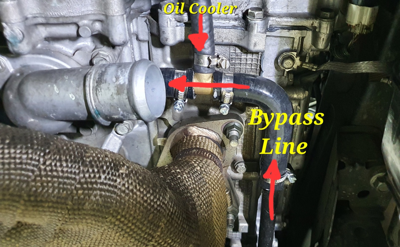

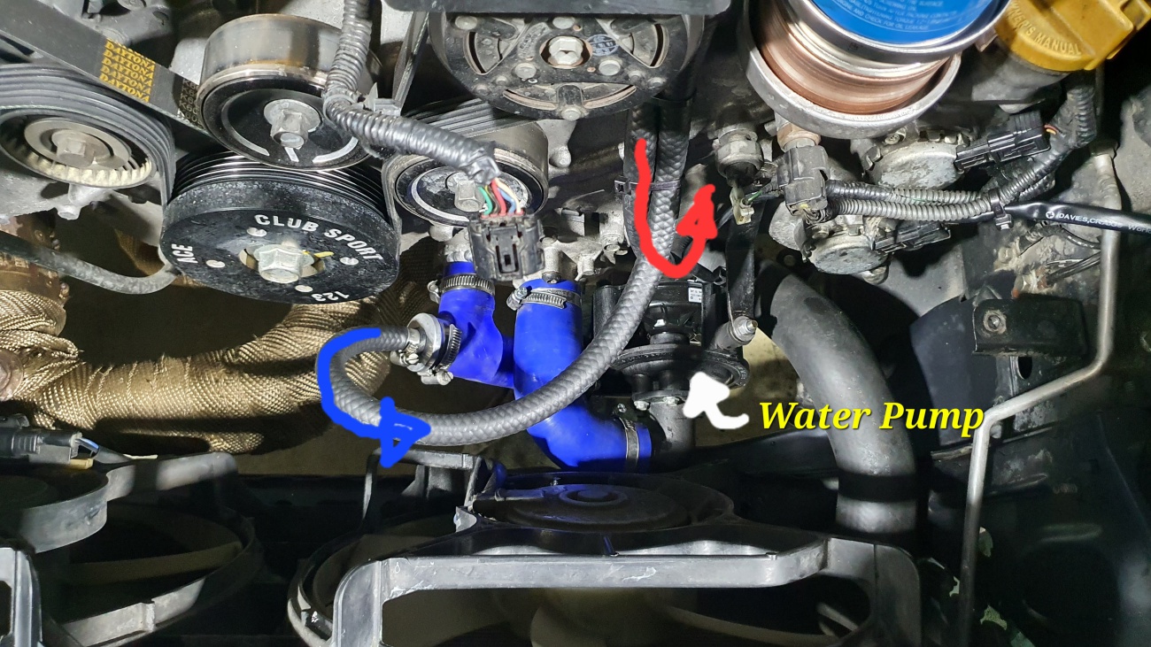

makinen 11-24-2023 04:55 AM
3 Attachment(s)
Please refer my post at https://www.ft86club.com/forums/show...4&postcount=11.
And 2nd gen. has dedicated inlet and outlet for its oil cooler.
Attachment 223185
The outlet of the oil cooler could be Tee'd to the water pump inlet hose. But the inlet of the oil cooler should be routed somewhere. In my installation I routed from the electric water pump outlet.
Attachment 223187
Attachment 223186

Tatsu333 11-24-2023 10:24 AM
Attachment 223185
That's great - exactly the information I needed, thanks so much! Given that info, I think I'll most likely end up just going with the throttle body method.
